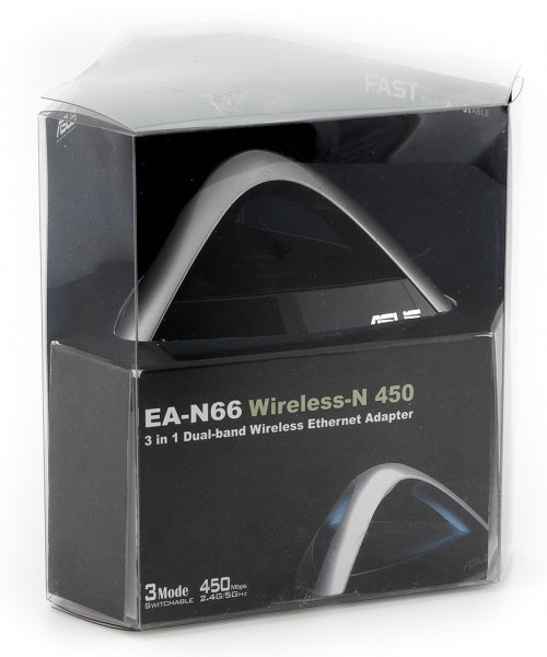

fb82877
ASUS EA-N66
https://www.ixbt.com/comm/asus-ea-n66/box.jpg

Thanks…Is it known to work with Haiku-OS? I already have burnt a hole in my pocket…so…
This also is unavailable… I am being checkmated from all corner wrt internet access on Haiku-OS…
