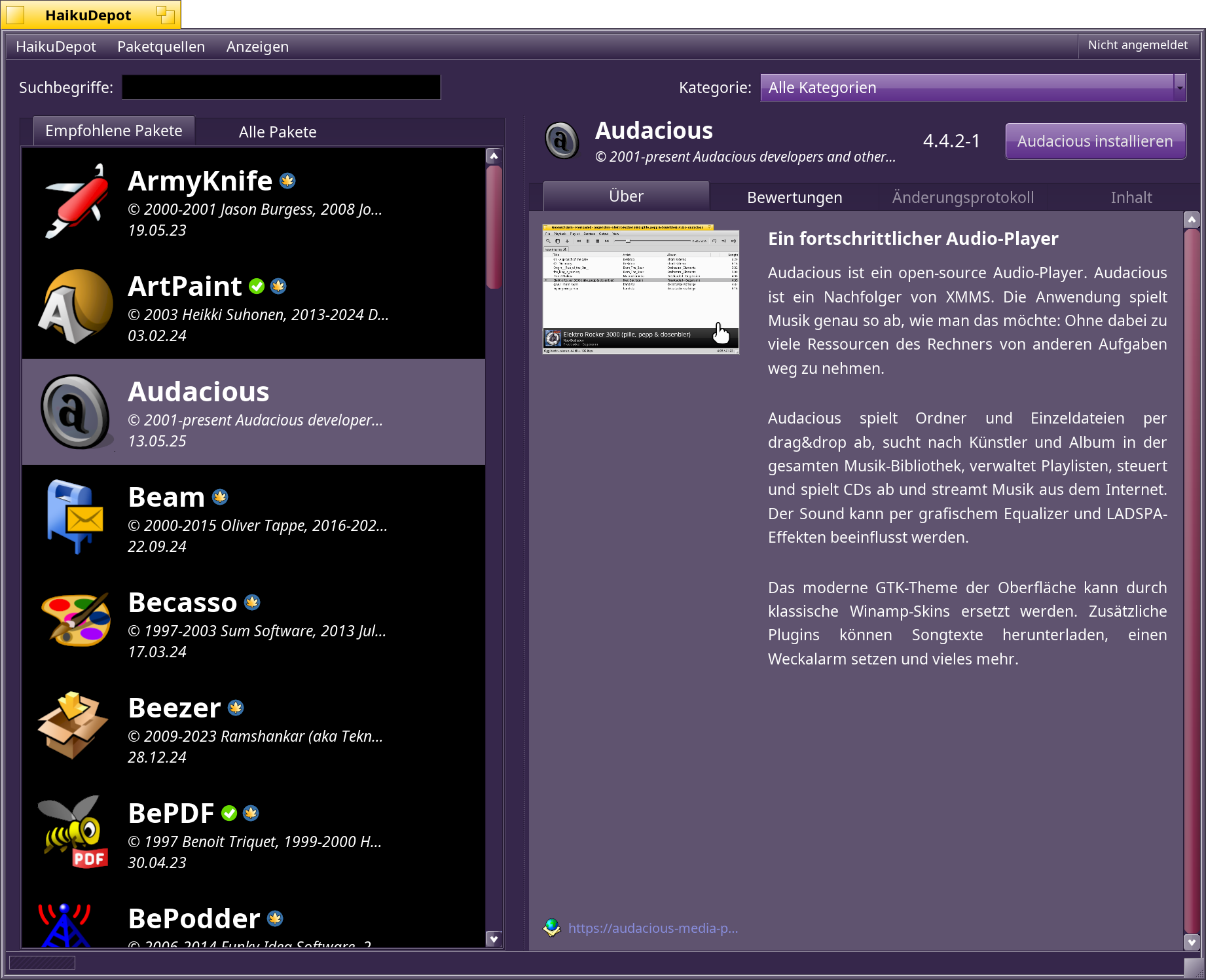

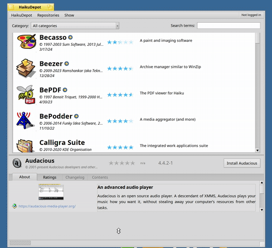

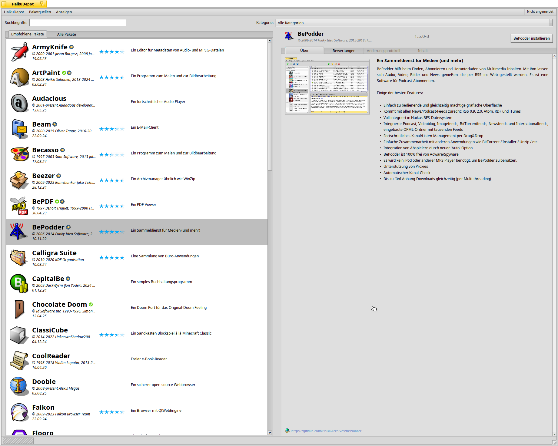

The All Packages list is already relatively compact, the one here is just about ~40% taller. We could move the search bar to the bottom below the package list to connect these.
The current HaikuDepot is somewhat cumbersome. To view all the app information, manually drag the divider and then return it to the list (back-and-forth). It’s an odd flow.
haikudepot_ux_navigation
I’ll leave the designs here. That’s all from my side for the time being
An easy solution for that would be to switch the Category popup and Search terms text field.
IMO the lists are compact enough with the 32px-icons-double-lines. If the list is so vast that you long for 16px-icons-single-line, I’d rather add terms to the search to prune the results…
A few comments, even if the designs aren’t further explored by @anon40228759 for now. Thanks for your work so far anyway, they surely are hearty food for thought!
  • On the right side, the icon+name+un/install/open button should be outside the tab view and thus always available.
  • On the left side, the icons should be extended with icons for “installed” and “native”.
    While a download is running a bar should show progress, similar to when updating with SoftwareUpdater.

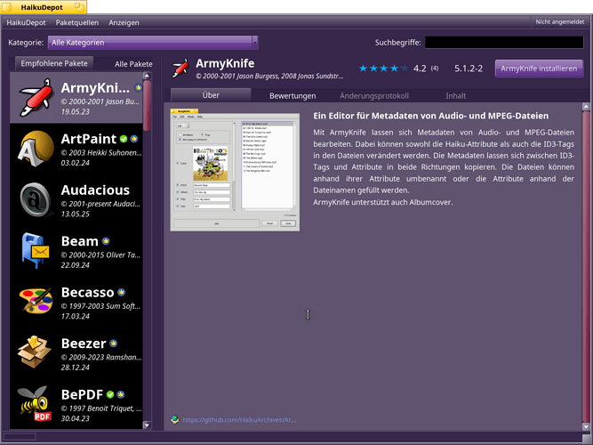

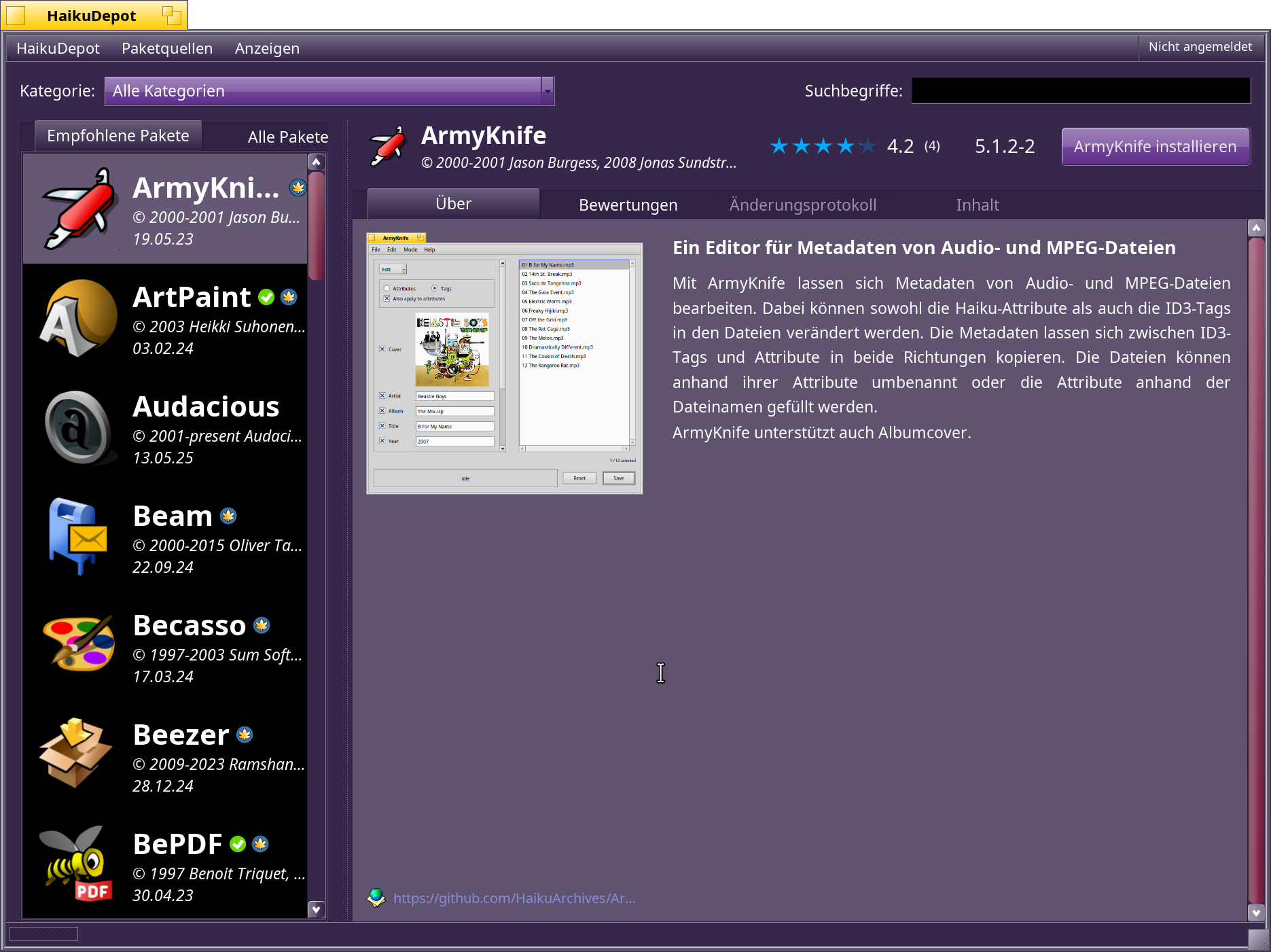

Thank you! I don’t want to leave this hanging. I’ve tried to incorporate your feedback here. If we can reach a consensus, hopefully, this can become the blueprint for the next version of HaikuDepot
If there’s more to address, I’ll pick it up when I can

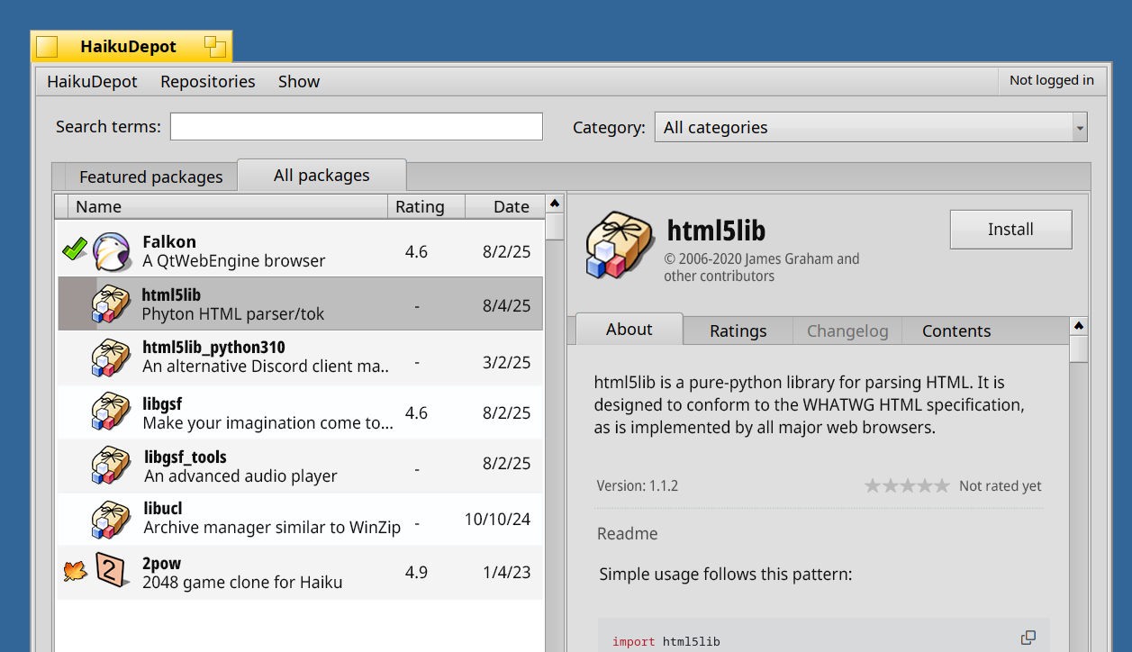

Personally I want a tab between featured and all packages, that would list all “usefull” packages. i.e gui apps… currently this is done with show->dev packages and such, but this is a bit annoying.
That is not directly relatedto your design however. The current iteration apart from not beeing “pixel perfect” (i.e some elements like the splitter or the scrollbars are not perfectly aligned) seems quite good to me. The final render with a working gui would probably look even better.

There is no need to list “all pacckages” without any filtering. No one is going to read through a list of thousands of packages.
We need a list that always shows search results. The default search can be “featured packages” and then you can edit the search request, to list only a category, seargh by name, etc. This will not be implemented with tabs. It should look more like Tracker queries window, maybe with an unfoldable “advanced search” panel if we don’t want to put search terms at the top level.
In that situation, the compact mode of the list doesn’t need to be usede. Search results can appear in big entries with useful info as the featured view does currently.
I’m a bit confused where you read that from. I am annoyed that it works like that currently, I did not say that I want an unfiltered list.
Agreed. I’d use the term “end-user packages” or “user-facing apps” or something, but I fully agree with the idea. We can fight about terminology later. We may already have a mechanism for it.

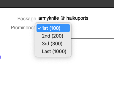

When I set the prominence of an app I have the following choices:
100 gets an app on the Featured list
200 creates a second alphabetized Featured list after the first one, which is … a bit weird. I discussed it with Humdinger but we decided against using it.
300 currently does nothing AFAIK
1000 is what I use to take an app off the Featured list.
So a setting of 300 or below is available to mark GUI apps. Marking the apps is an afternoon’s work. I don’t mind doing it. Coding the new tab I will leave to my betters.
Not saying this is the most elegant solution. But it is available.

@anon40228759 Do you have an example with the “new” view with a screenshot? with humdingers header feedback applied.
This is the first wip version (one line change, heh)
I’d put the screenshot below the description.
How would you deal with that for example for this? The description is quite long, and could be even longer… i don’t have any space problems on a 4k screen, but this should be useable aswell on a smaller screen, and argueably a screenshot is important for identification… if it isn’t, and this is supposed to be like a screenshot library it would make sense to have it below
edit: with defaults
Correct; see the constant PROMINANCE_ORDERING_PROMINENT_MAX in HaikuDepotConstants.h which is currently filtering anything < 200.
I’d be interested to hear what a more elegant solution might look like. This seems to be easily comprehensible, is easily administered and works reliably all the time.
