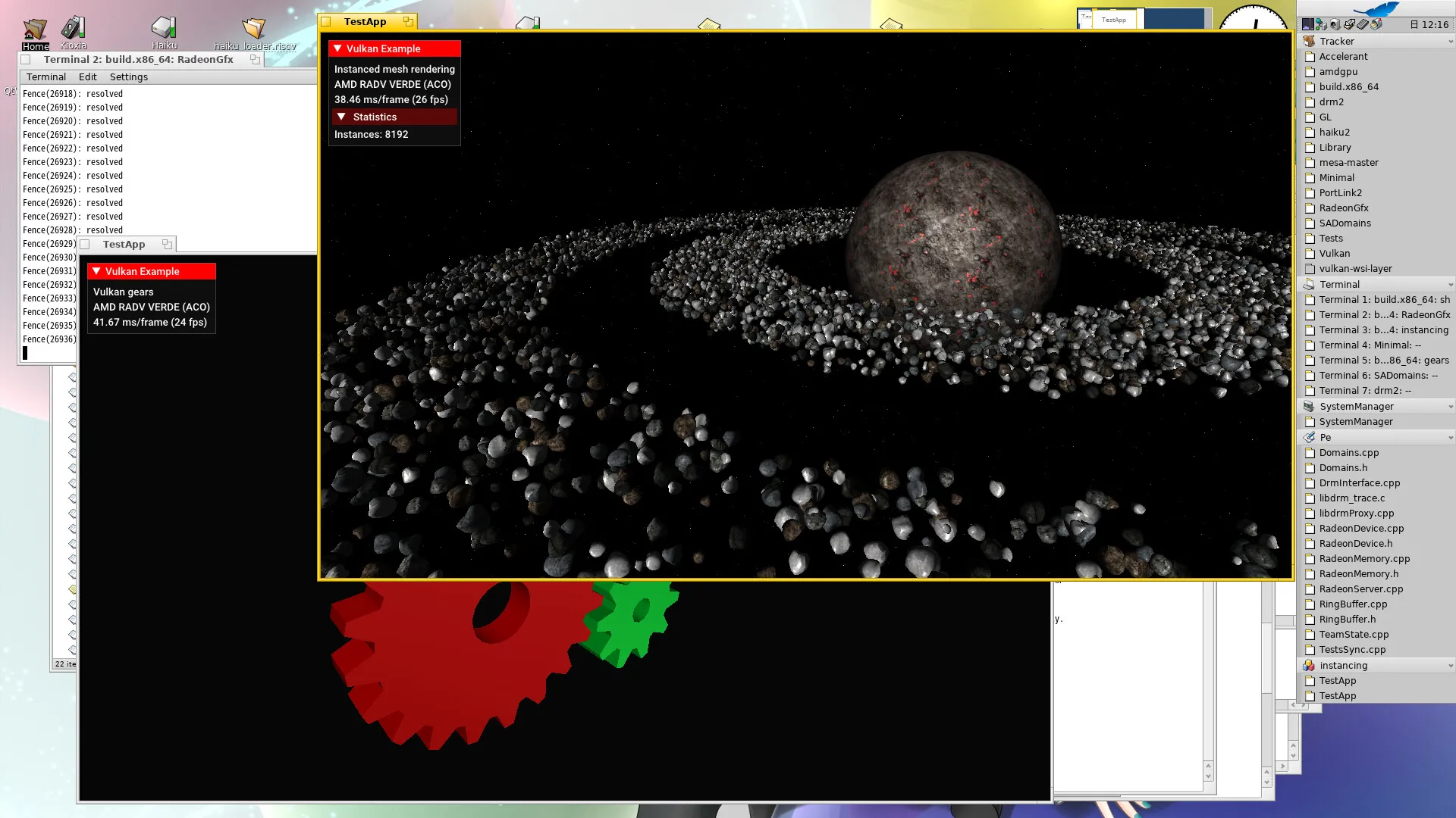

Vulkan lavapipe software rendering is working on Haiku
RadeonGfx use client-server model with client-server thread pairs like in app_server. For each client thread that calls 3D acceleation API, server side thread is created. If client thread terminates, server side thread also exit. I made small library “ThreadLink” that implements client-server thread pair model and simpilfy code. Calling server from client is very simple:
port_id gServerPort = find_port("RadeonGfx");
ClientThreadLink *link = GetClientThreadLink(gServerPort);
link->Link().StartMessage(radeonMmapMsg);
link->Link().Attach<int32>((int32)offset);
int32 reply;
link->Link().FlushWithReply(reply);
link->Link().Read<int32>(&area);
link->Link().Read<uint64>(&areaOfs);
Example of client and server stack when waiting command buffer execution to complete.
Client:
screenshot54
Server:
screenshot55

After fixing buffer stride alignment problem, multiple windows in Blender, window resizing and GLTeapot are working. There are currently problem with efficiency in Zink and RadeonGfx in server mode that it clone and delete buffer on each frame that is time consuming.
screenshot66
