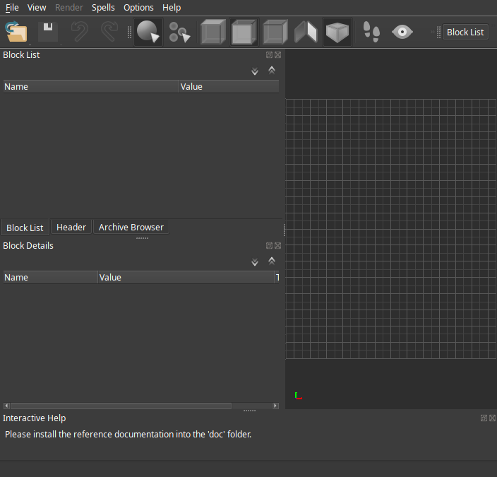

Not yet working completely and still need some adjustements on the recipe file, but at least I’ve got a first version which is opening :slight_smile:

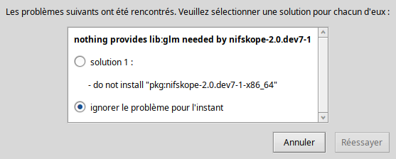

I currently have a .hpkg generated which is really a first step, however when trying to install it, I have the below error :
screenshot7
Any idea about what needs to be done ?

glm is a header only library and so there is no lib file to depend on. You can just remove the lib:glm$secondaryArchSuffix from the recipe but leave the devel:glm$secondaryArchSuffix line in place so that the headers can be found while building.
Also, you will probably need to change lib:qhull$secondaryArchSuffix to lib:libqhull_r$secondaryArchSuffix as I described in the previous post.
