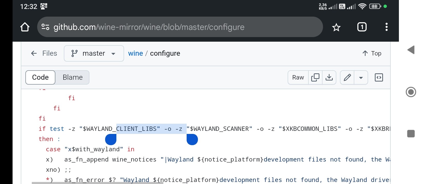

Your result looks very strange because this is the relative line
How so? it checks there for wayland_client/wayland_scanner/xkbcommon … (as seen in your screenshot)
I mean that it checks for the exact parameters you provide in the recipe and that it should not fail
I guess it’s related to the “notice_platform” that follows? Not sure.
Notice platform gets replaced with "64 bit"and the final message is “Wayland 64 bit development files not found”.

The line 16453 of configure checks or conditions for many things… The last one fails (the linux/input.h check) and prevents the --enable-wayland.
If it was missing the check would be ok on your system since you installed everything else and applied -L -I overrides.
