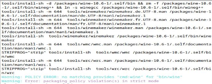

i think i found it…on the recipe a line on the PROVIDES section should be cmd:wine$secondaryArchSuffix = $portVersion …yet if i am correct i dont understand why the recipe worked for @Begasus…i ran haikuporter in strict mode (-S)
This explains the “POLICY ERROR:”, if you turn of strict mode you will get “POLICY WARNINGS” instead. :slight_smile:
Or add the cmd’s in the recipe like:
PROVIDES="
	cmd:wine = $portVersion
	cmd:function_grep.pl
	cmd:msidb
	cmd:msiexec
	cmd:notepad
	cmd:regedit
	cmd:regsvr32
	cmd:widl
	cmd:wine64
	cmd:wineboot
	cmd:winebuild
	cmd:winecfg
	cmd:wineconsole
	cmd:winecpp
	cmd:winedbg
	cmd:winedump
	cmd:winefile
	cmd:wineg++
	cmd:winegcc
	cmd:winemaker
	cmd:winemine
	cmd:winepath
	cmd:wineserver
	cmd:wmc
	cmd:wrc
If i correct the error and execute hp again will it recompile everything or it will make only the package?
You can skip the “build” by using “hp wine -F”, this jumps to INSTALL() part of the recipe. But mostly if a package is “build” it will just check the presence of the compiled files and then moves to INSTALL(), this doesn’t work for some projects though, no idea why. So using -F if build went fine should do the trick :slight_smile:

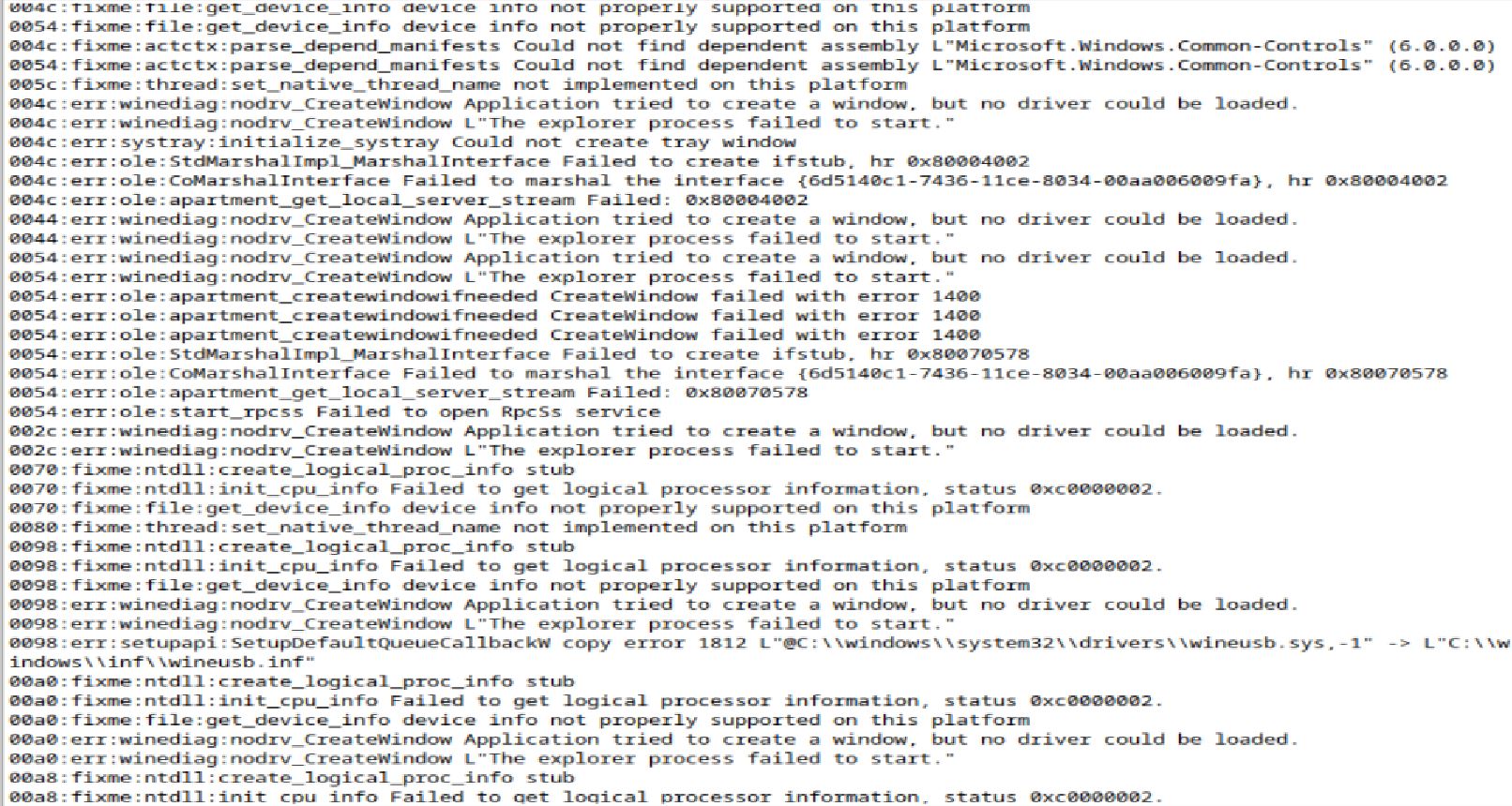

I was able to create hpkg and install it (using -j2)…Now i am at the same situation as @Begasus.I see the following driver loading error…Any ideas?
perhaps the “driver” is the windowing driver, iirc x512 created a new haiku native driver called winehaiku.drv, prior to that winex11.drv + xlibe seems to have been the solution.
@Wildman the 10.6 patchset contains dlls/winehaiku.drv folder and it’s files…I will check if that’s properly created

this is the command that let’s you in theory define drivers…still no luck though
wine reg.exe add HKCU\Software\Wine\Drivers /v Graphics /d wayland,X11 … and if you start like this you get wayland mode DISPLAY=: wine notepad.exe
…in my system i get memory errors like 002c:err:virtual:try_map_free_area mmap() error Bad address, range 0x7fffff410000-0x7ffffffe2000, unix_prot 0x7.
