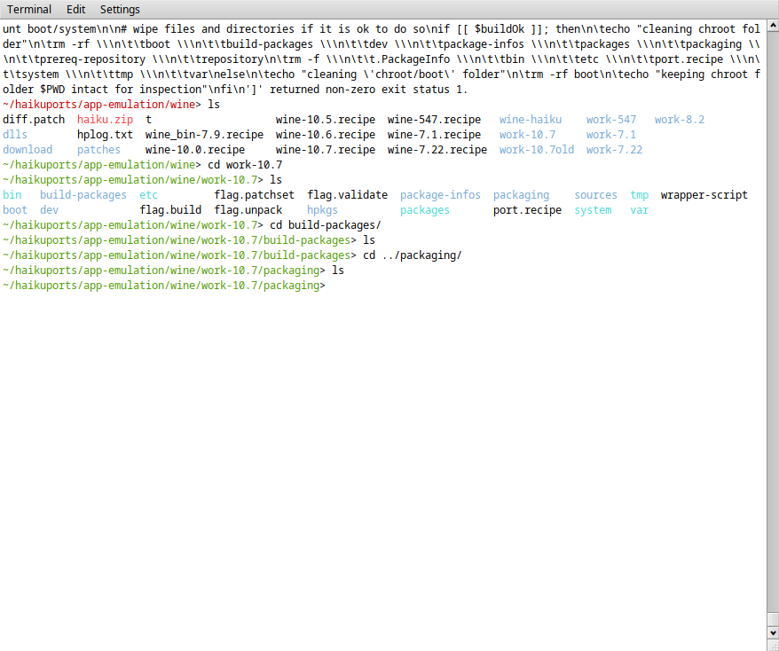

Once packages finish building they are moved from */work-*/packaging to */haikuports/packages? ![]()
It’s is not clear in the screenshot but previously it complained about the tracker and asked to forcefully unmount …i replied yes and it still exited with error
Ah, it had issues unmounting at the end of creating the packages? If so, this can happen, sometimes a small change in haikuports tree can trigger a git call and messes up with, this I beleive, or running a package install for something else in the meantime when build is finishing up, mostly running the build again should solve that.

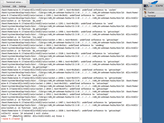

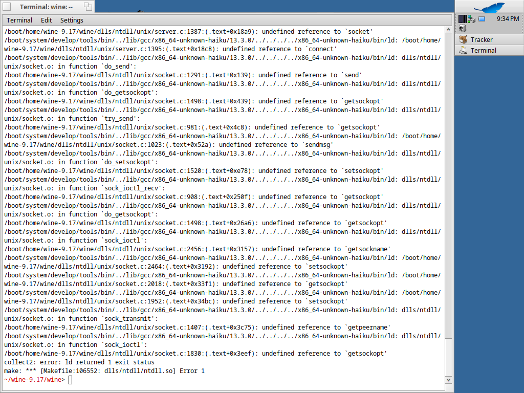

i am running make using x547 9.17 github repo and i get the following error…
i was expecting the sys/sockio header to solve the issue.Any thoughts?
The problem is not a missing header,but a library while linking.
You need to add -lnetwork to the ld flags.
This is mentioned in the recipe also (-lnetwork):
I ve seen the recipe… But i am running without hp for now… So i run manually

Where should -lnetwork be?
Just like in the recipe, before configure:
LDFLAGS=-lnetwork ./configure --enable-win64 --without-x --without-xshm --with-wayland
Or you could export it before calling configure with:
export LDFLAGS=-lnetwork

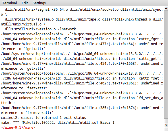

retried and stuck to new error…
please advise

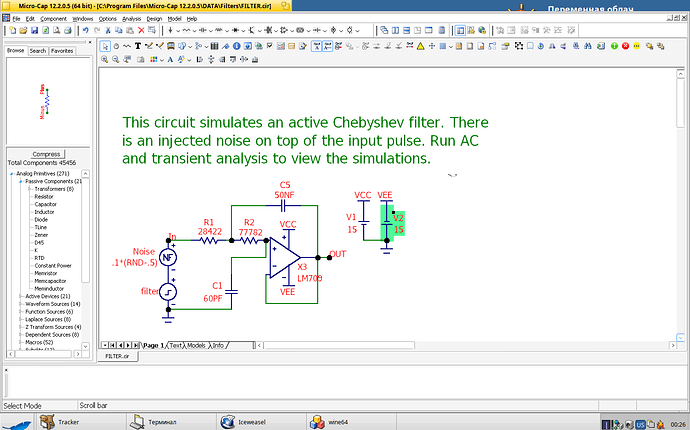

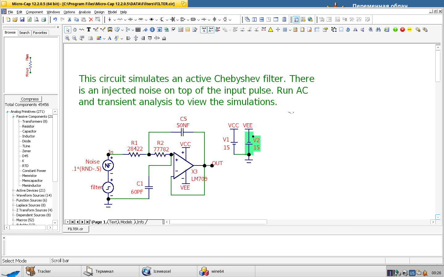

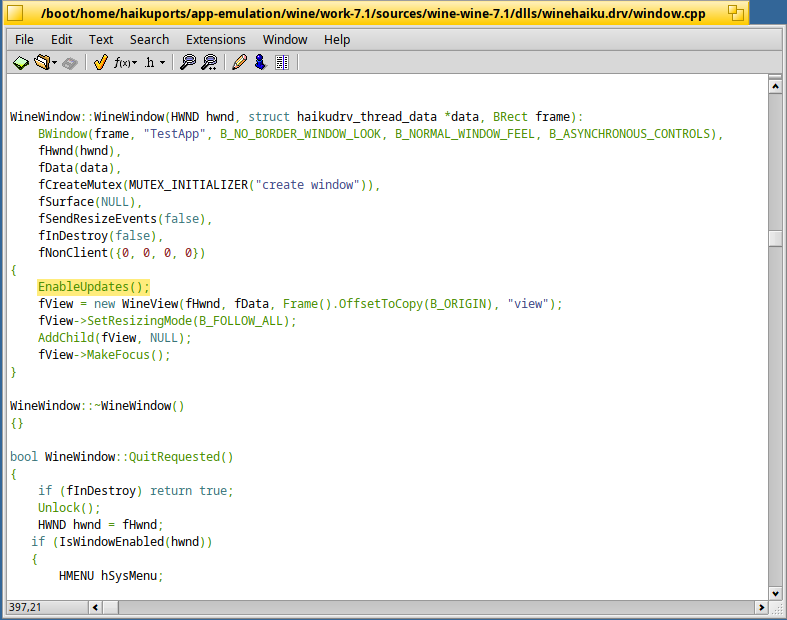

I fixed the winehaiku driver.
It works more correctly.
To fix driver, add a call EnableUpdates() function in the wine window constructor.
Link to download wine package ver. 7.1 with fixed winehaiku.drv: wine-7.1-2-x86_64.hpkg
doing a quick test…sergei’s hpkg seems working ok regarding redraw issue
confirmed, this has done the trick, at long last, maybe I can start using Haiku as more of a daily driver system.

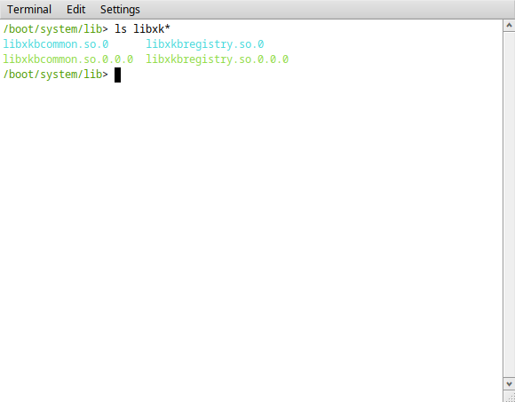

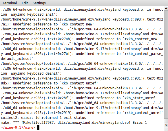

i was able to continue compilation…now i get a linker error regarding xkeyboard…
any advice?
Missing link with libxkb?
Checking with: lgrep xkb_context reveals:
/boot/system/lib/libxkbcommon.so.0.0.0:000000000002a9b0 T xkb_context_get_log_level
/boot/system/lib/libxkbcommon.so.0.0.0:000000000002a9d0 T xkb_context_get_log_verbosity
/boot/system/lib/libxkbcommon.so.0.0.0:000000000002ac60 T xkb_context_get_user_data
/boot/system/lib/libxkbcommon.so.0.0.0:000000000002a4c0 T xkb_context_include_path_append
/boot/system/lib/libxkbcommon.so.0.0.0:000000000002a6d0 T xkb_context_include_path_append_default
/boot/system/lib/libxkbcommon.so.0.0.0:000000000002a810 T xkb_context_include_path_clear
/boot/system/lib/libxkbcommon.so.0.0.0:000000000002a8f0 T xkb_context_include_path_get
/boot/system/lib/libxkbcommon.so.0.0.0:000000000002a8c0 T xkb_context_include_path_reset_defaults
/boot/system/lib/libxkbcommon.so.0.0.0:000000000002a9f0 T xkb_context_new
/boot/system/lib/libxkbcommon.so.0.0.0:000000000002a8e0 T xkb_context_num_include_paths
/boot/system/lib/libxkbcommon.so.0.0.0:000000000002a920 T xkb_context_ref
/boot/system/lib/libxkbcommon.so.0.0.0:000000000002a990 T xkb_context_set_log_fn
/boot/system/lib/libxkbcommon.so.0.0.0:000000000002a9c0 T xkb_context_set_log_level
/boot/system/lib/libxkbcommon.so.0.0.0:000000000002a9e0 T xkb_context_set_log_verbosity
/boot/system/lib/libxkbcommon.so.0.0.0:000000000002ac70 T xkb_context_set_user_data
/boot/system/lib/libxkbcommon.so.0.0.0:000000000002a930 T xkb_context_unref
/boot/system/lib/libxkbregistry.so.0.0.0:0000000000004610 T rxkb_context_get_log_level
/boot/system/lib/libxkbregistry.so.0.0.0:0000000000004d40 T rxkb_context_get_user_data
/boot/system/lib/libxkbregistry.so.0.0.0:0000000000004650 T rxkb_context_include_path_append
/boot/system/lib/libxkbregistry.so.0.0.0:0000000000004920 T rxkb_context_include_path_append_default
/boot/system/lib/libxkbregistry.so.0.0.0:0000000000004950 T rxkb_context_new
/boot/system/lib/libxkbregistry.so.0.0.0:0000000000004b70 T rxkb_context_parse
/boot/system/lib/libxkbregistry.so.0.0.0:0000000000004d20 T rxkb_context_parse_default_ruleset
/boot/system/lib/libxkbregistry.so.0.0.0:0000000000004590 T rxkb_context_ref
/boot/system/lib/libxkbregistry.so.0.0.0:0000000000004630 T rxkb_context_set_log_fn
/boot/system/lib/libxkbregistry.so.0.0.0:0000000000004620 T rxkb_context_set_log_level
/boot/system/lib/libxkbregistry.so.0.0.0:0000000000004d30 T rxkb_context_set_user_data
/boot/system/lib/libxkbregistry.so.0.0.0:00000000000045b0 T rxkb_context_unref
These come from the package: libxkbcommon
i have these
and i do these commands manually on x547 wayland branch :
autoreconf -i
configure --enable-win64 --enable-archs=i386,x86_64 --without-x --with-wayland
