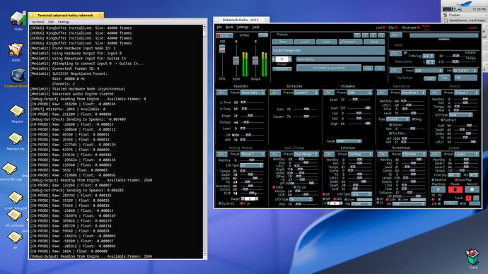

Hi all,
Just wanted to share a screenshot. This is my favorite guitar app that natively uses jackd and all the linux alsa libs and tons of other linux libs. With the help of AI, I’ve managed to get it to build the GUI at least, and the goal is to have it use Haiku Media Kit, with all the effects. Fingers crossed I don’t hit any major road blocks as I so much love to have this on Haiku to play guitar

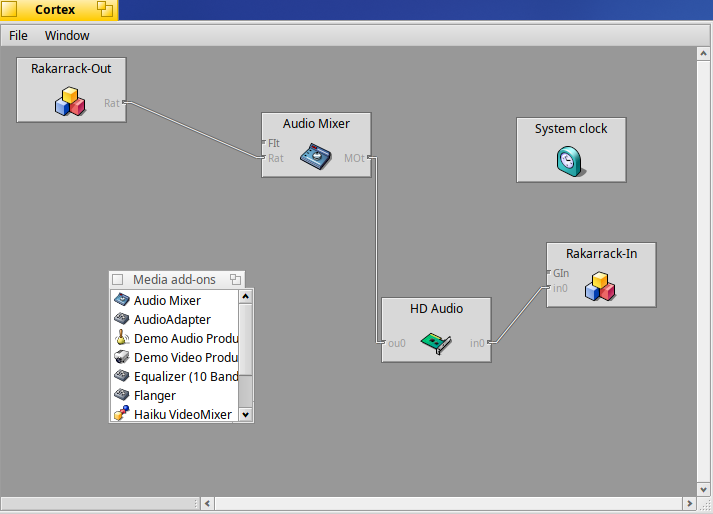

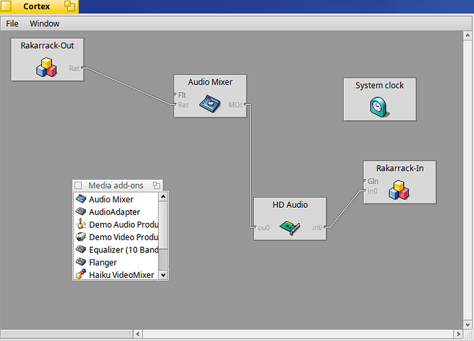

Hi, just thought I’d share my progress.
Cortex source code and CodyCam have been a big help. I’ve managed to get
  • Rakarrack-in Producer node and Rakarrack-out Consumer nodes correctly established.
  • Data directory is fixed now in configure. So all the presets work.
What’s next?
  • Getting the mic input to talk to rakarrack. You’d think with the Consumer and Producer nodes available this would be easy. Ugh
  • Once that’s fixed I can move on to fine tuning the app, maybe adding RealtimeAlloc.h processing for better sampling and what not.
Dropping BSoundPlayer usage for the input part was the right move, as it couldn’t have worked at all: BSoundPlayer is a Media kit output only object ;-). You can remove the BSoundPlayer * inPlayer variable, BTW.
ConnectInputToPlayer() is still there, but I failed to see where it was called, if ever.
Regarding the new RakInputNode class:
  • it should report (AddNodeKind) a node kind of B_BUFFER_PRODUCER, not B_PHYSICAL_INPUT, as it’s not a physical input, the node producing the mic in audio is.
  • while it declare it accept any kind of raw audio format (wildcard), on HaikuRecordAudio callback, via RakInputNode::BufferReceived(), it assumes it’s a float stereo format, which may not be the case.
  • the connection between this RakInputNode ‘Guitar In” destination and the HD audio node “in0” source seems to not being done by the code. Do you do it currently manually via Cortex app?
To have a better understanding, you can use debugger app to see what happens, but if you don’t feel like using a debugging tool yet, then simply insert some printf() to output on console some useful messages reporting where is the code in the haiku-specific lines of code, dumping the current values of variables at hand, etc.
In order to see these log messages, you will need to start the app from the Terminal.
Thanks! These are really great tips. ATM the rakkarrack-out node is just talking to itself. For example, while playing the metronome I can turn up the reverb and it effects the metronome with reverb which shouldn’t. I will definitely look into all your suggestions and see what I can do. Appreciate ya!
Hi all,
Latest build looks promising. Though still far from complete.
Using my built-in flag –debug at the command line you can see the node connections.
What’s working / what’s not working:
  • Raw guitar works / Using presets to change the raw sound not working.
  • Tuner works :stuck_out_tongue:
To test make sure your media server is set to 48kHz as that is hard coded in
Known bug: After you stop rakarrack you have to restart media server for it to make a new connection.
