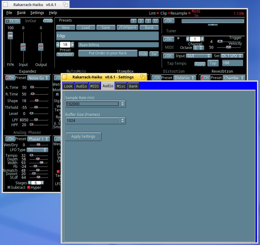

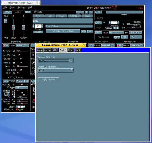

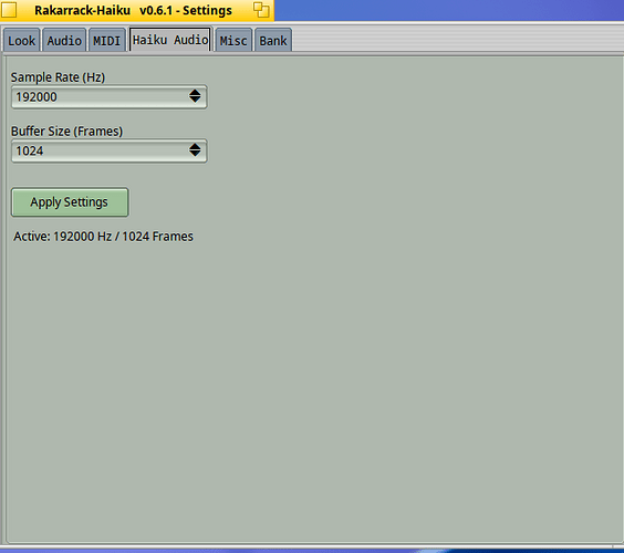

Hi all,
Another big win here my rakarrack fans. v1.0.3 is here!
  • Most importantly the user can now configure freq and buffer settings in the UI.
  • Great news for realtime audio. With Haiku hrev59628 realtime audio works!
  • This version went back to the v.1.0.0 BSoundplayer logic. Why you may ask? Because I love playing drums with my guitar and v.1.0.2 locked out any other audio from playing. That maybe good for certain situations but not me.
Here’s v.1.0.3 rakarrack-0.6.1-1-x86_64.hpkg for download
Here’s a screenshot of the new ui audio tab.

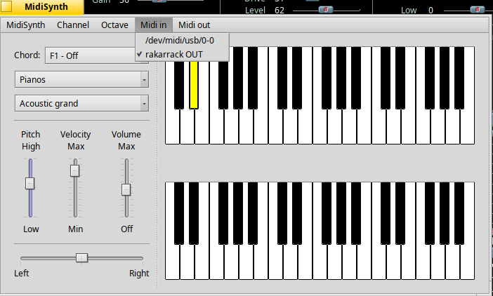

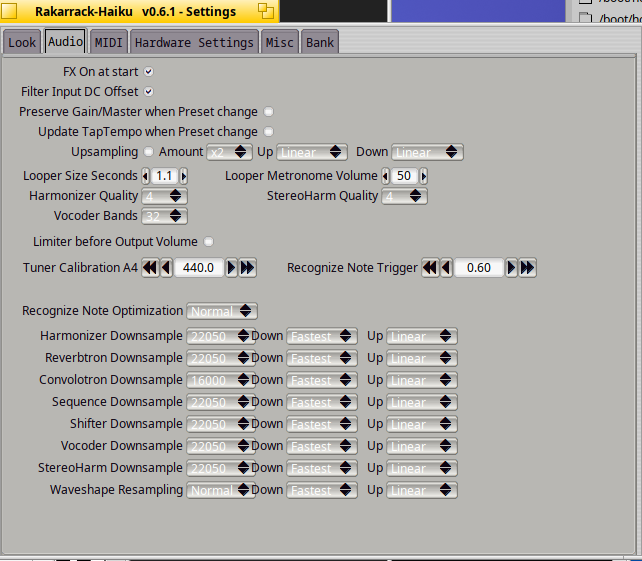

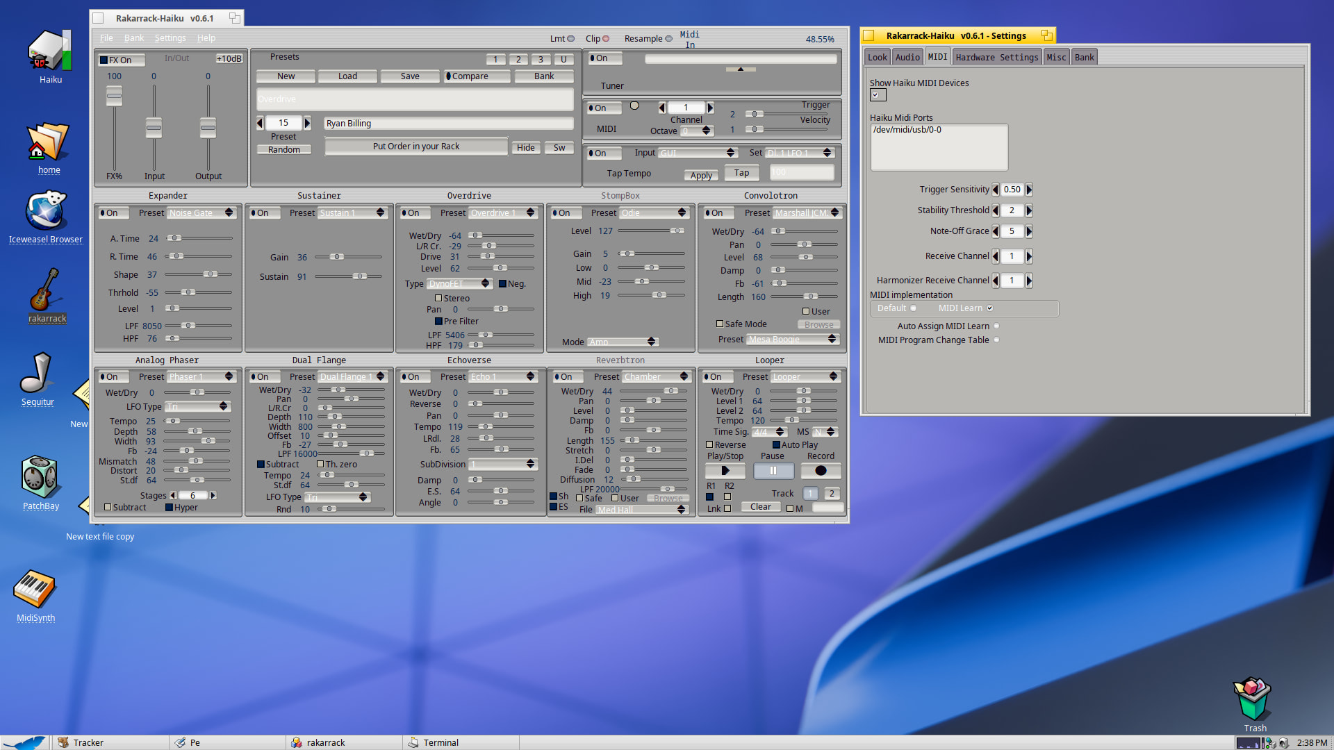

Hi all,
The rakarrack-haiku has gained working midi support.
  • Added three fine tune midi options in the midi preference menu to help fine tune some midi parameters.
  • Added midi ports as seen in the screenshot.
  • Fixed FX On not triggering if set to automatically turn on.
  • Cleaned up the Audio and Midi menu layout to fit better.
To have rakarrack play midi to MidiSynth you will need to
  • Download and install soundfonts via HaikuDepot
  • Click the midi button on the main rakarrack interface.
  • Tell MidiSynth to use rakarrack OUT in Midi in options as seen in the screenshot below.
Latest: rakarrack-0.6.1-1-x86_64.hpkg
See a demo video

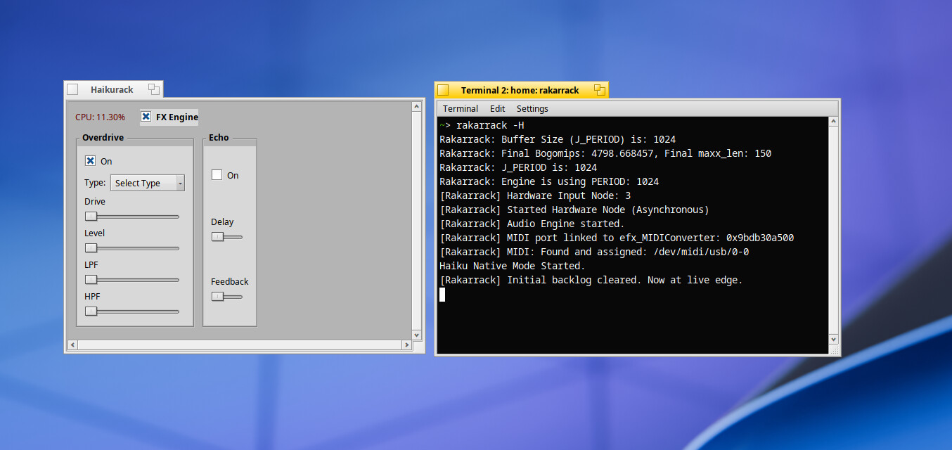

Hi all,
Latest updates and news from my side of the universe.
  • Added Haiku Frontend: To try run rakarrack -H from terminal
  • The Haiku frontend is a little flaky at the moment:
    → Clicking the FX button twice or thrice is needed for the backend to start.
    → Overdrive and echo are the only two presets that seem to work ( that’s why they’re only two ! ).
    – Ideally when this matures, there would be a way to assign the order of effects. That’s next on my todo list.

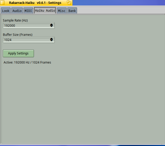

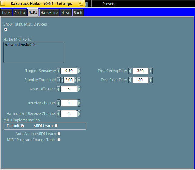

Small but useful update for Rakarrack Haiku
  1. Added low and high ffreq filter to the MIDI logic.
Basically, this will filter out high strings and low strings so they will not get mapped to MIDI.
Screenshots
rakarrack-0.6.1-1-x86_gcc2.hpkg
Github source
