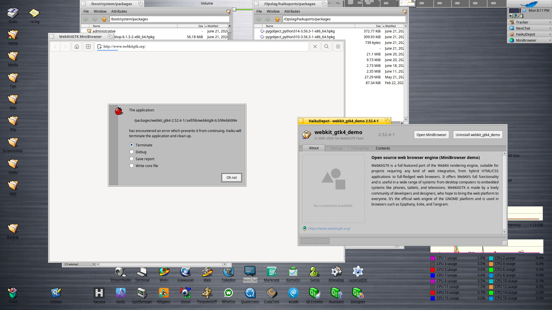

Few months ago, I played a bit with these MiniBrowsers. They indeed can be handy if you don’t want a beast to visit few sites that don’t work with Web+. In fact, so handy that the problem is to keep in mind that they are demo software and that you should avoid to use them if security matters.
Is that the minibrowser from GTK4?
MiniBrowser - WebKit_GTK 2.40.0.
I guess @brooklynakos meant the one for GTK4 (2.52.4 here)?
I meant this one
That’s the one build with GTK4 as mentioned earlier, v2.52.4.

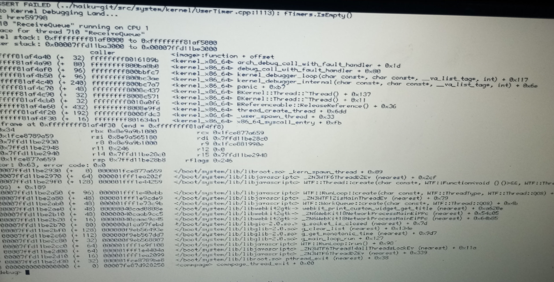

I installed webkit_gtk_demo using pkgman and Minibrowser is unusable for me …i got “TLS support is not available”…I also got a KDL but i don’t know whether is reproducible…I have a photo of it if it is useful
Edit: Next time i tried i did not get a KDL but a crash.I have a report saved if useful.
Edit2: i installed manually glib_networking and now Minibrowser is functional. This should be taken care by the hpkg creator though.
@Begasus maybe glib_networking is missing also in version 2.52.4 you are using… Check plz.
This Minibrowser is quicker compared to @DigitalBox’s one (the webkit 2 one) when running youtube.
Another minor issue is that https:// is not prefixed automatically when entering a url.
The webkit_gtk from the depot is not the one I have installed here, and the minibrowser in my version can’t be used due to the error shown above. The current one in the depot is still build with GTK3 and has been around for a while.
@brooklynakos glib_networking is installed, so that shouldn’t be a problem with that here.
