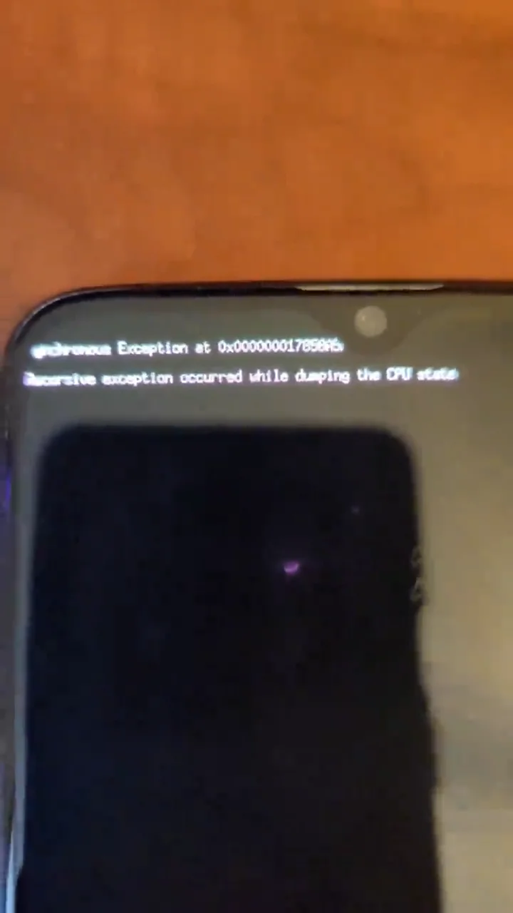

I’m afraid without serial output debugging will be… difficult. Sorry for the video quality, it’s hard to capture the screen of a cell phone without an OS running on it.

Here’s the device tree for the device:
Looks like we need GICv3 Interrupt Controller support for ARM64. We only have GICv2 today.
https://dev.haiku-os.org/ticket/18596
