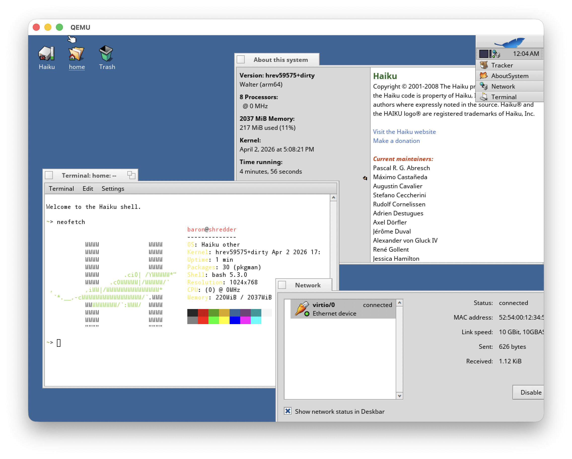

I’ve been spending some time improving the arm64 port of Haiku with the goal of some day running Haiku on my M1 MacBook Air.
Here’s the current state of the port (in QEMU) as of hrev59575:
The port is mostly stable and all of the usual QEMU devices (virtio SCSI, virtio net, xHCI USB) as well as up to 8 core SMP work as expected. Though there is at least one kernel crash and some double frees that need to be worked out.

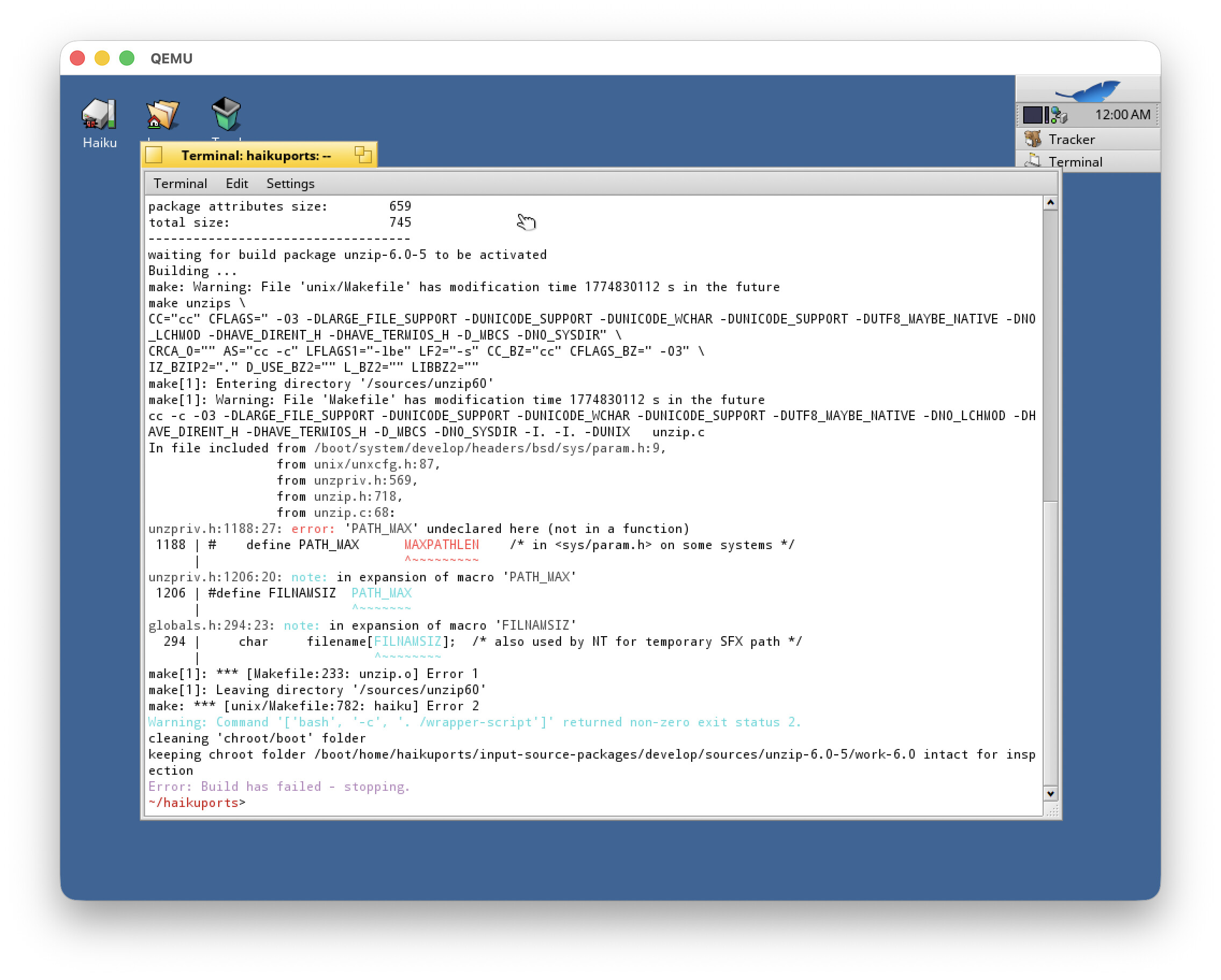

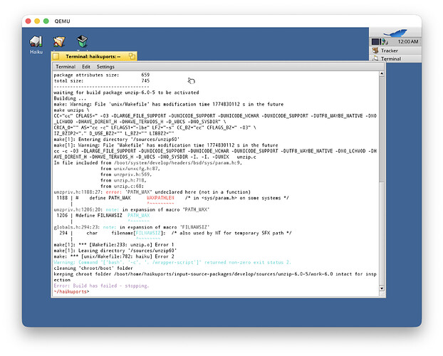

There are also still some issues with software ports that need to be resolved, for example:
If you want to try it yourself, you’ll need to bootstrap Haiku, since the binary packages currently used in the build process need to be rebuilt.
