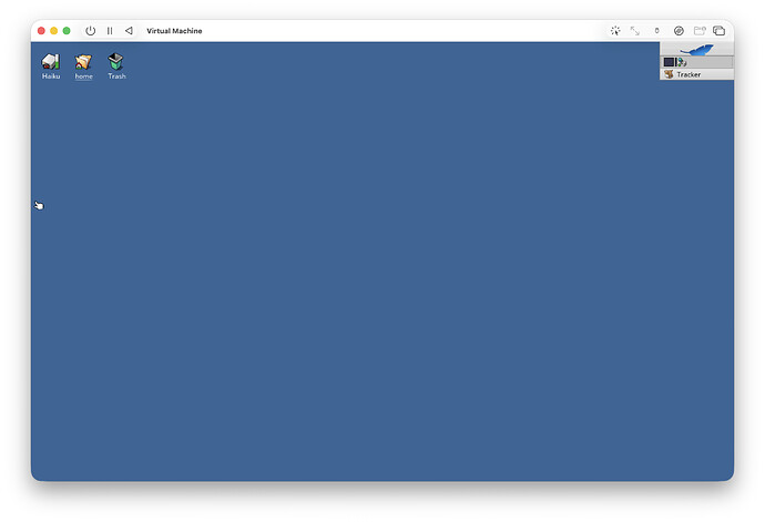

My Haiku arm64 Progress
Got Haiku booting in UTM with some small fixes. Mouse movement is slow and choppy though, so it’s not especially fun to use

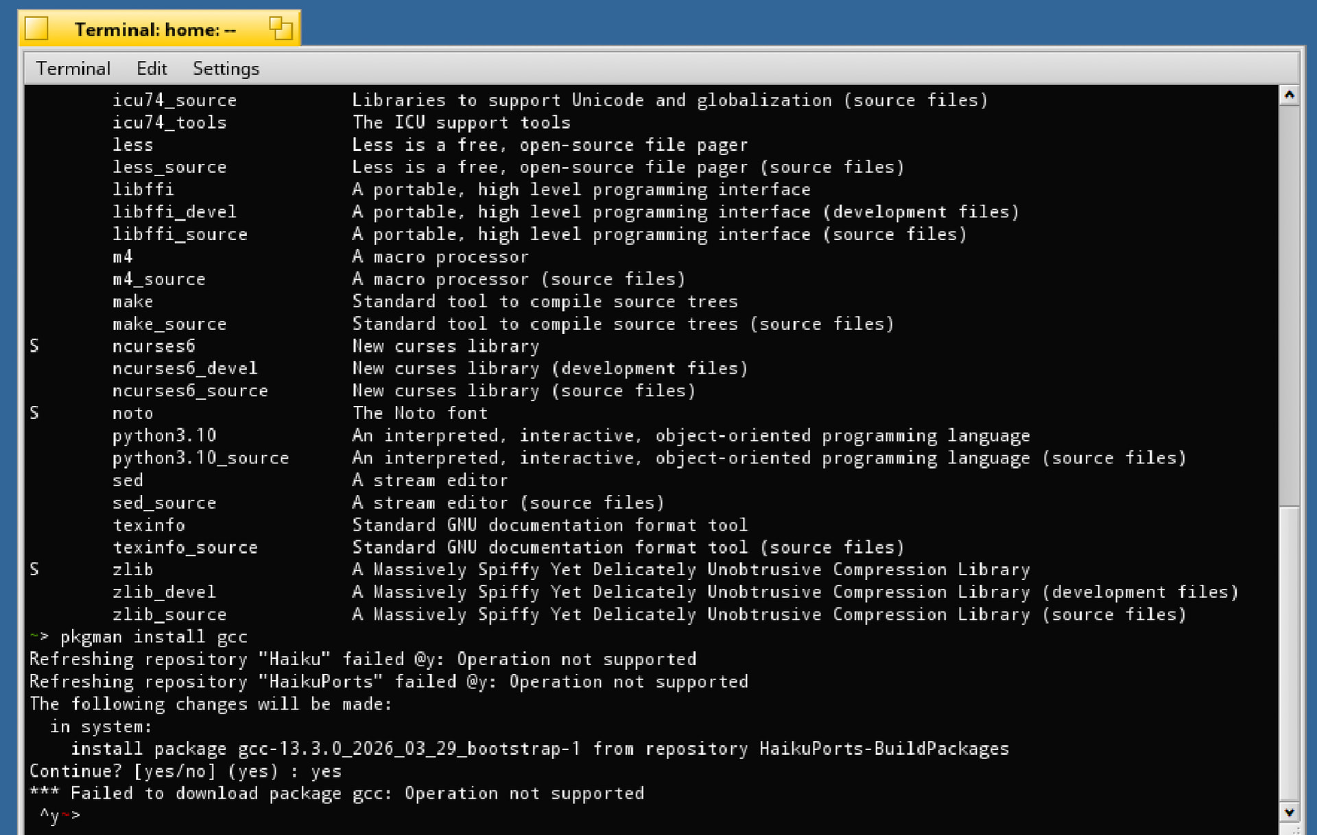

On my side, pkgman can’t install any package and I have the “operation not supported” error :
This may be caused by the imagebeing built without openssl support. In which case, indeed it will be difficult to get anything useful done with it.
If the package is available in the depot you could grab the link there and use wget to pull it in, had to do some magic for that also on the riscv64 image to be able to setup haikuporter/haikuports.
