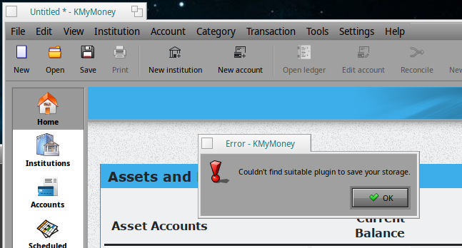

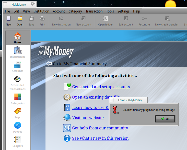

Well…I downloaded and installed kMyMoney_kf5. However, all the plugins are missing.
I cannot remember—about 20-ish plugins should be installed with kMyMoney.

Could you check if there is some additional info when launched from Terminal? The actual recipe is the one that was used to build the original one, so in that regard nothing should have changed.
On first sight it seems OK here?
