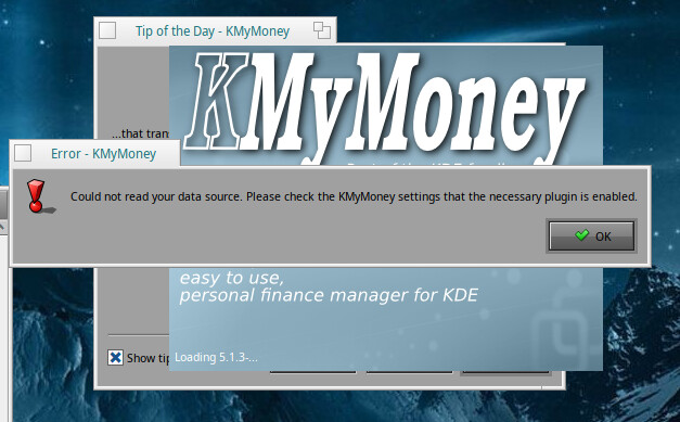

I upgraded to H1B6 three weeks ago. I waited till now to see what else I should report after I checked out all the software that I use daily. My only gripe is with kMyMoney (v 5.1.3 [KF5])…it is missing a plugin to read the financial file.
It still opens fine in H1B5 (laptop), whereas, compared to the PC with the H1B6, it does not with the following message:

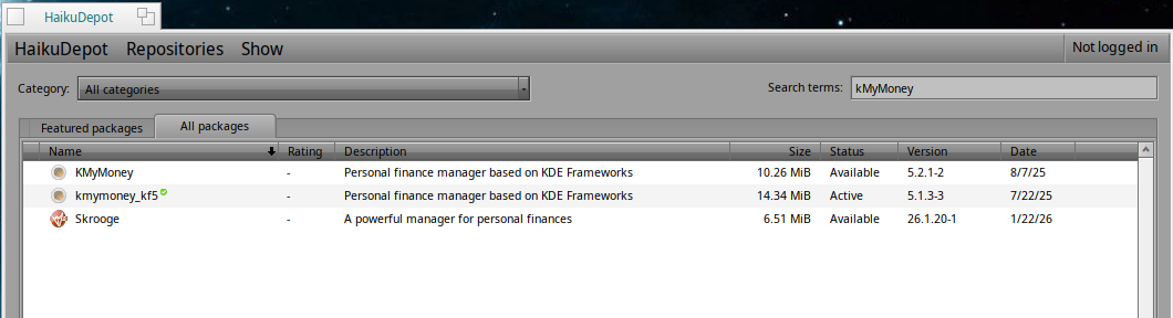

Refer to the next pic for the software installed that is now presenting the issue:
