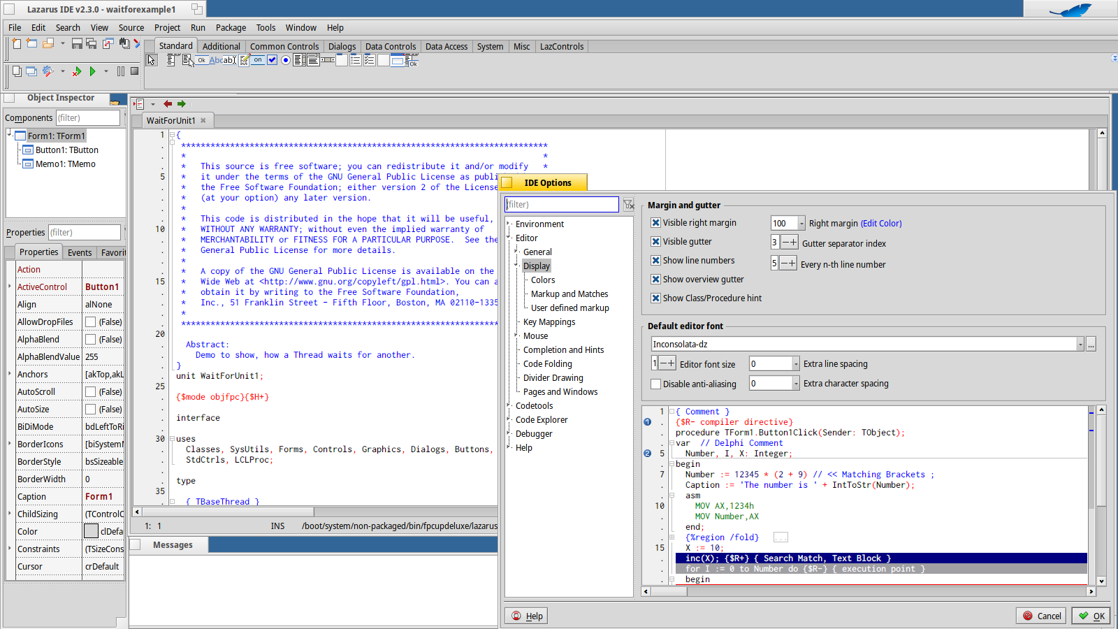

A thread example from lazarus running fine :slight_smile:
Lazarus-exampe
Ouch, that font rendering is hideous.
I thought it was this bug Fonts in the qt IDE are broken with qt 5.14 (#36483) Ā· Issues Ā· FPC / Lazarus / Lazarus Ā· GitLab but it was fixed almost 2 years ago.
Haven’t really looked at the fonts, but it didn’t hurt me :stuck_out_tongue:
Does it work with Iinconsolata, Source Code Pro or Fira Code?
Not sure, only tried to get it running, any link(s) to them?
FiraCode is in haiku depot
It ought to look okay with Noto Sans Mono (it’s a proper monospaced font after all). I doubt installing another font would (or should) make a difference.
Played a bit with the fonts now (default was Noto Sans Display), installing other fonts work too.
Lazarus-font
Lazarus-font2
