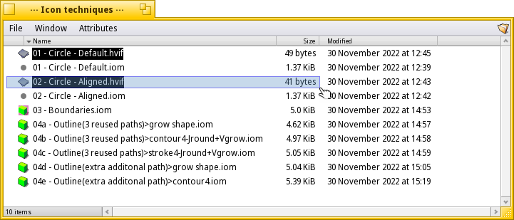

I use http://0x0.st/o0V-.iom to start with my icons, it’s a circle perfectly aligned with the grid so it weights a little less than the standard one, plus it’s in translucent black that can be reused for the shadow style

The download link doesn’t work, but I tried it directly and the resulting circle is indistinguishable from the default one. Just this detail made the resulting hvif 8 bytes smaller.

Now I can see that you also had the circle itself slightly bigger, aligned with the 32px grid.
In my tests from yesterday I just took the default circle path and aligned only the control handlers, that were pretty close to a 64px grid point:
… instead, by transforming the circle path to make the radius grow one pixel in the 32px grid as you do, the handlers that need to be aligned are already practically touching a grid point:

Even with the resulting hvif weighting the same either way, this way achieves an even more perfect virtually perfect circle.
