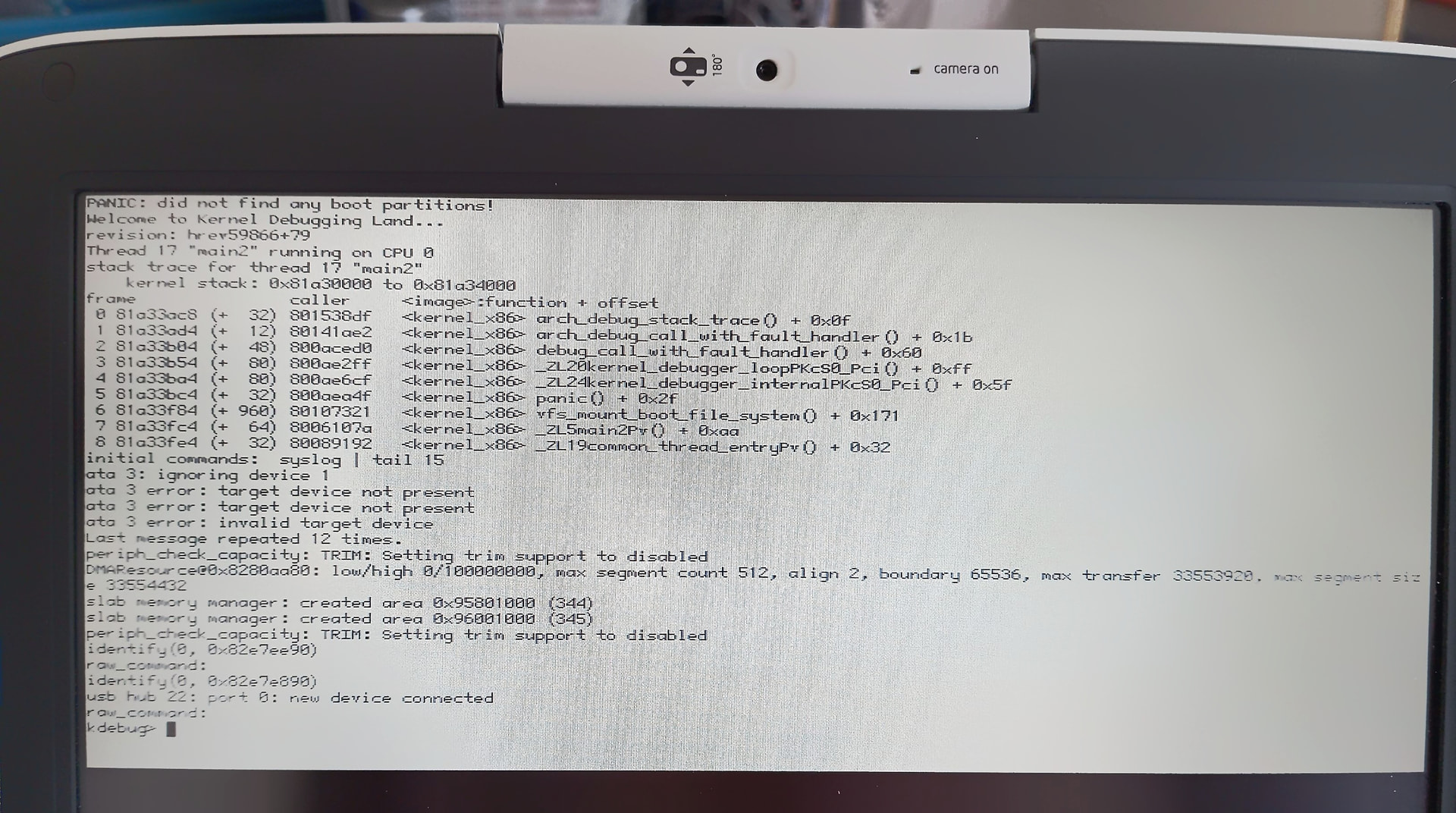

I have successfully installed the x86 version onto a Compaq laptop with a 1.5GB of RAM, a Mobility Sempron 3000+ and ATI Radeon Xpress 200M graphics. It runs decently well and I am currently booted using the radeon video driver.
I have noticed a few quirks:
  1. The ISO refuses to boot on my machine, this also effects Beta 5 and Beta 4. I ended up installing it directly to the drive using VMWare
  2. Deskbar does not load on startup and will not open when clicking on it. Running it though the debugger did not give me anything
  3. When booting up sometimes the video driver goes haywire and causes the screen to have black bars and warp, almost like a CRT thats out of range? idk how to describe it best but it was fixed by changing the resolution in software
That doesn’t mean too much when we’re an OS with not so many users, and when DVD burning is a rare task. I would suspect a bug in BurnItNow or in Haiku, personally, so if you want to help debug this, please do report it somewhere (probably BurnItNow first?)
I think someone else encountered this and it had something to do with Deskbar’s configuration, perhaps. Can you try copying Deskbar’s settings files out of ~/config/settings (so we can investigate them if they’re indeed the problem), and then rebooting?
Sounds like a bug in the radeon driver. Probably it should be reported.

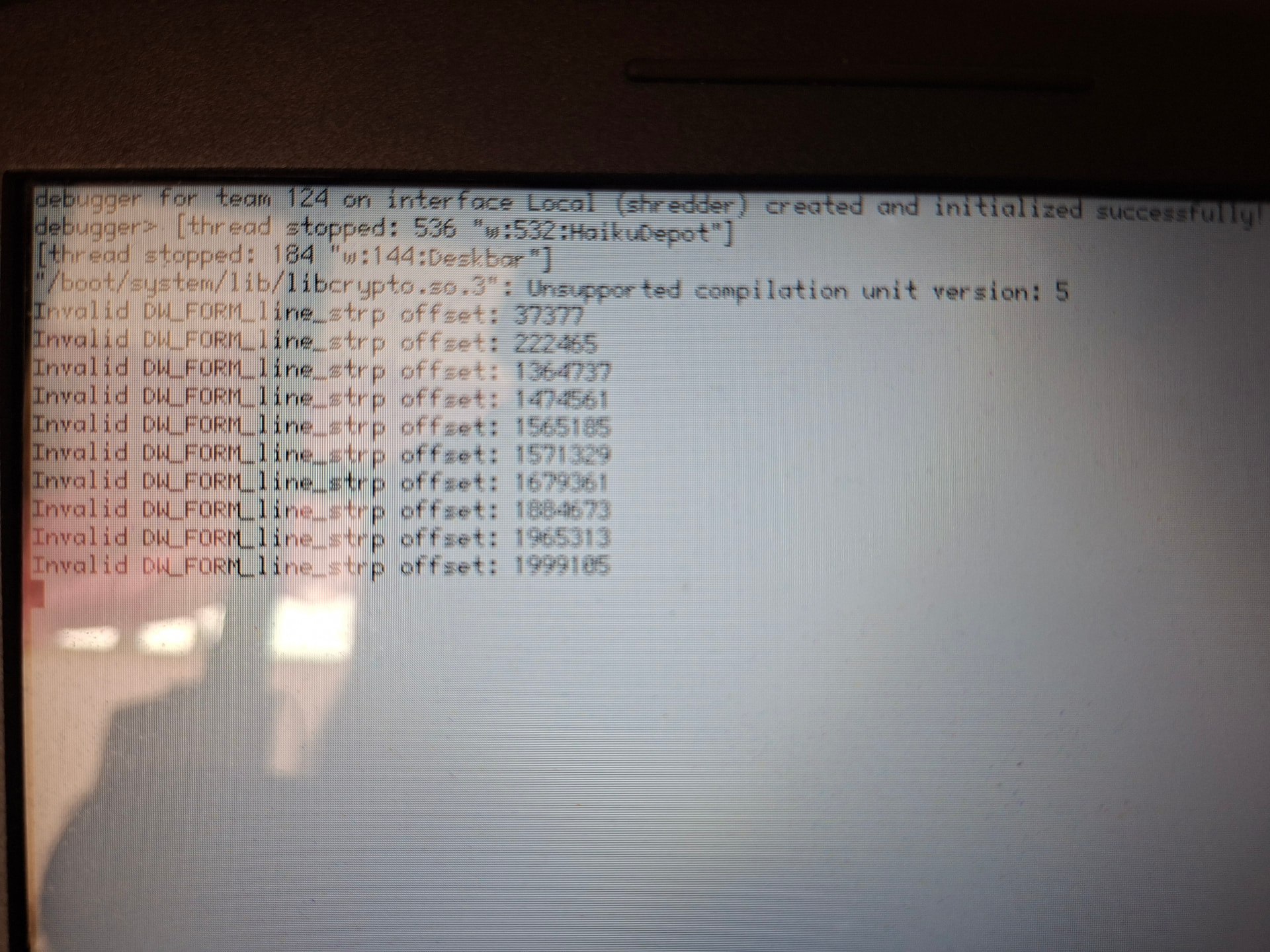

I upgraded from beta5 stable to beta6. I manually modified the repositories via pkgman. The upgrade process via terminal succeeded, but after rebooting I am experiencing several issues:
​The touchpad is not working
​Launching any application results in a kernel error
If you don’t have any open tickets about this, please open one.
Likely a regression from the PS/2 touchpad refactors. Please open a ticket if you haven’t already.
This is an app_server crash, not a kernel crash (though they do look similar). Please type save-report and hit Enter, and see if it says it saved a report; you should then be able to upload that somewhere for inspection.
Sorry for the mix-up.
I saved the report, restored a previous boot state, and recovered the created file. Where can I upload the report file?
(I noticed that all the applications I tried to launch crash the app-server, and the message always refers to the libcrypto.so.3 library)
Just open a ticket and attach it. In case it’s a duplicate we’ll just close it as one.
After a few attempts, the only workaround that worked for me was a fresh install using a bootable USB.
OK. Should we close the ticket then?
I think it’s right to close it, given that no useful information can be extracted from the report logs.
