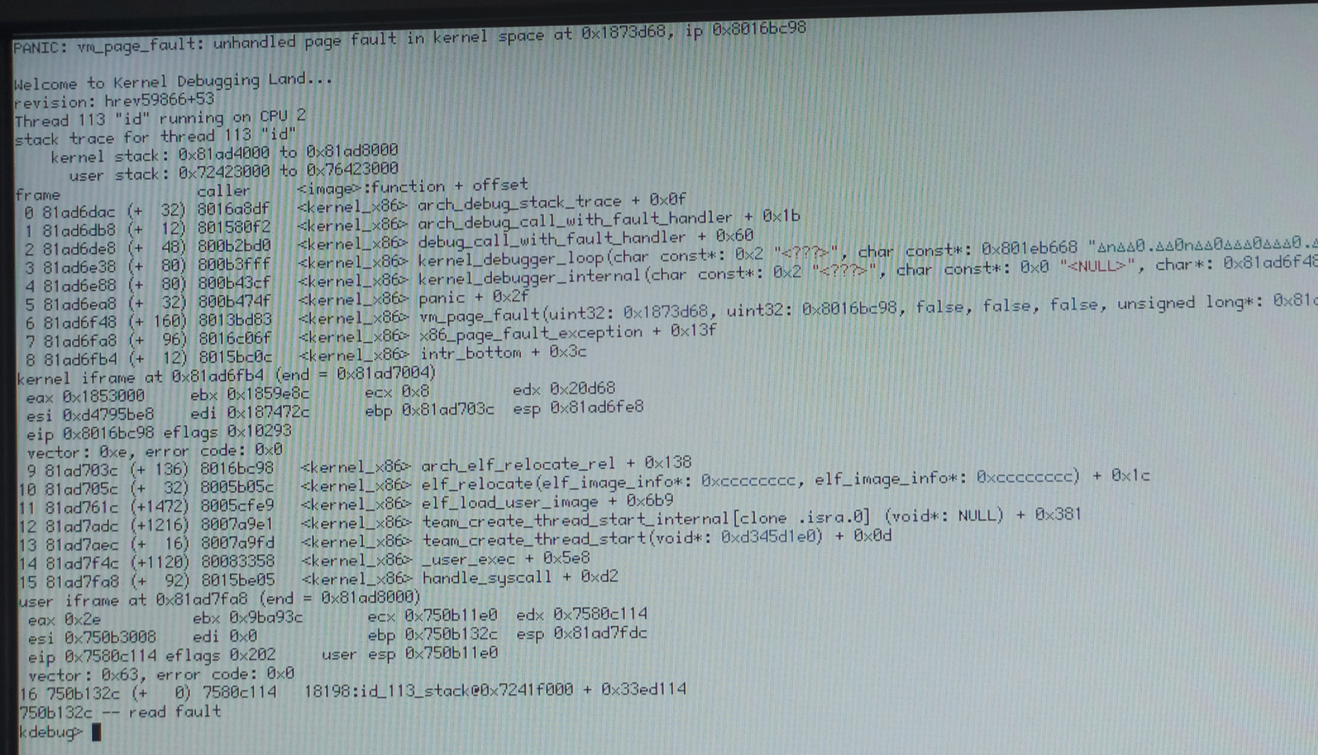

32bit works fine on my eee PC (with already known sound and cpu id issues) but hangs at the rocket on my ThinkCentre with an i7-7700T. 64bit boots fine there however.
Picture of the KDL when the boot process hangs (the pc is unresponsive at this point)
Let me know if there’s a ticket for this already.
i7 is a 64-bit processor. Unlike hybrids like Core and Core 2 Duos and Quads, it can’t run 32-bit operating systems.
Core i7 7th Gen can run 32 bit Haiku fine, they still have the 32 bit instruction set, it depends on if the BIOS has Legacy/CSM support which later systems lack. I run 32 bit versions of Haiku on my Intel Core CPU based systems of a similar generation and they work fine.
Learn something new everyday. I thought CSM was just MBR vs UEFI. Had no clue you could run 32-bit on modern processors.
What hrev? If not the latest, please update (there were some relevant changes recently.) And then open a ticket if it persists. (Does anyone else in this thread see the same behavior?)
I don’t recognize it. Does the latest nightly have a similar problem? (The nightly builds are pretty close to beta6 right now in functionality of course, but the beta branch has a lot of debugging options turned off for performance, so it may KDL differently.) Please open a ticket either way.
(Does the bootloader show the previous syslog? You can possibly save it that way, much nicer than a picture of a KDL.)
