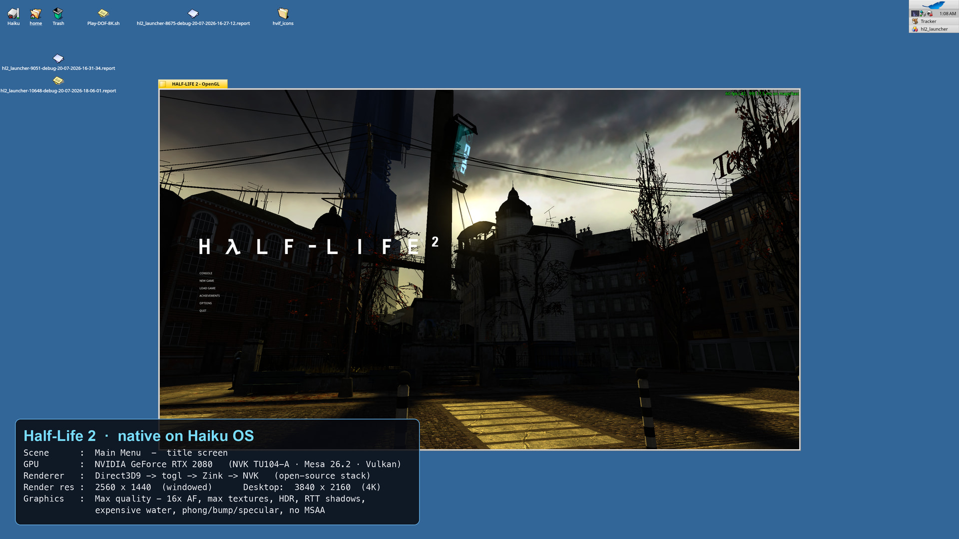

Wdym by “native”? Has it been compiled from leaked source code?
Yes, it’s possible to compile it from nillerusr source engine
