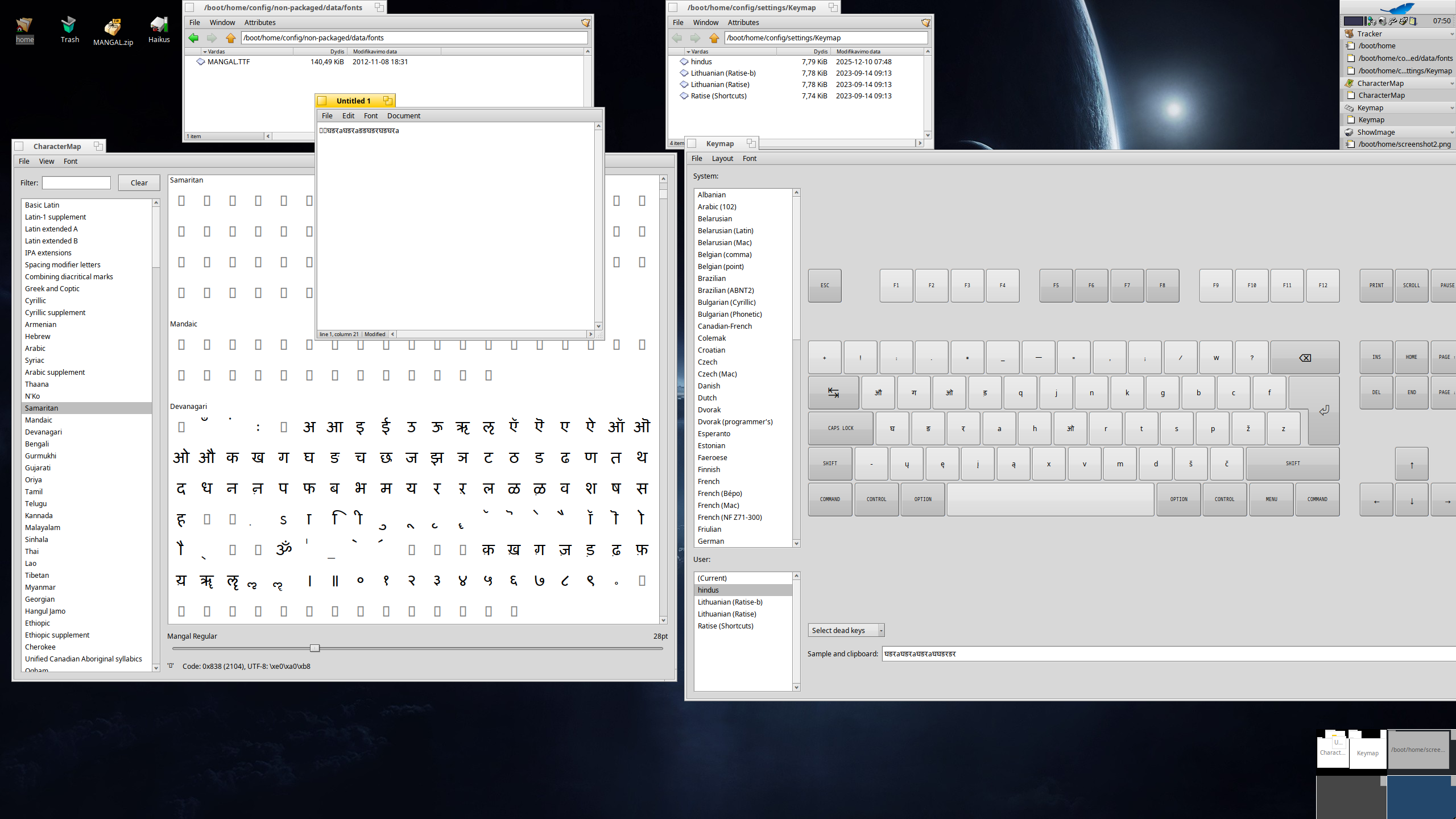

  1. CharacterMap: devnagari script characters shape shifting is a real issue
  2. Made up a keymap with those characters that were true, that is whatever CharacterMap displayed, I was able to pull
  3. With some 20 characters, I made a keymap
  4. installed Keymap switcher
  5. Opened libreoffice_writer…Selected my keymap ….typed the key for devnagari character….Devnagari character not displayed. only blank square boxes displayed, Just as Google displays
  6. Not expecting much help from anybody….just posting my rants here, just in case some one else was looking to type in devnagari script

I think your explanation throws some light on the shape-shifting of characters that I am facing…cters
I am not using the terminal… I am only dragging and dropping characters of Devanagari (Mangal font) and dropping on to US keyboard and saving it as mykeymap named Devhind
Libreoffice writer displays blank when Mangal font and my keymap is selected, but StyledEdit displays English alphabets with this same setting….cannot understand
Surprised that you were able to get Devanagari characters….I get blank boxes on LO writer, StyledEdit gives English Alphabets

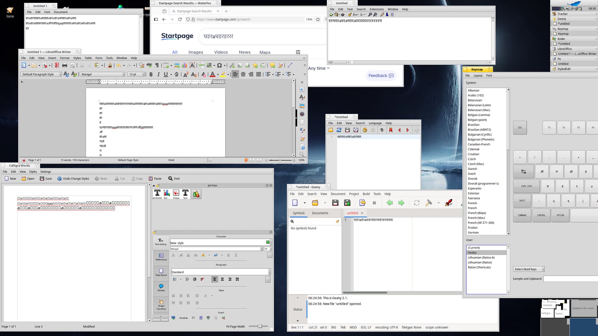

I tried the same:
Everything works as expected.
I see three small letter a and blank square boxes
You are right. I could not get this much characters also
Those empty squares are because I hadn’t yet selected the Mangal font when I was typing those characters. When I selected the StyleEdit Mangal font, Devanagari characters appeared.

For native apps you must select Mangal font manualy, GTK apps seams pickup Mangal font automatically. Calligra Words do not display Mangal characters even when selected Mangal font (some bug? (but the keyboard enters the necessary characters, after copying the typed text into StyleEdit they are displayed)).
Tried QT6 Designer (and Falcon), it also automaticaly pickup Mangal font.

I am not able to sort out the shape shifting issue…That is, the CharacterMap shows one character in Mangal font…when I select it to drag and drop below, it changes immediately…Some other character is shown…due to this, some of my keys are blank…(Y key and some more…) I will make a video and post it here….
