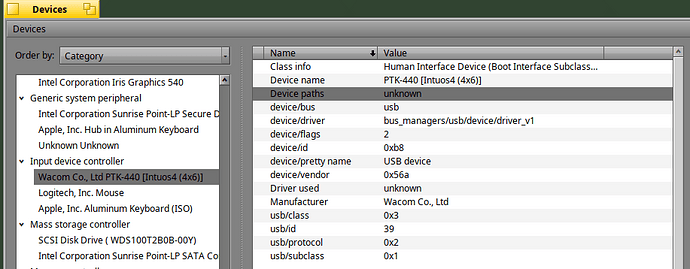

I have the below Wacom tablet recognized in the devices list :
However the pen / tablet is not working under Haiku: what could be missing ?
Note : it’s working fine via MacOS/UTM (qemu)
This is not “recognized”, it is only found. The system has no clue what this device is or what to do with it.
Your next step should be to check out the wacom driver, it has a list of ids to which it will attach, add your device ID to the list and see if this works, you might have to supply additional info like the device dimensions to the driver.
Edit: alternatively if you are not compfortable developing drivers you can open a ticket with the output of listusb -v for this device.

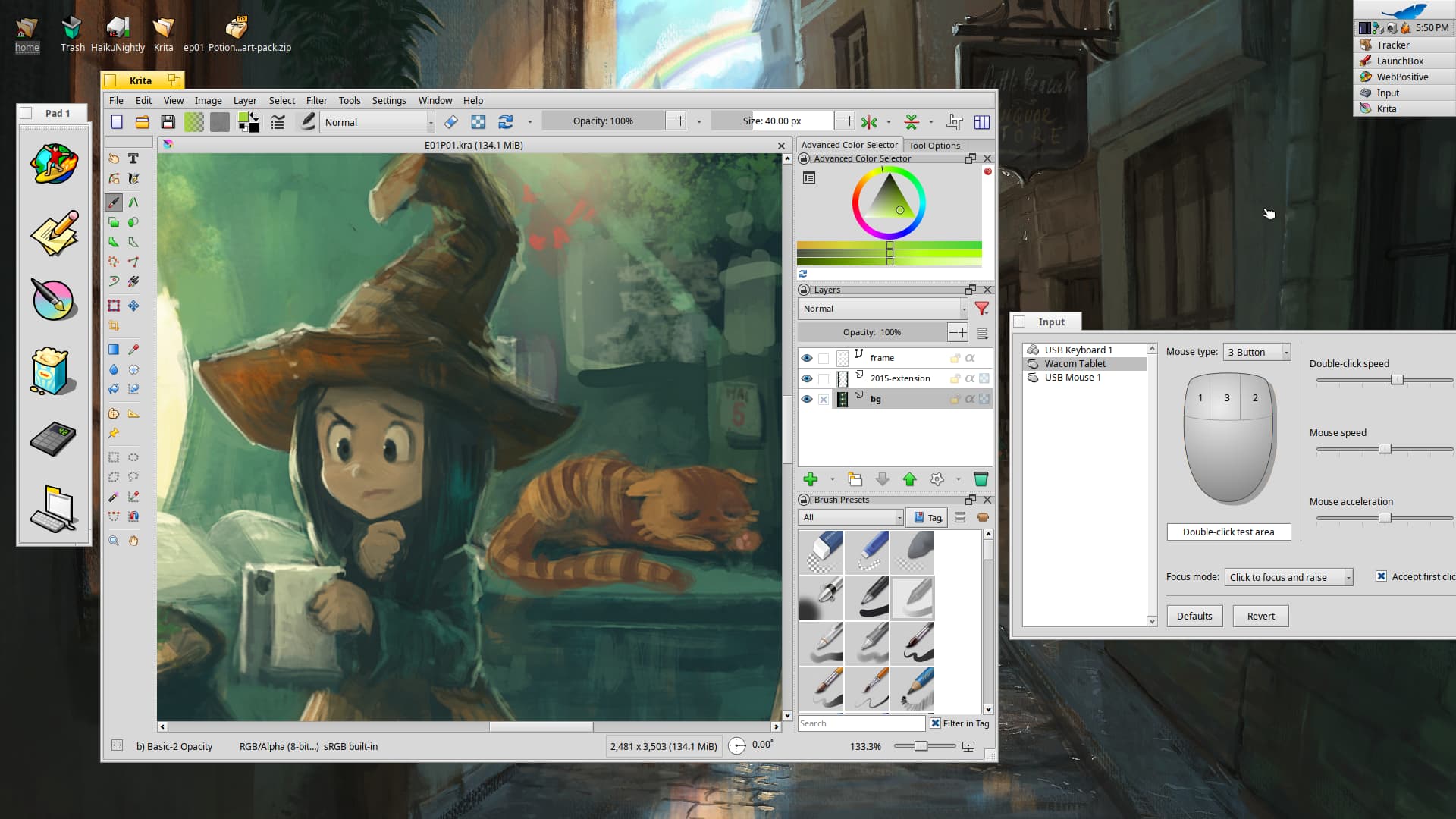

It will be useful with Krita, maybe I will close my own ticket :wink:
Would be nice if you created a post about using Krita (and or any other software) with the Wacom device, makes some good advertising! :slight_smile:
The article about Krita is already written and is currently planned to be published next week :wink:

Wacom Intuos4S and Krita working fine with the basic input handling (3 buttons + pen moves):

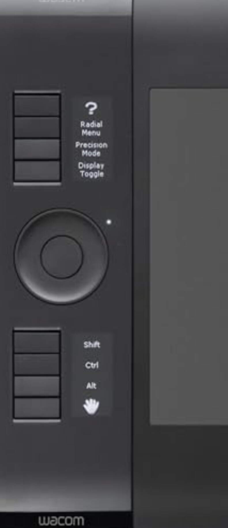

I will try to improve the existing driver (at least for Intuos4) because there are additional buttons available and also a wheel which can be useful to be used as a mouse wheel :
I have seen some code relative to the mouse wheel in the existing driver’s code but not sure yet if / how it’s used.
If anyone has information to share, I’m interested in that :slight_smile:

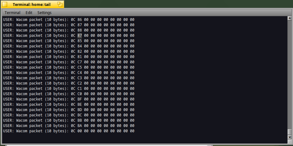

EDIT: first investigations in DeviceReader.cpp:
