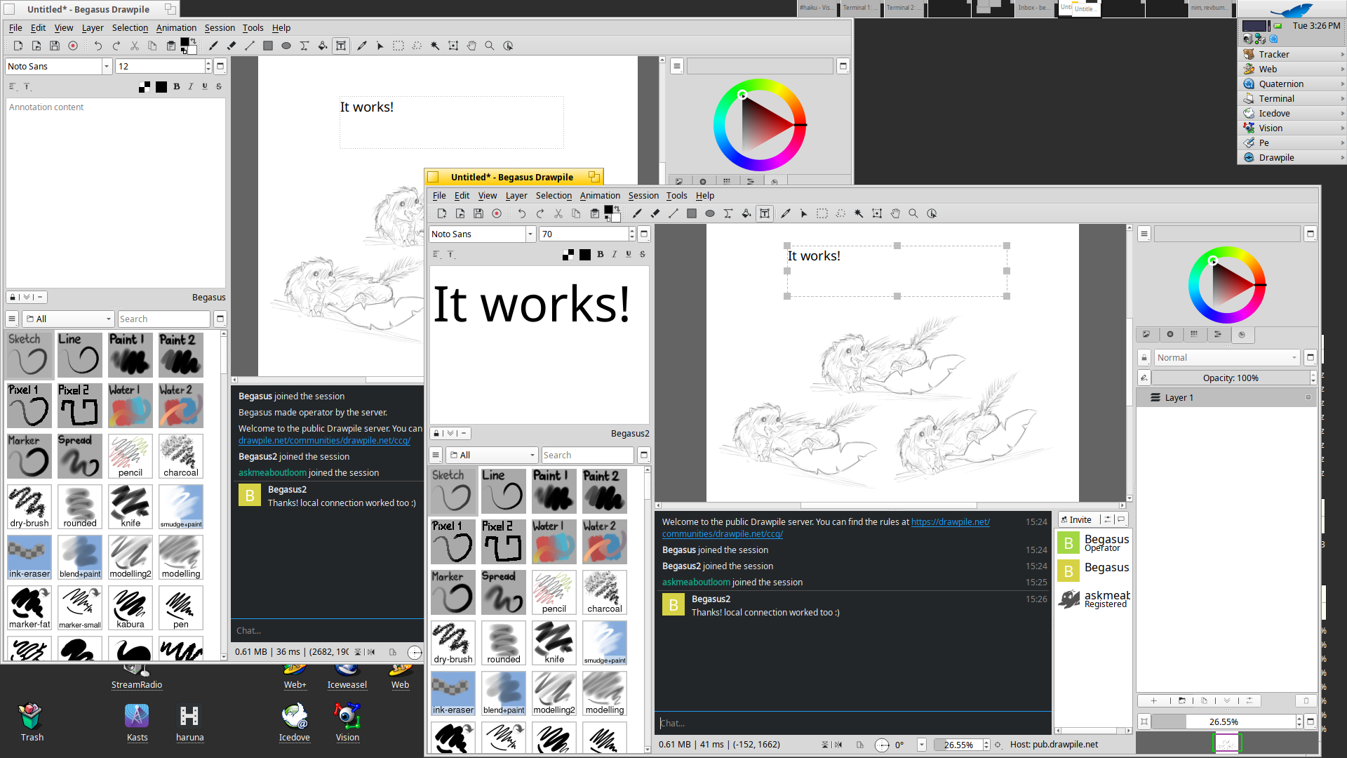

Another player in the feild just got updated, Drawpile, makes it even possible to colaborate in joint sessions. ![]()

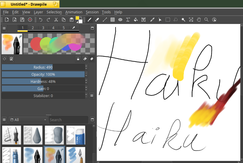

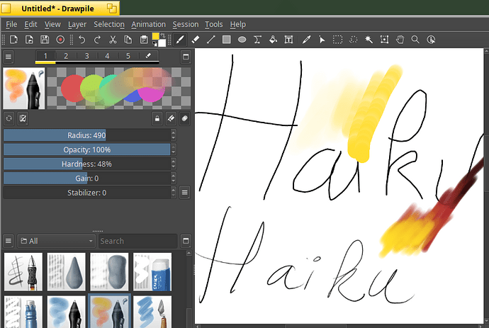

What is nice (like in Krita) is that when the pressure of the pen is strong, it brings a strong line, and when it’s slight, it brings a soft line (meaning the current driver is handling correctly this information).
As far as I know ArtPaint is not handling the pressure of the pen.
Writing the word “Haiku” with the mouse versus the pen under Drawpile:

Was in contact with the main developer from Drawpile when I started on the update (we met in the Krita room on matrix), then he asked to host a session and just a few seconds he stepped in and started drawing, you could see that in real time! ![]()

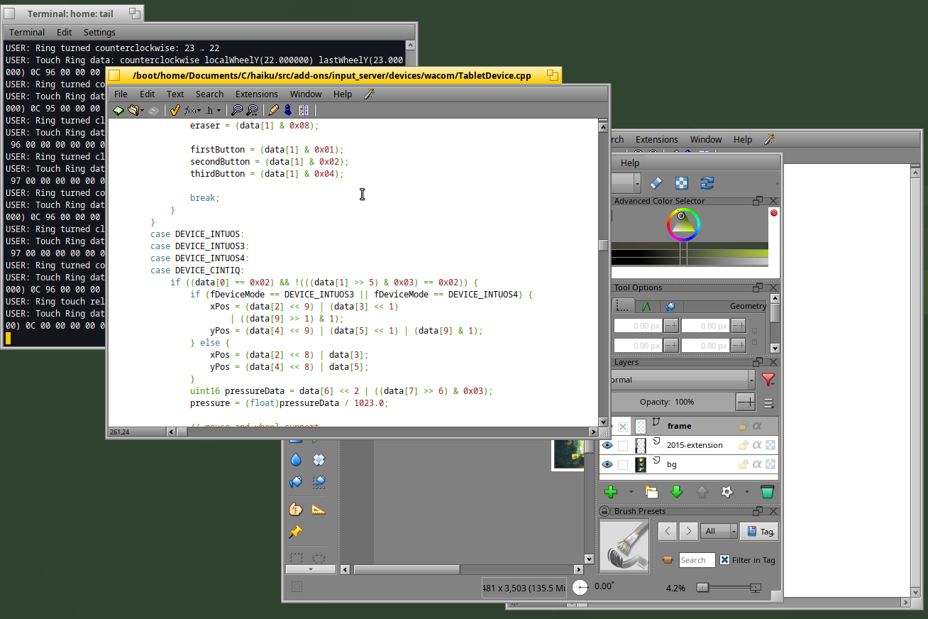

Ok, I’ve got a first version working for the pad wheel on my system and a patch proposal.
To be improved during the review:)
As far as I know it can work for Intuos4 and Intuos5 (this last model is not yet handled in the current code).
