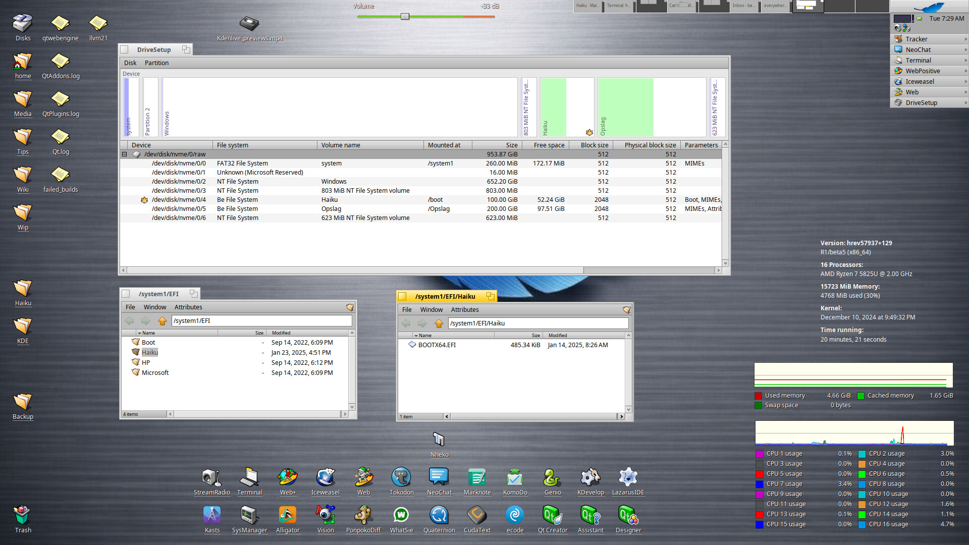

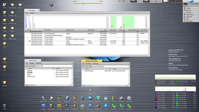

Running Haiku here on a HP laptop 17-cp1010nB just fine, as @brunobastardi mentioned, format the empty partition as BFS and install Haiku there, if the system is using EFI, cp (don’t know how installing EFI file is supported in nightly), cp the efi file from the USB to the EFI partition. Worked out OK here.
