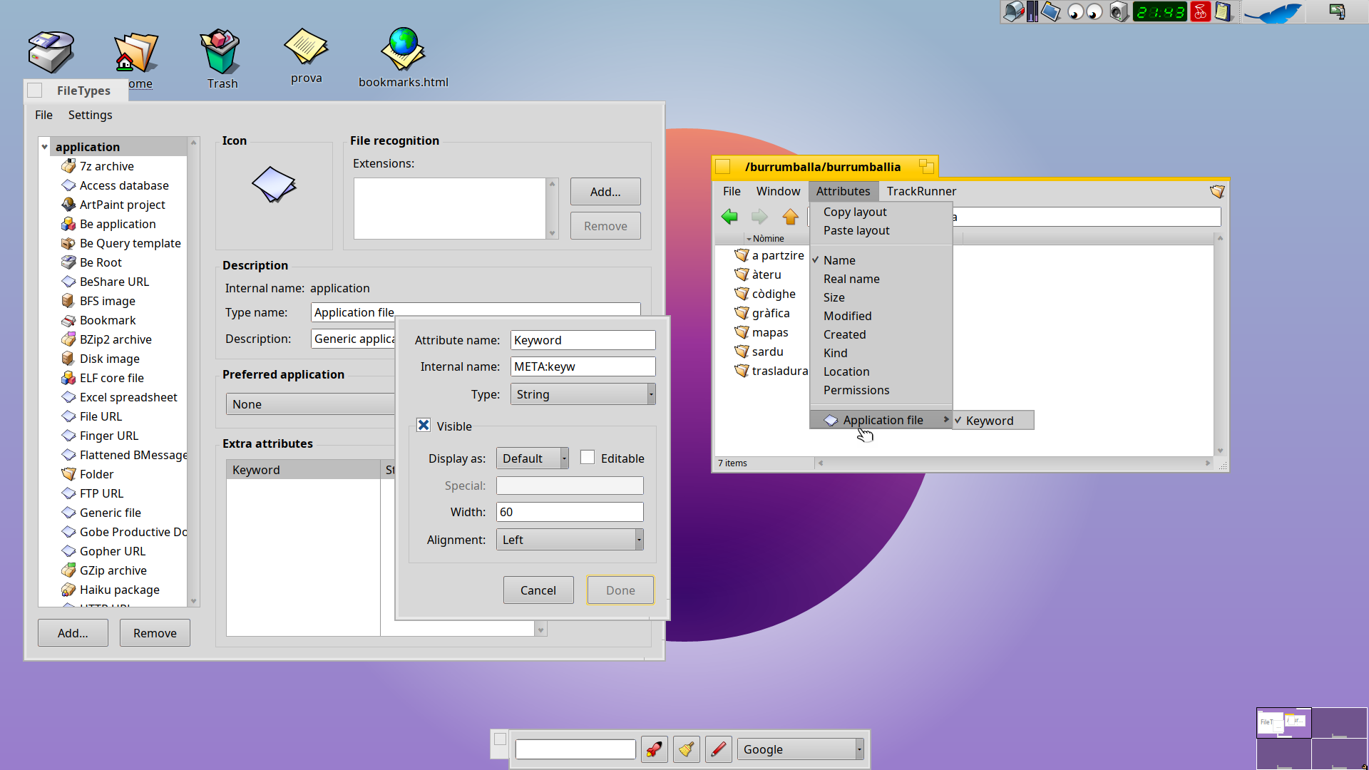

If you want to display your specific attributes in the Tracker , you just need to create a dedicated FileType.
It’s the method I’ve used when investigating the powerful usage of attributes under Haiku
see : Generic people app
Or edit an existing one, of course.

WebPositive already does it, META:url, so if you want to see it , add it to extra attributes of a generic file using file type preflet and showing it in the wanted folder (as written above, this is not applied to every folder, but you can copy+paste the layout) from the attributes menu
adding a new extra attribute to application super type, it will be available for every mimetype in every folder, it can be done for each super type (audio/* has set the standard MEDIA attributes, you can set your preferred extra attributes such Media:label, Media:producer…), or you can create a new, custom, file type, eg a Movie entry for you collection, media/x-mydvd, and set every attribute do you like,year of the movie shoot, year of the Media release, cast, director, light director, sound director, producer, ID, shelf, and if you set them to be editable, you can change their values from the tracker (not the most pleasant way to do, actually)
you can use the UI with filetypes preflet, or setmime cli command
The filetypes are “registered” in the mime_db, and they are a fill attribute aswell.

Tracker will automatically display columns for custom attributes IF they have the “display” attribute set (part of the configuration you set up with the FileTypes preferences app) AND if you select them in the View menu, which can get a bit cumbersome if you have custom file types with a lot of custom attributes…
