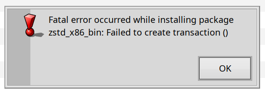

Building Haiku OS 32Bit exceeds inodes limit
Hi there.
For the last couple of days, I am trying to build locally the full OS, 32Bit, inside a VMware VM (Windows 11 host), following the offical documentation. Installed latests nightly (32Bit), Python 3.10, Genio, and others. ./configure (from the terminal), then build (pressed the button from Genio)… And after like 30 mins… “No space left on device”.
Basically, I’ve got no more free inodes (while there is plenty of physical space available). Tried to format with blocksize 1024 (instead of 2048), the same. Tried to attach a different disk, to use it for the build, BFS, same. Tried with EXT4. I gues because of a bug (or something I’ve missed), after reboot, it becomes readonly (despite mounting it explicitly in R/W mode). Same with FAT32, and same with NTFS formatted disk.
So how am I supposed to build the full OS locally? Is there a specific document/page I’ve missed, which describes how to do it the right way? Am I not supposed to build it locally? I guess installing the OS on bare metal (as opposed to a VM), wouldn’t make much difference, as the filesystem would be the same, with the same inodes limitations. Can someone point me please in the right direction?
Thank you.
