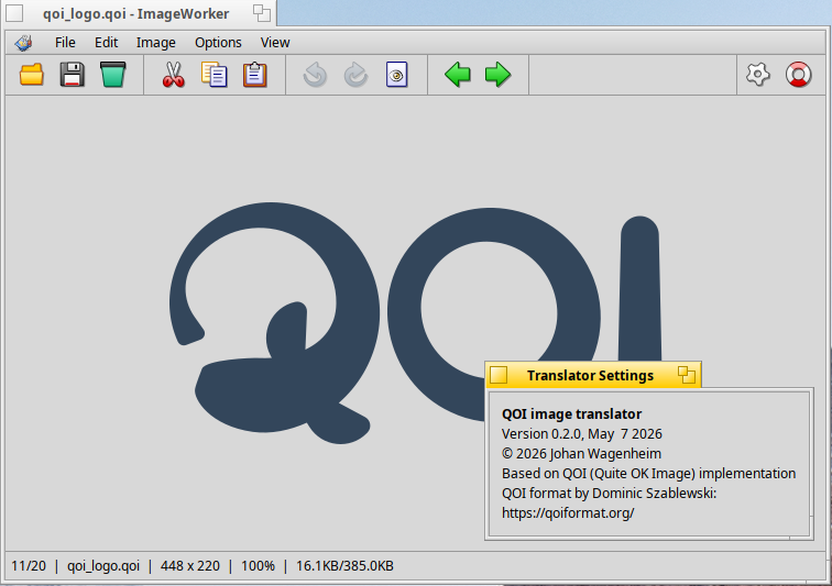

An image translator for QOI images (Quite OK Image) is now available in HaikuDepot. The QOI image format is a lossless image compression similar to PNG, but with much quicker encoding/decoding. The translator supports both reading and writing of QOI images.

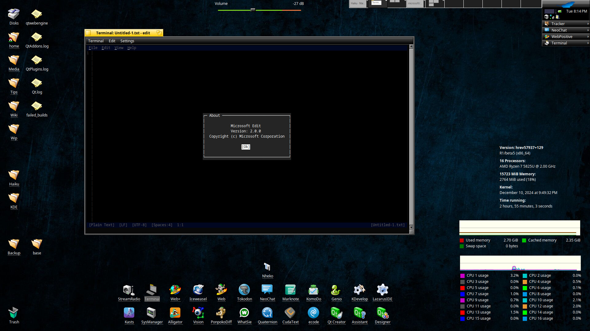

New in the depot: msedit (added from the whishlist)

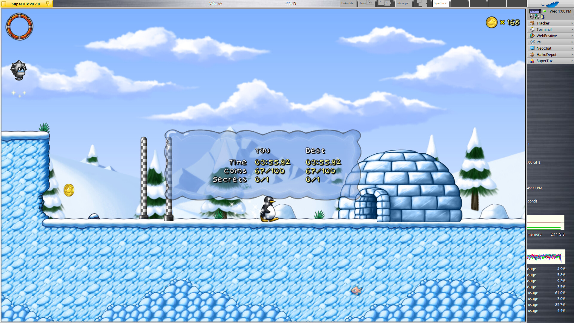

SuperTux 0.7

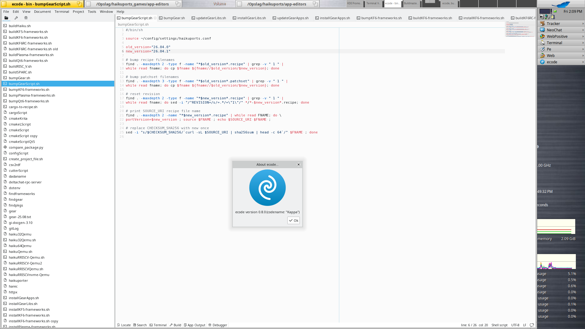

ecode 0.8.0

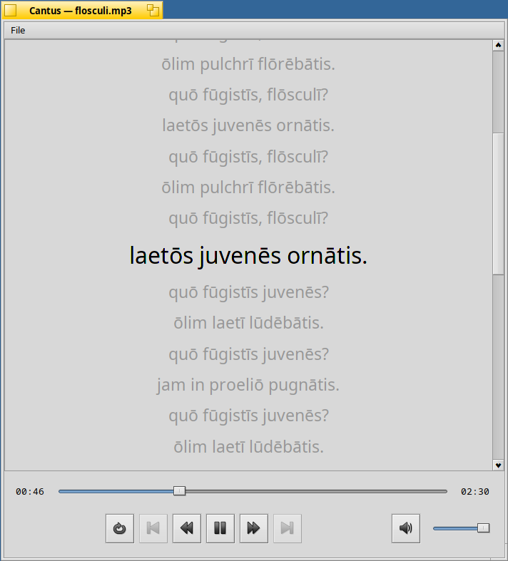

Cantus, a native music player with synced lyrics display, is now on HaikuPorts.
Not marked as native in the HDS. Sorry, I don’t have the privileges to fix that.
