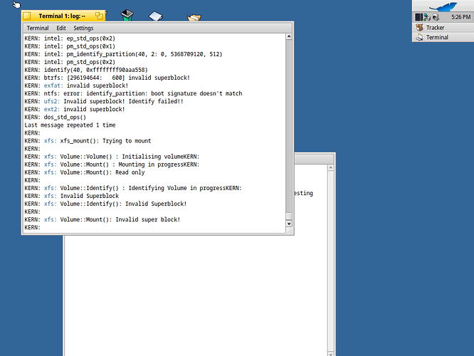

  • The filesystem can only return an error code to the mount command. In this case, EINVAL or “invalid argument”. This isn’t very helpful, of course, but you will usually find more information in the syslog (/var/log/syslog). So, you can look here. Of course, this will be more useful if your filesystem is built with tracing enabled. For that, you can configure it if you are building Haiku from the build/jam/UserBuildConfig file:
    SetConfigVar DEBUG : HAIKU_TOP src add-ons kernel file_systems xfs : 1 : global ;
(as usual in jamfiles, be careful about not removing any of the whitespace, otherwise it won’t work). After doing that and building your Haiku image, you will get all the debugging and tracing from the XFS driver. Make sure the driver is properly installed as well (I think it should be in /boot/system/add-ons/kernel/file_systems)

Check more closely the content of the file, for example with an hex editor. Is it empty? Does it contain some data? Does the data look like a valid XFS filesystem (for example, can you find the superblock magic number)?
Also try what I suggested: build XFS in debug mode so you get all the traces, and check the syslog in /var/log/syslog after running the mount command. Do you see any logs from the XFS driver there? What does it say?
Finally had the error actually the filesystem image wasn’t a valid one. I looked into the /var/log/syslog with the debug enabled and it Traces the error which is Invalid SuperBlock.I have tried some experimenting within my Linux environment.

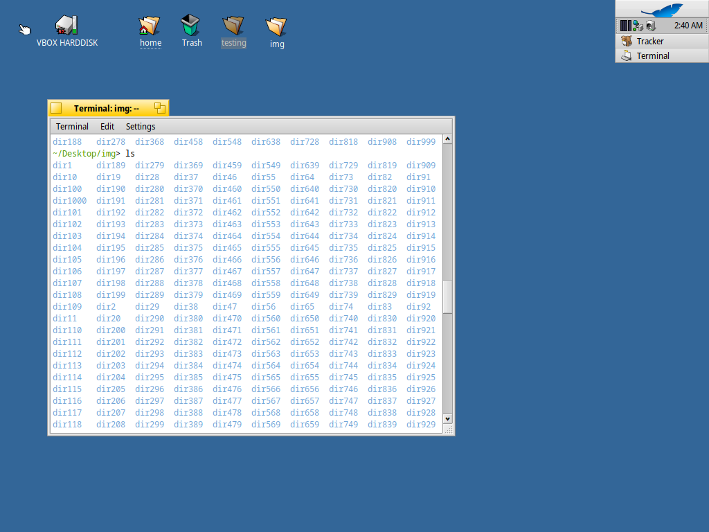

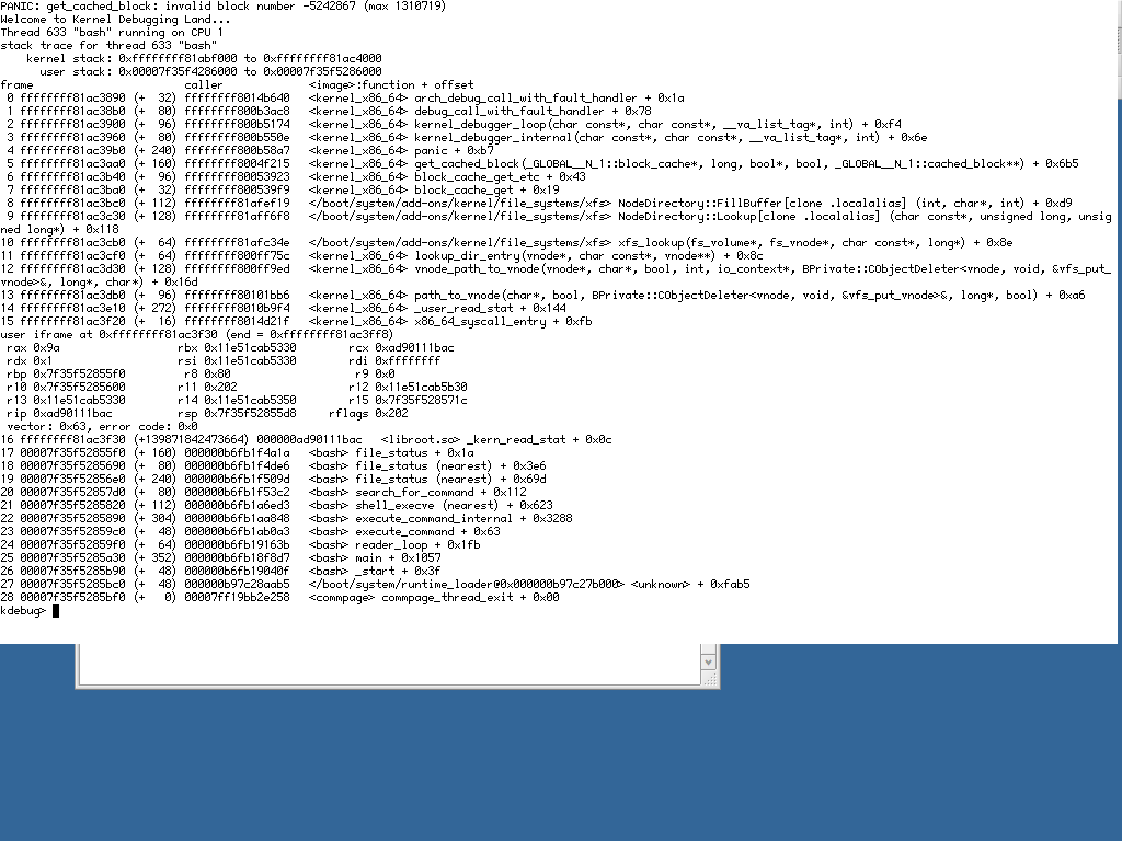

I have attached the xfs image as a disk while running Haiku on the virtual machine and after lots of attempts successfully mounting it to the testing point. There is a little anomaly in the behavior.
  1. I can’t see any GUI representation of my Directories in the testing point which is the testing directory in my case.
  2. While listing the Directories from Terminal using ls command I got up into Kernel Debug mode and the reason is the BlocK no seems to take a negative value in the block_cache_get() method (probably due to endianness) but it’s working fine inside xfs_shell can you tell me what should be done here.
  3. After exiting from kernel Debug mode all the 1000 directories are listed properly, How?
    Relevant Screenshots from the issue-
I’m not sure what you mean. The “img” directory seems to be there on the desktop in your screenshot?

block_cache_get will return an error code, depending on how it is handled in NodeDirectory::FillBuffer, execution can continue normally, handle the error, and still manage to access the disk in some other ways.
You have to check the code in NodeDirectory::FillBuffer carefully to see how it ends up passing invalid values to block_cache_get. In the kernel debugger you can use the “syslog” command to see the last entries in the syslog, just before the crash, this should give you some idea of where the problem happened. Of course, if needed you can add even more logs to trace it better.
That’s a known issue from the previous GSoc, currently the directories don’t show up in tracker, the author created a ticket for it, something you might consider fixing if time permits?;
