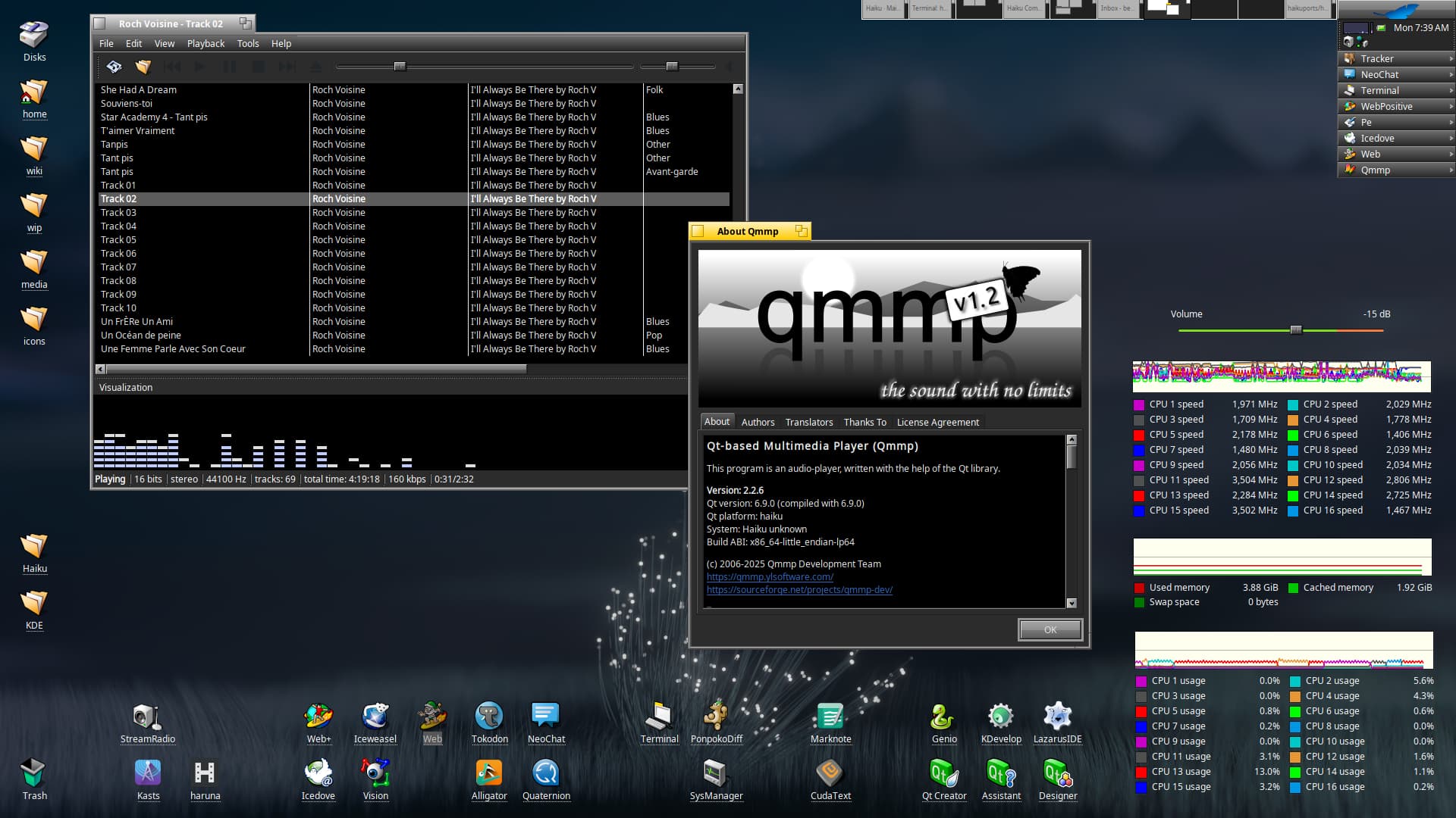

So far it looks OK, not sure if anything else needs patching @3dEyes ?
If everything works, then for why?
No downside noticed and patchset still applies clean, will push to haikuports. :slight_smile:

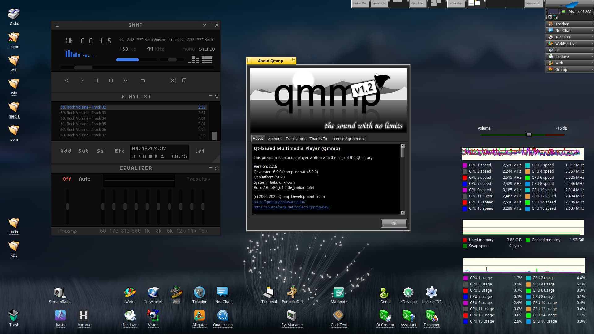

It still cann’t drag and drop.I need to press the ctrl+alt to move the window.
Not sure what you mean by that, I can drag the individual windows when in skinned mode around seperatly or combined when the main one is attatched to any or all 3 windows?
On the translations, I see ZH_TW in the list, if it’s complete or not I don’t know.
I have checked with the main developer before the 2.2.6 is out,on windows,it is 95% completed,works fine.Now fine on haiku too.
BTW you can see my name on the translator list.
No I can’t,I am using haiku on QEMU.I need to press the ctrl+alt to drag it.
Confirmed, but this seems a beta vs nightly thing? On bare metal with beta5 it works fine, on (qemu) nightly I also need to hold Ctrl before I can drag around, will run a check on a bare metal install with nightly later today.
Yes,I am using nightly build.
