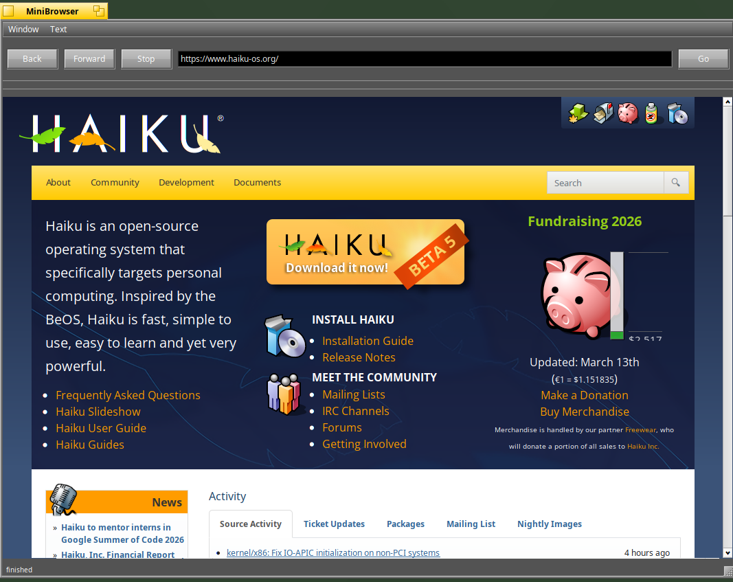

BTW crash when quitting MiniBrowser is identified and should be fixed soon :stuck_out_tongue:
MiniBrowser : no more crash on exit, back and forward :slight_smile:

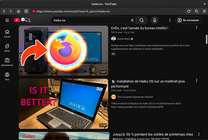

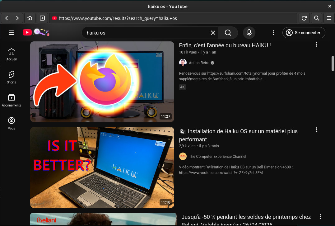

EDIT: MiniBrowser compiled and running on Debian : reading videos & co.
It means we could have a nice MiniBrowser using WebKit2 on Haiku, just a matter of time:)
