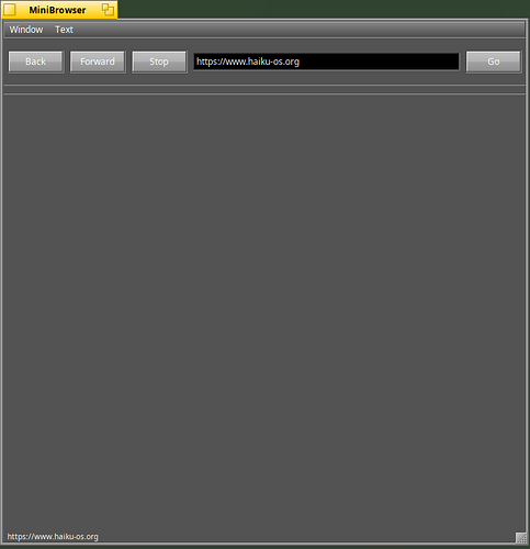

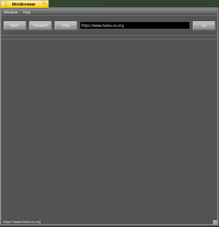

Is it needed to be on Haiku nightly version to have minibrowser working? on my system (which is on R1B5) the browser is opening an empty window, but there’s no site browsing when putting an URL.
You have to enter an exact url (with the http:// or https:// prefix) and then press the button next to the address bar. It’s not even as good as HaikuLauncher (the WebKitLegacy equivalent), it’s just barely good enough for testing the web engine.
I have done that I think by pressing the ā€œGoā€: the URL is displayed in the bottom status bar, but nothing more happens.

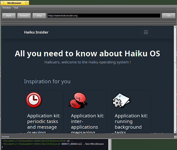

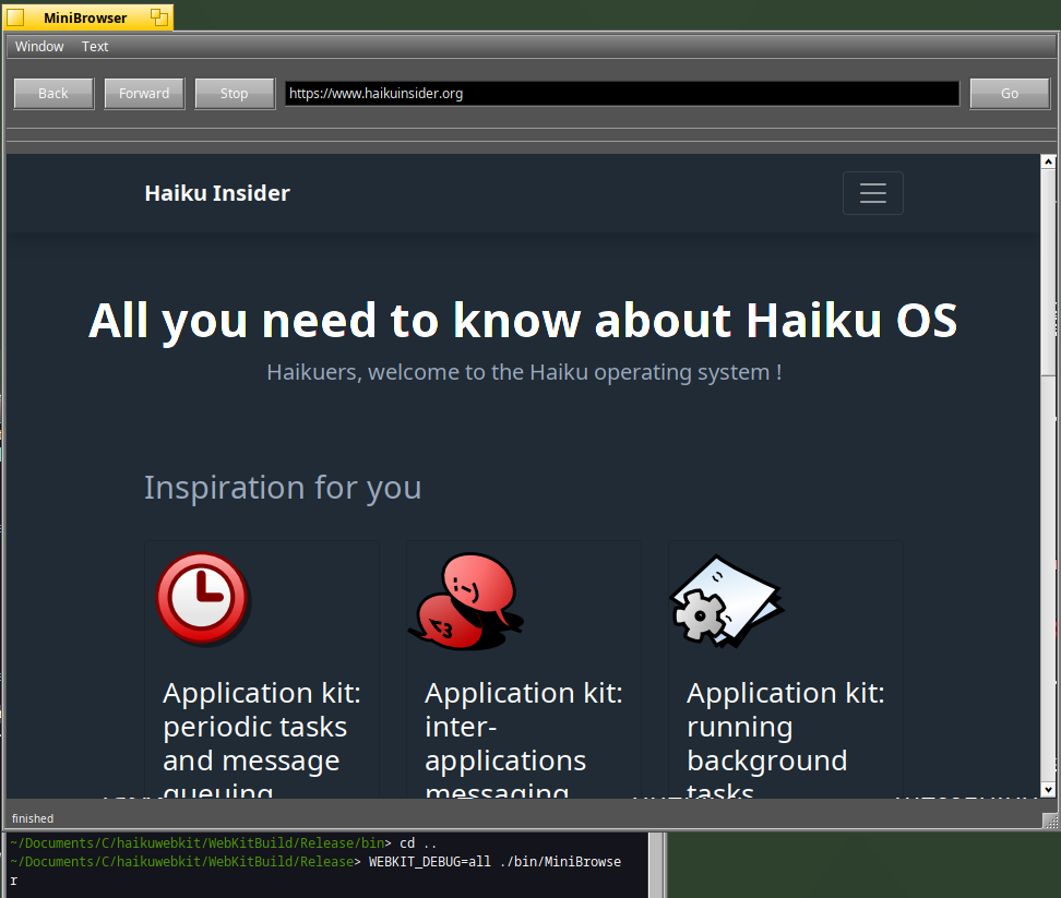

After analyzing the log details with devconsole tool, I’ve found the reason : MiniBrowser expect to have a ā€œbinā€ directory in the current directory to launch ā€œWebProcessā€ :
application/x-vnd.lh-MiniBrowser | failed to start process ./bin/WebProcess, error No such file or directory
Until this is fixed, the workaround is to launch MiniBrowser not from its current directory but from the upper one : working fine :slight_smile:
./bin/MiniBrowser

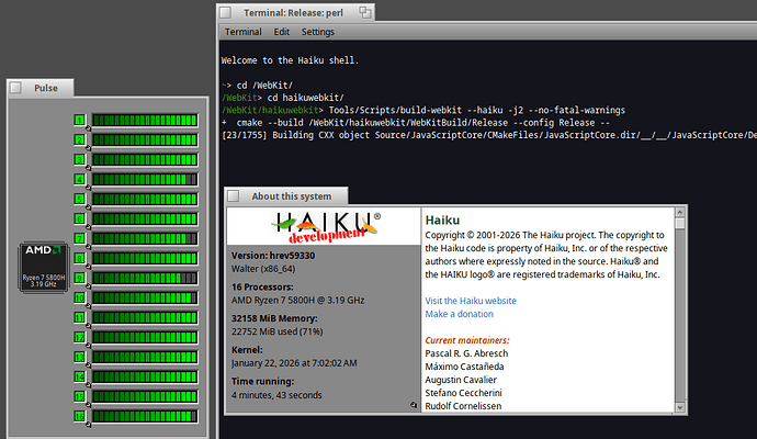

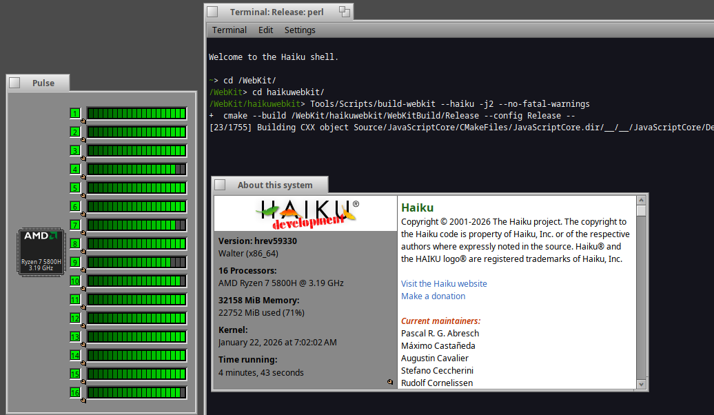

I have moved the 32 Gb of RAM from my NUC to my Windows laptop :slight_smile:
The setup for compilation should now be better : Haiku on USB memory stick for booting + external USB drive containing webkit repo for compilation + 32 Gb of memory :
I will try to make a metrics from the beginning as this one was initially compiled with 16 Gb where it was stuck at some point and restarted with 32 Gb :slight_smile:
