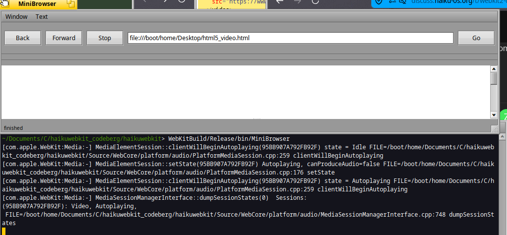

I can see the below messages, so it seems something is happening:
In the current WebPositive version, I have a blank page without any message.

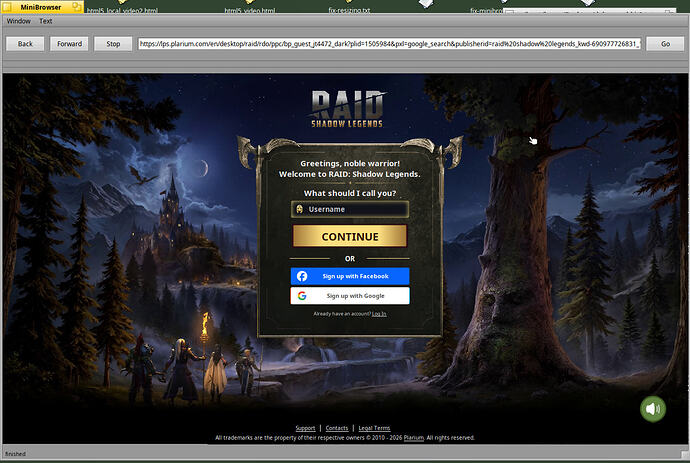

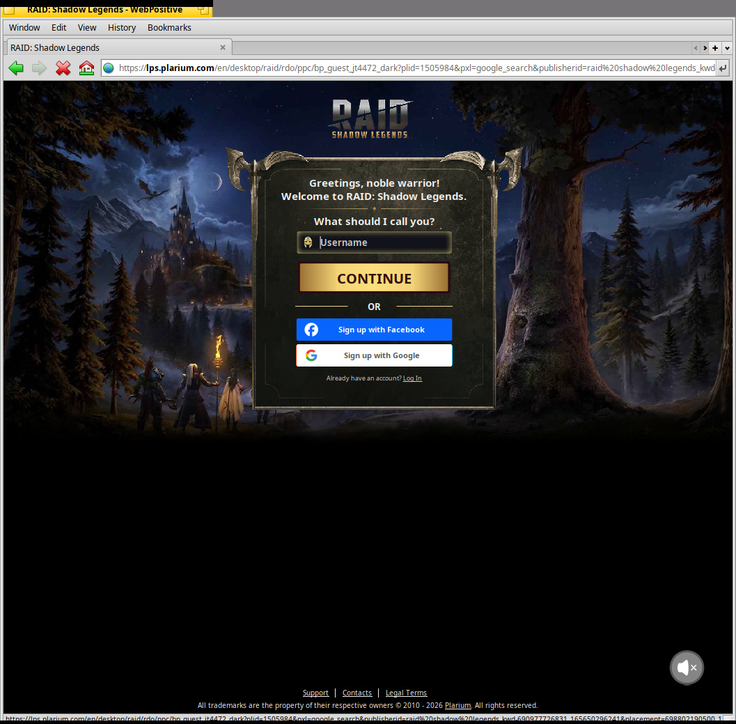

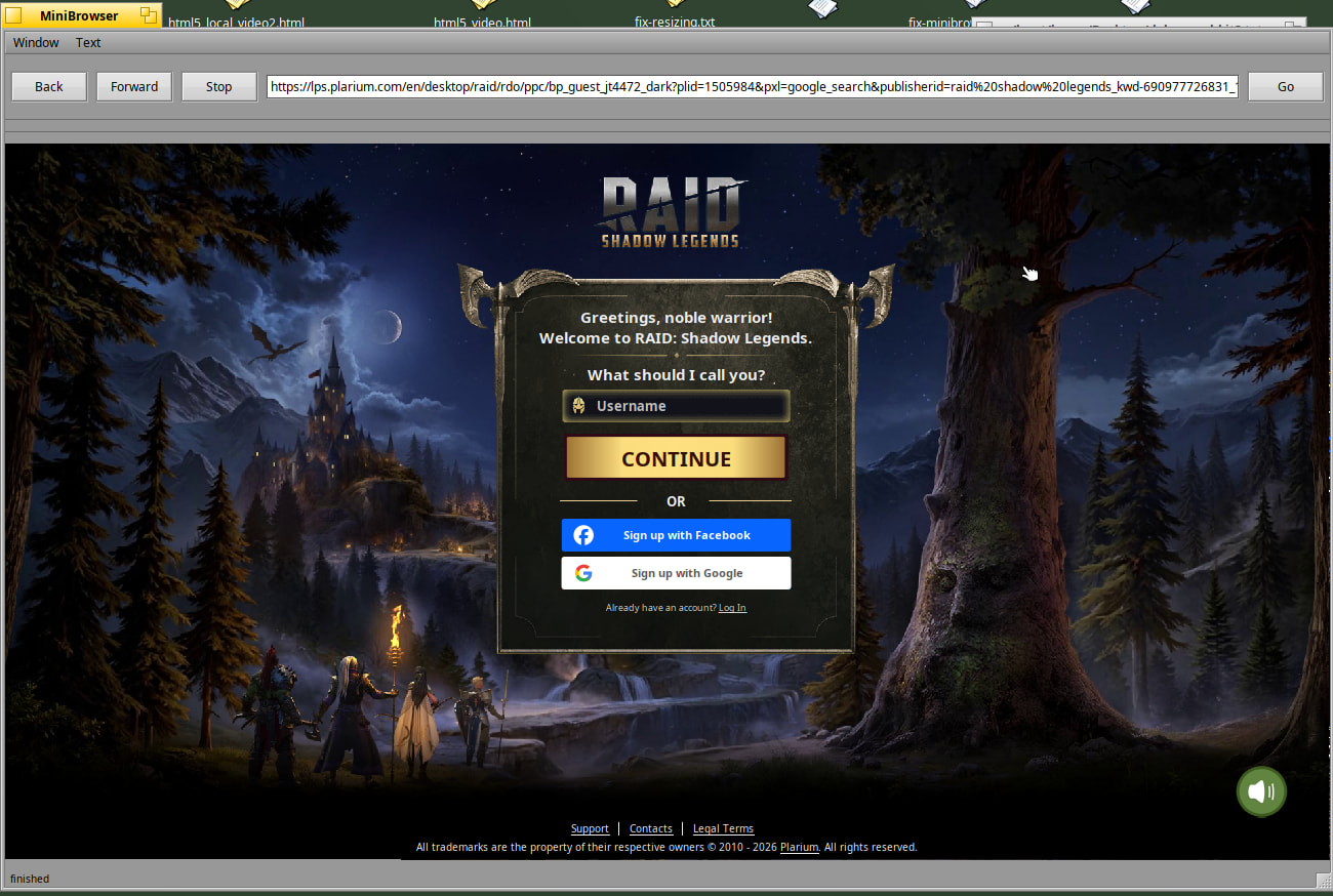

@DigitalBox - any beta testing with websites like this one:
MiniBrowser is at the beginning in term of stability, so the most probable scenario is that it will crash (I can check however)
What about Iceweasel which is in a stable version ?
Iceweasel shows the animations of the webpage. Possibly, this is disabled during the HaikuWebKit build.
The main page is working with the sound (on/off is possible with the green button on the page).
The animation is only played once.
A no crash on this page, maybe it’s a good sign :wink:

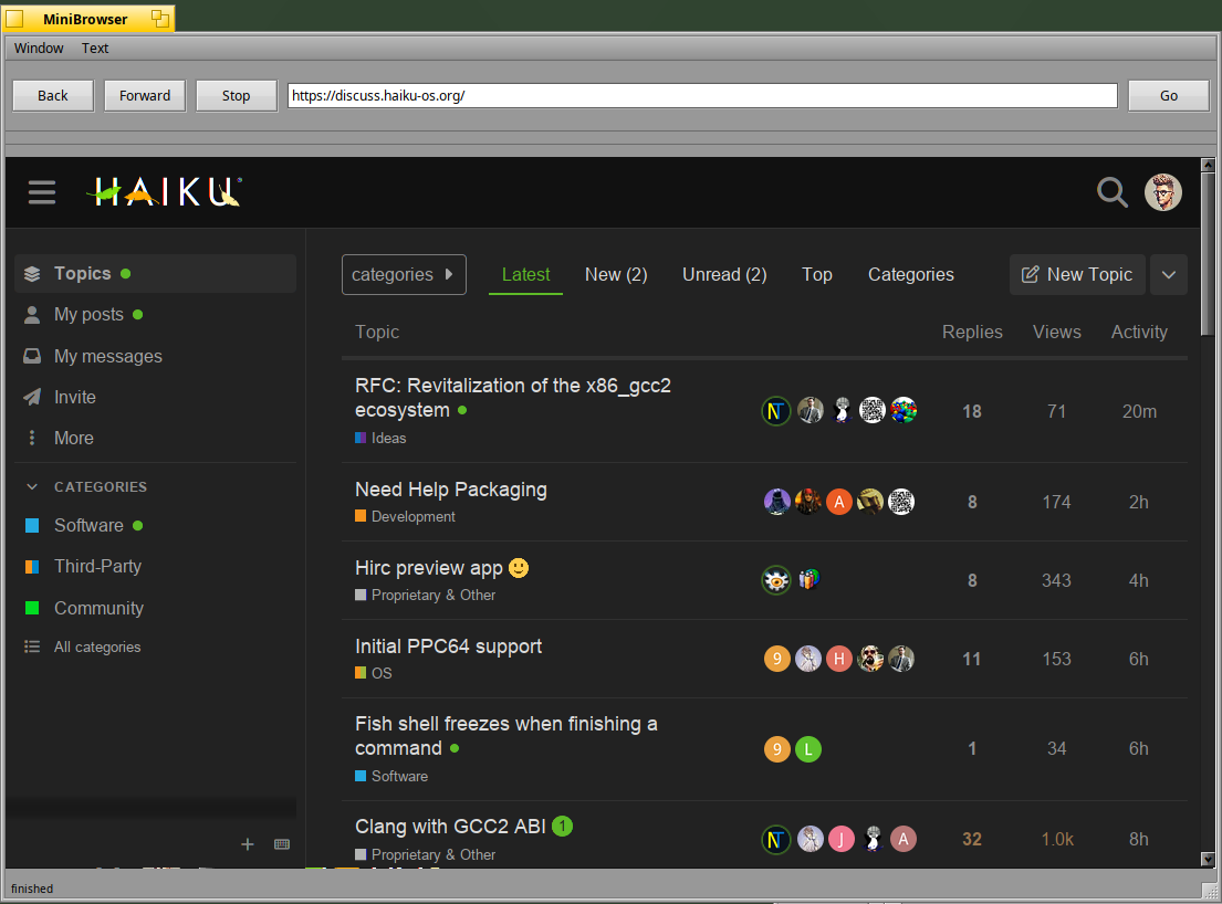

Accessing this forum and posting this screenshot from MiniBrowser/WebKit2 now : )
