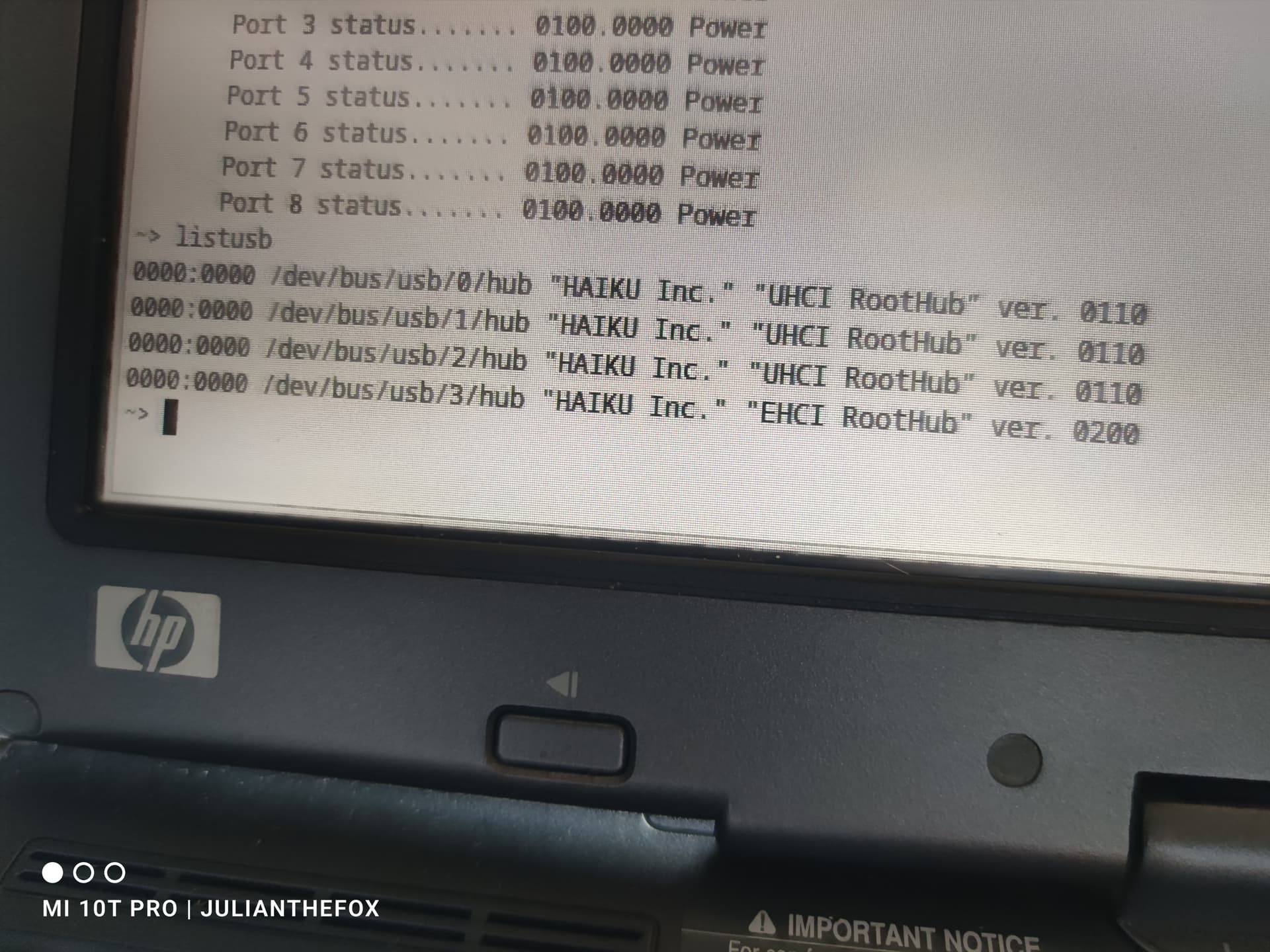

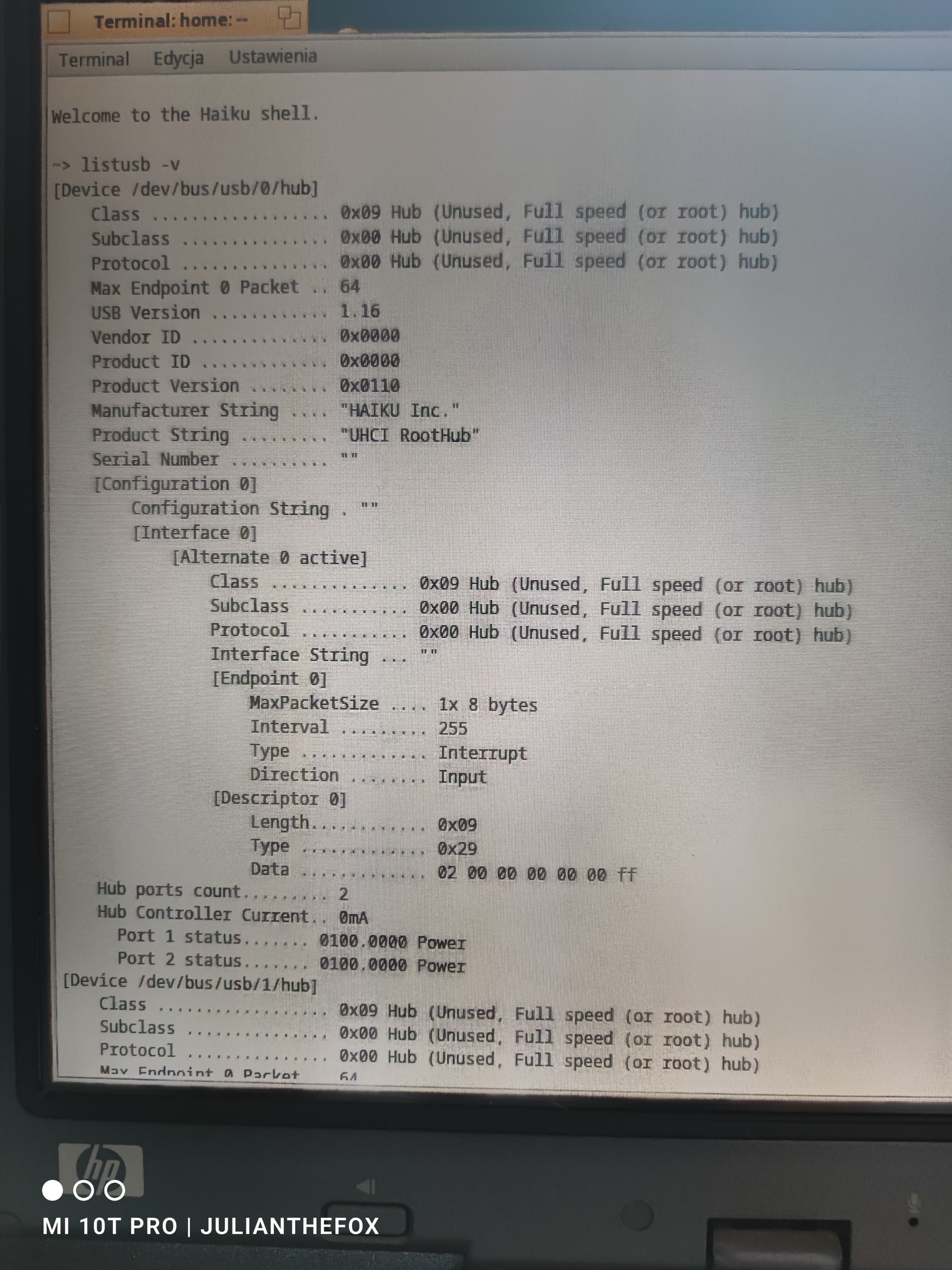

Do you know how this digitizer is connected? Is it USB or something else? Do you see it in listusb for example? In that case, the output of listusb -v could be useful, as well as the HID reports for the device (they are stored in /tmp automatically if the USB HID driver has detected the device).

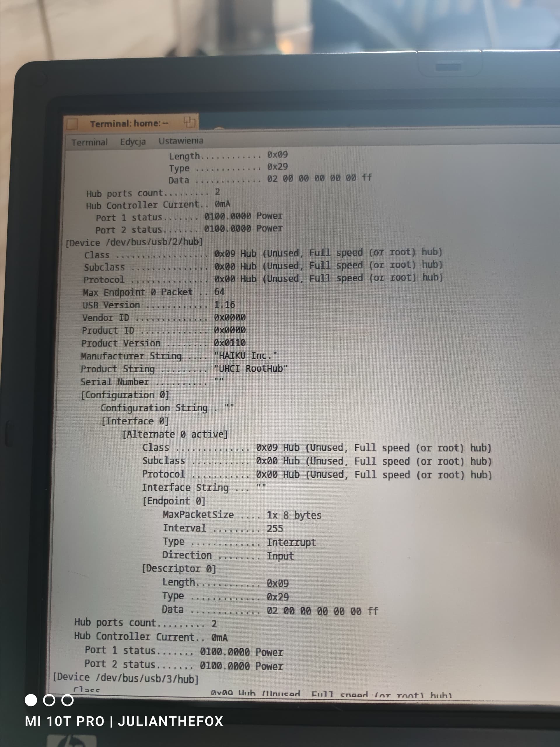

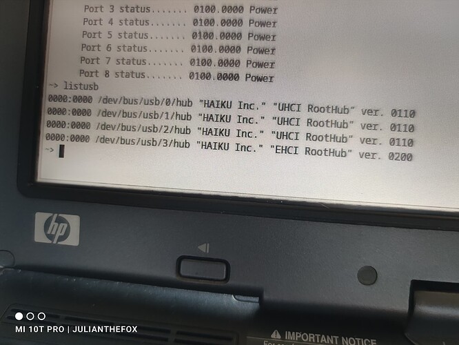

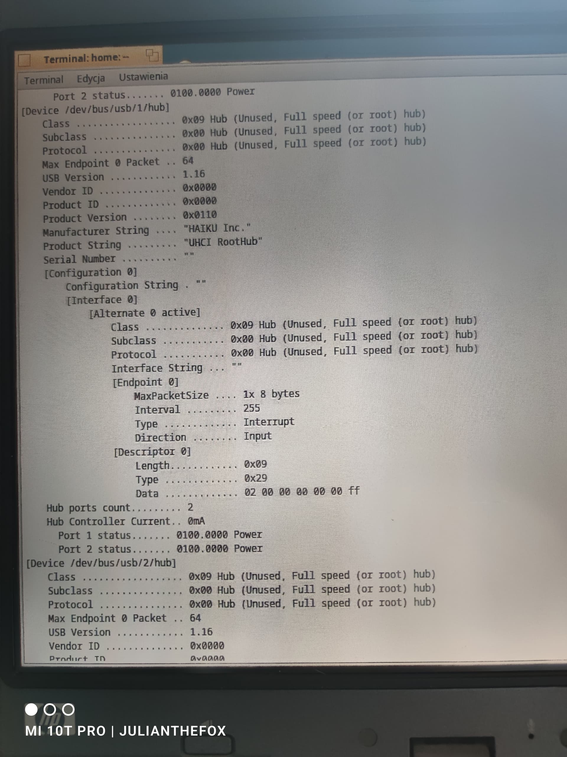

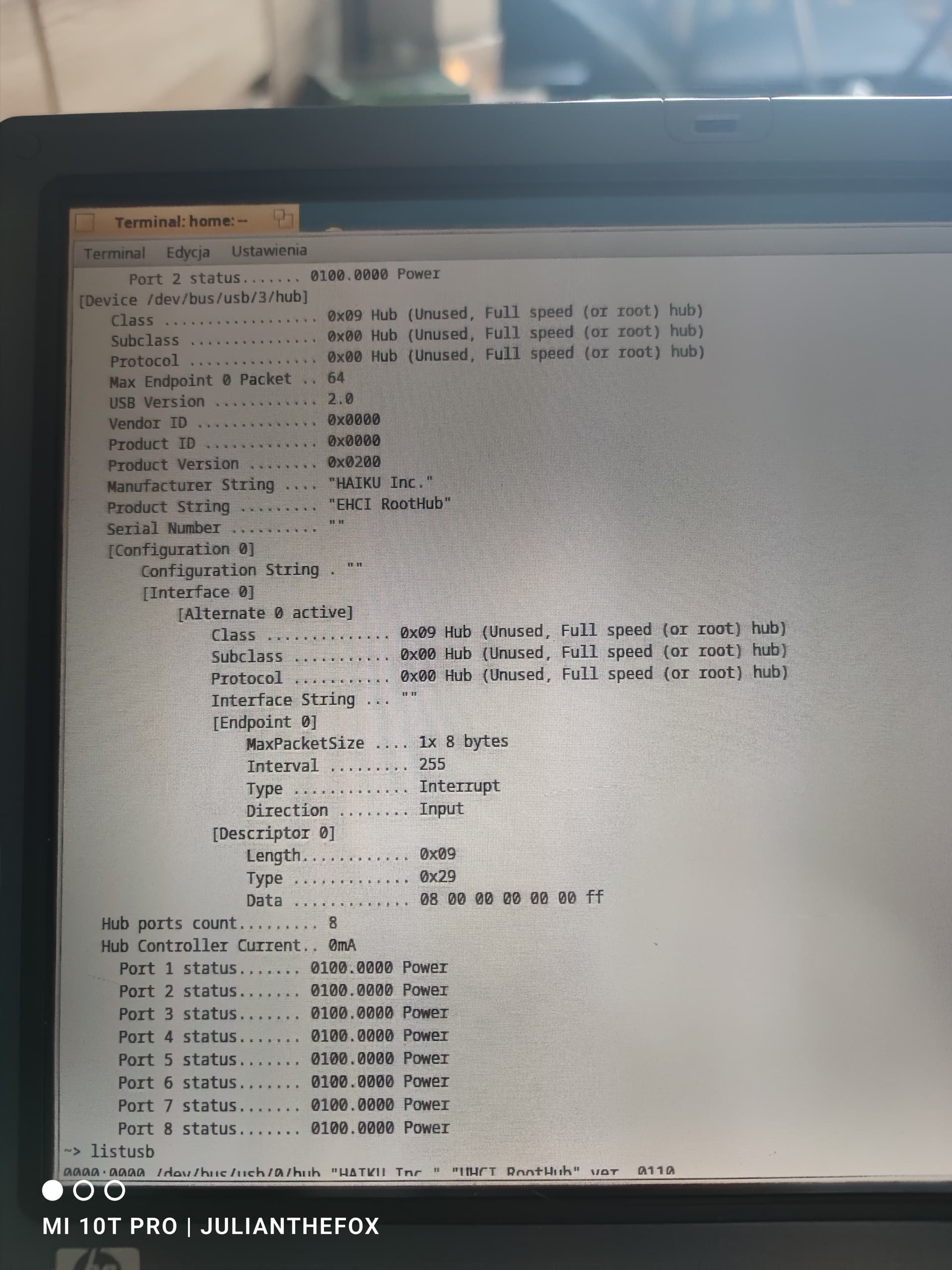

Well, I don’t know how to read this. I’ll just send the pics of the output

There is nothing visible on USB except the motherboard USB ports. So that digitizer is connected in some other way and will probably need a special driver. Maybe it is PS/2 or some custom protocol.
