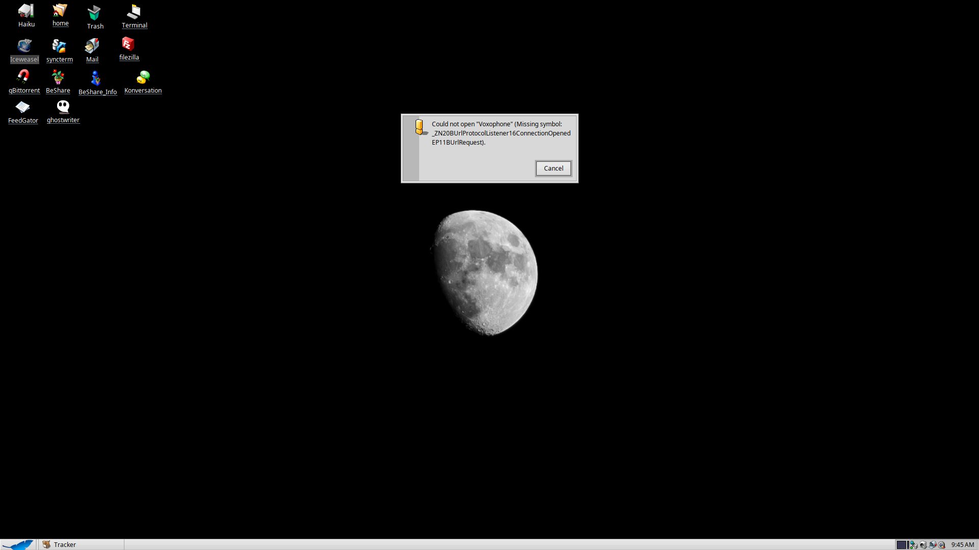

Voxophone is not working
everytime I start the app, this box pops up
That’s a missing symbol, probably from a missing library

~> Voxophone
runtime_loader: /boot/system/apps/Voxophone: Could not resolve symbol '_ZN20BUrlProtocolListener16ConnectionOpenedEP11BUrlRequest'
resolve symbol "_ZN20BUrlProtocolListener16ConnectionOpenedEP11BUrlRequest" returned: -2147478780
runtime_loader: /boot/system/apps/Voxophone: Troubles relocating: Symbol not found
~> c++filt _ZN20BUrlProtocolListener16ConnectionOpenedEP11BUrlRequest
BUrlProtocolListener::ConnectionOpened(BUrlRequest*)
oh sorry my heads not working today
That’s a private API that was inadvertently published in objects that didn’t ask for it some time ago. The solution to that had consequencies, as some programs used it through libraries that should not publish it. The fix is to add libshared in the correct place while linking. But then maybe Voxophone is not worth the effort.
