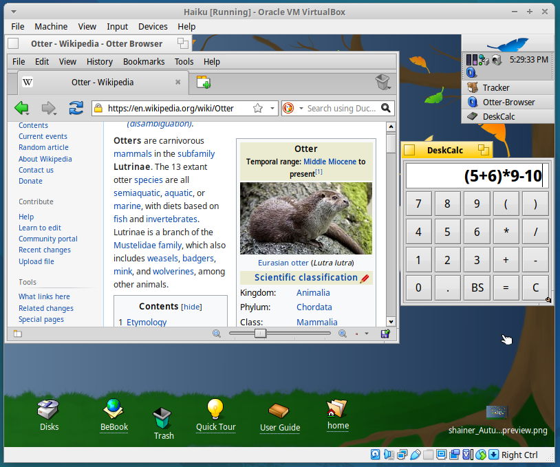

VirtualBox should be more than enough for any of your virtualizing needs on a relatively slow machine. At least it worked on mine (see My PC specs below).
I did a little 3-step followup-guide for the main, official one.
When in already installed Haiku, open the “VirtualMemory” in “Deskbar → Preferences”
Uncheck the “Automatic swap management” option and do a swapfile sized like your VM’s RAM or even double it
The steps 2 and 3 should prevent your Haiku from freezing when doing some bigger actions than staring at your desktop. At least it prevented that in my case, which you can check below and compare to yours.

QEMU didn’t work for me at all (libvirtd didn’t load, not by systemctl and not even manually), but VirtualBox did. Not without additional configuration, of course.
Uncheck the “Automatic swap management” option and do a swapfile sized like your VM’s RAM or even double.
The options 2 and 3 should prevent your Haiku from freezing when doing some actions bigger than just staring at your desktop. I think these steps should be included in the guide as Additionals (or at least Troubleshooting)
