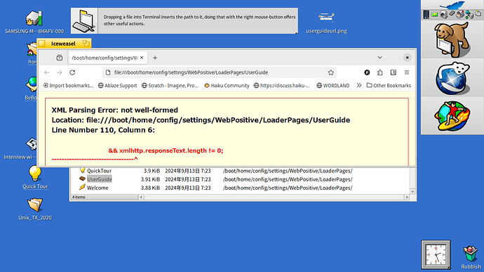

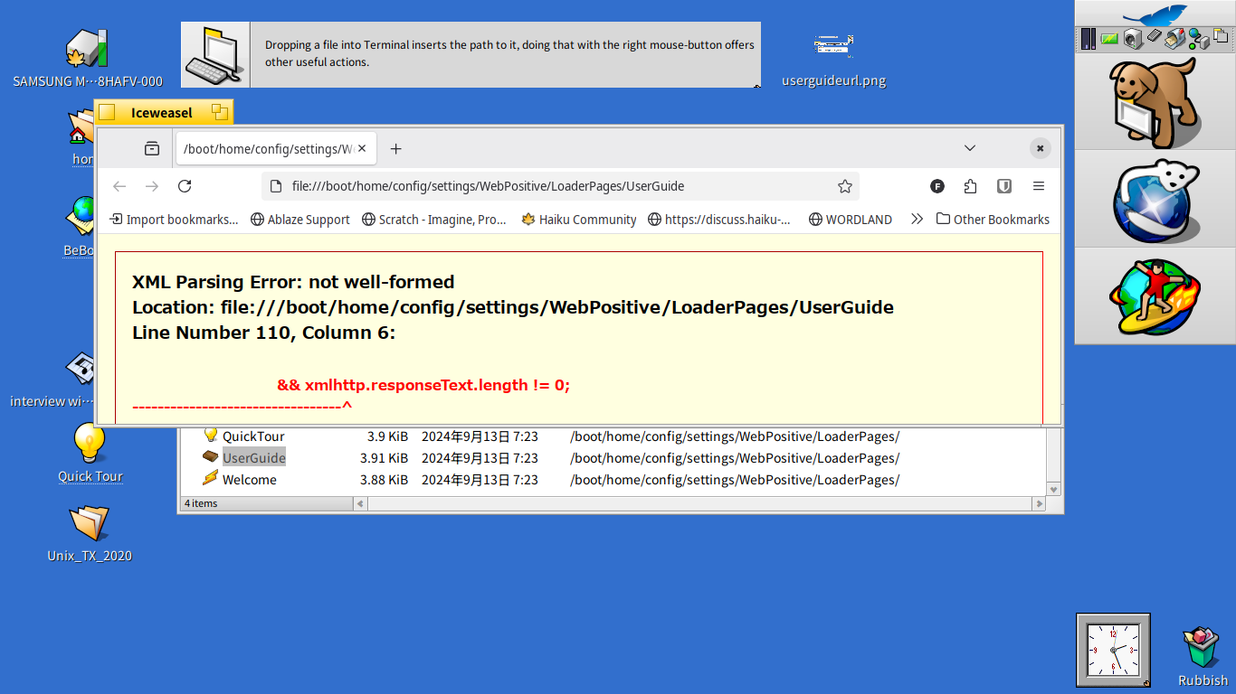

XML validators agree that there’s something wrong with line 110: && xmlhttp.responseText.length != 0; but I have no idea what it may be…
& should be replaced by & if this is declared as an xhtml file (which is what an xml validator would check). Maybe also have a look at the javascript debug console in these other browsers when loading that file, and see if there are any complaints there?
I assume the forum software interferred with your post. Replacing the double-& with a single & doesn’t make a difference. LibreWolf’s web tools doesn’t give more hints than the “XML Parsing Error: not well-formed”.
Fixed the post to show what I wrote and not something else…
That fixes it indeed… Preparing patch. Thanks!
