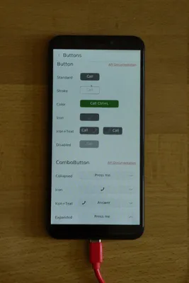

There are screenshots of the user interface for Pinephone in the latest Genode release notes (about half way down).

The first post of the new year from Genodians goes into how their user interface is designed to encourage and assist the user to do precisely that.
Essentially there is always access to what the author calls the “appliance” side shown to the left in the picture from the “user defined” side on the right.
Perhaps this shows how a Haiku user land built on Genode underpinnings might look in practice? I am thinking Haiku may happily live on the “user defined” side - without needing to change from being a single user OS - and the Genode “appliance” always available to set permissions and security.
