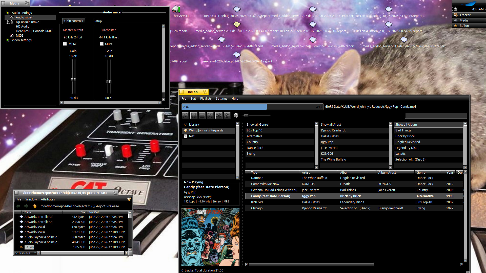

I just got friendly_name enabled on usb_audio, instead of calling everything USB Audio. Below you can see both the Hercules RMX and RMX2 connected to the machine.
