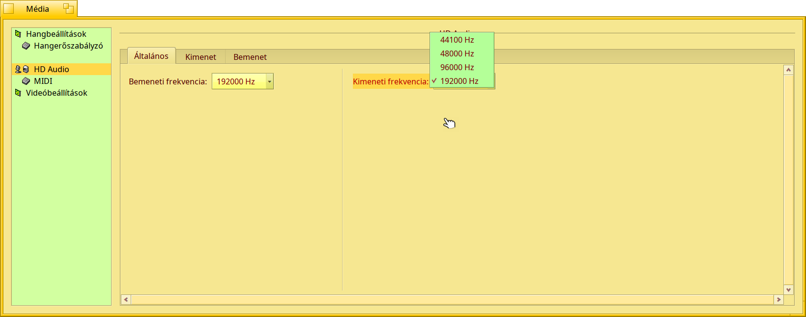

  1. Intel HD Multi Audio chip/codec solution – this is really the full featured SoundCard in my laptop – 192 kHz max sample rate (41400, 48000,96000,192000 appears in Haiku as selectable). At least until I had not moved to hrev59825 that unfortunately reduced all to 48000 kHz.
Before hrev59825 - it was the one and only HW audio resource there as selectable as HD Audio.
As I moved to hrev59825 what I anticipated to move when I saw the patch on CGIT – there were 3 identical HD Audio after the empty line -so I tried out all one-by-one.

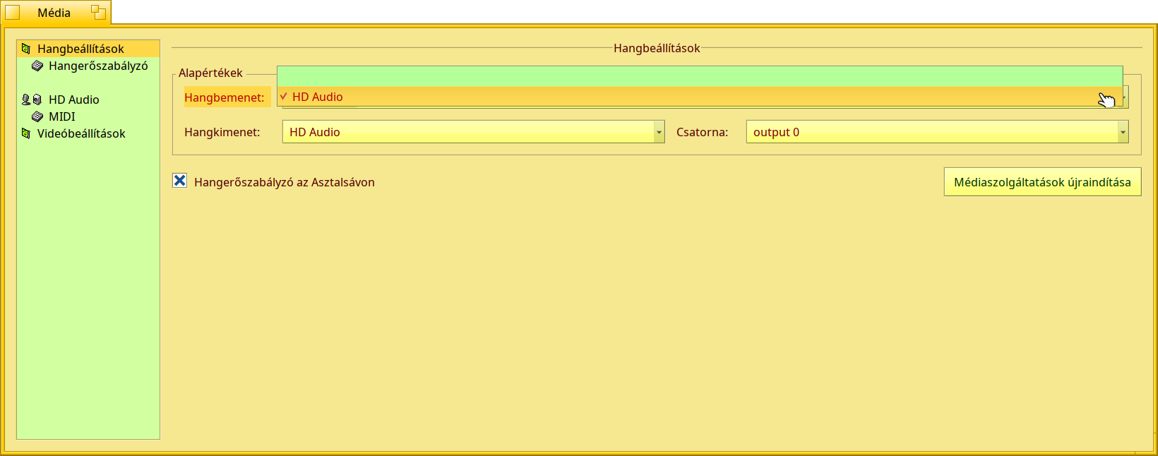

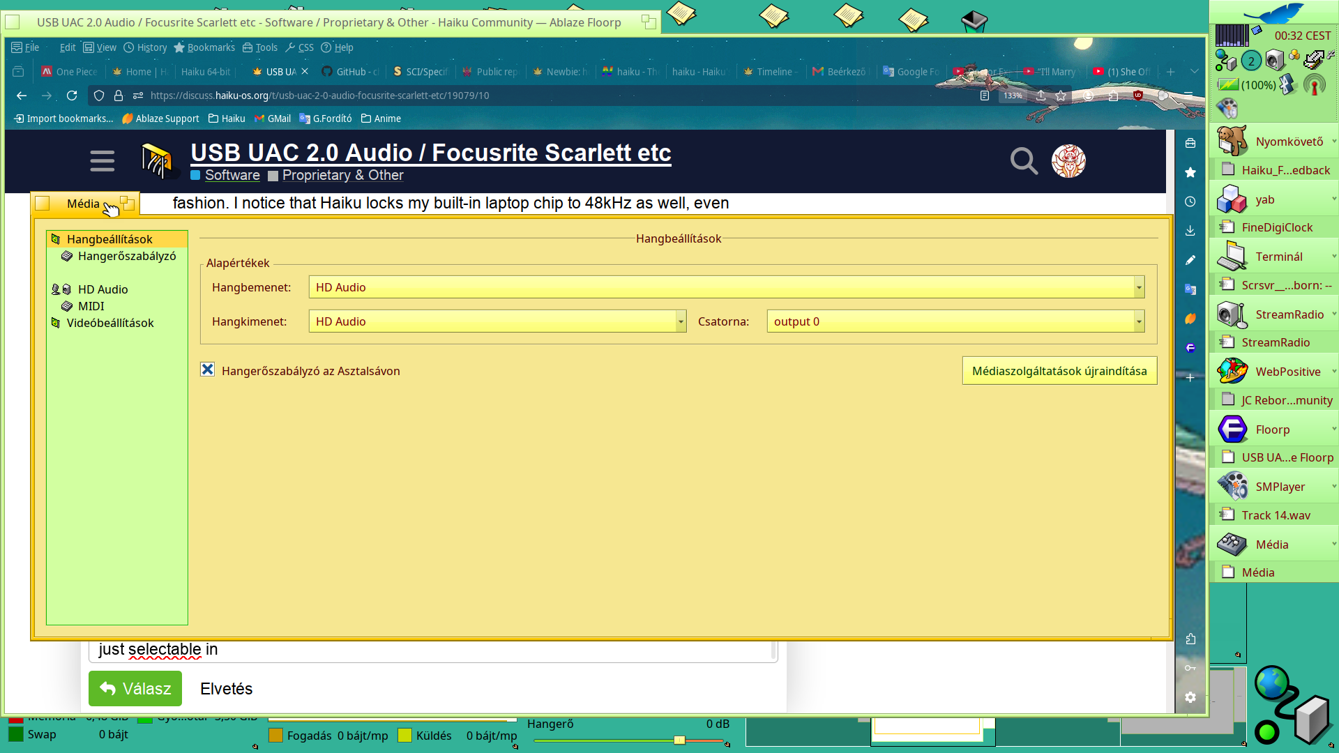

This patch was important to me as I wanted to make sure about something.

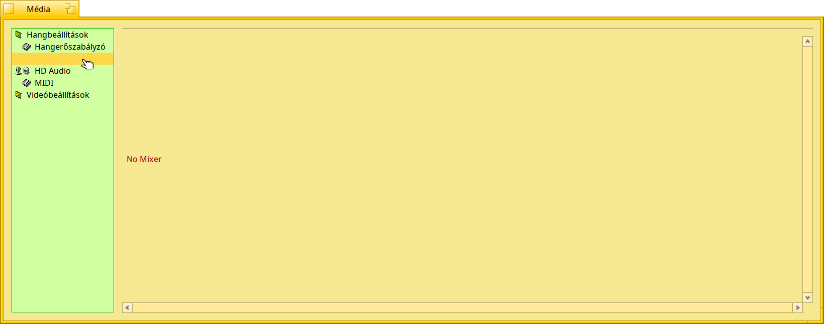

I have an empty Audio line on Media Preflet above HD Audio that is really empty and it contains only that - if I select - No mixer. on the setting page.
First - some days ago - I thought it is reserved for USB Audio, it just not shows anything as mo USB Audio device in Haiku. I found my Deblock USB stick Audio “card” and when I plugged in - it appeared under ‘HD Audio’ as ‘USB Audio’, meanwhile the empty stuff remained.
Does this exists for no audio available scenario ?.. then why ‘No mixer.’ written there on settings side ?
Anyway, interestingly other HD Audio resources related to HDMI / DP output channels were just selectable in Input and Output at device selection, they had not created entries under Audio settings.
It was confusing that it was not identifiable which HD Audio is which one - I mean it would some contain that HDMI/DP in its name and maybe the vendor name as well, like

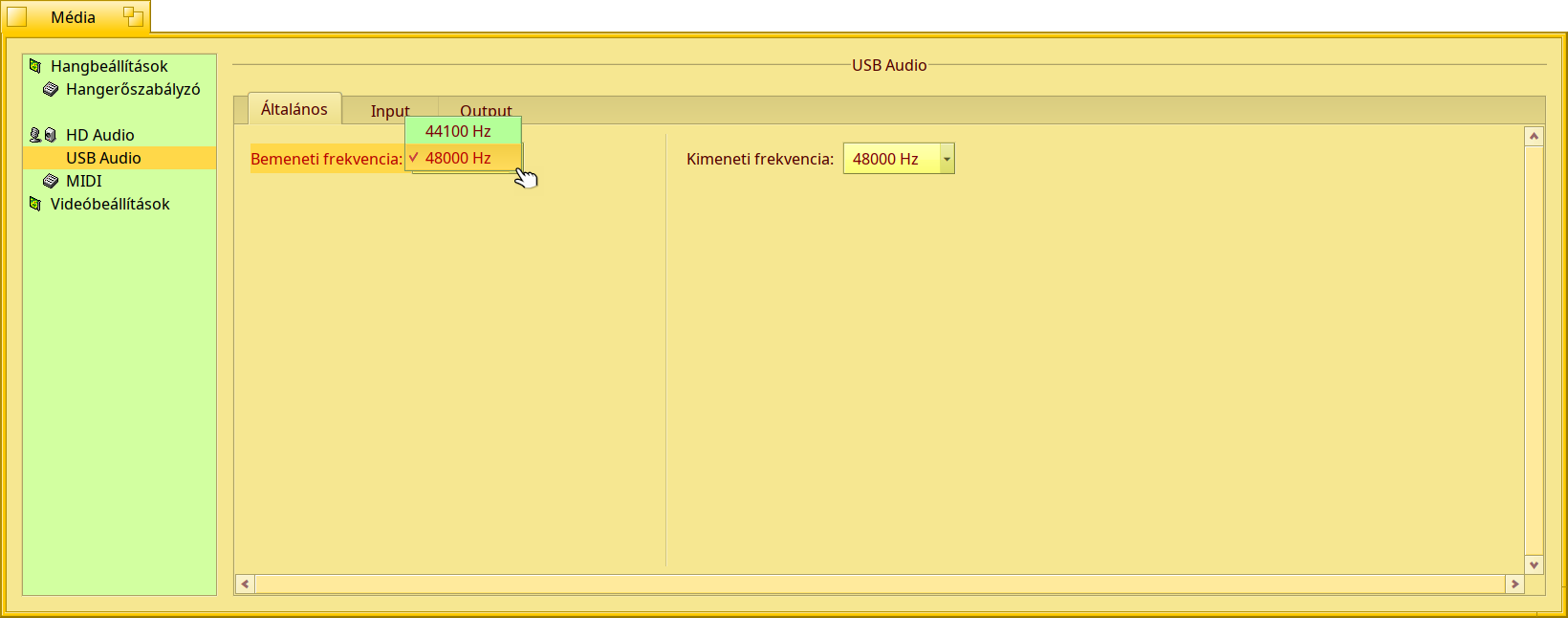

Otherwise the Deblock USB Audio sample rate was 48 kHz as well. This can Haiku USB Audio limitation in case of your device, or UAC implementation limitation. Im my case I was satisfied as it was just a simple stereo USB Audio stick, so I had not expected 5.1 and big sample rate. It was primarily to add 2 jacks for telco/meeting headphones, or if the device has no Audio on the mainboard I assume.
I got for work also, as we got headphones with separated jacks and not unified one, which was in the Thinkpad - and I still have it, as it had not claimed back when I left the firm for new businesses.
Here you are my screenshots - in Floorp the browser collapse when i try to upload.
HD Audio – Intel chipset
The empty entry – under Audio →
The fully featured Intel chipset HD Audio sample rates →
The DeBlock USB Audio device after the media services restart →
