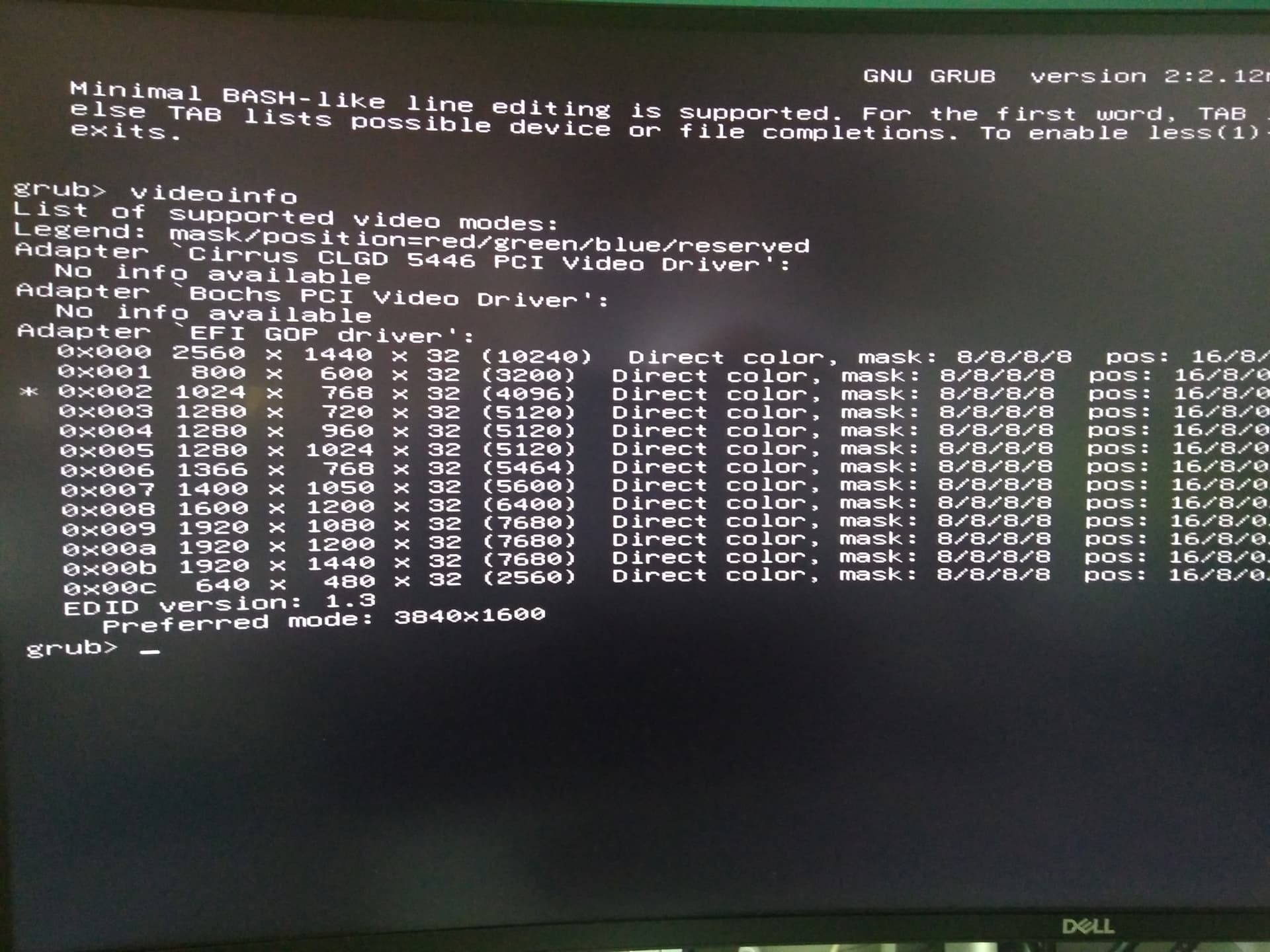

So I did more tests, checking in Grub the available video modes with this outcome:
So Grub screen (EFI GOP driver) is defaulted at 1024x768 and max resolution is 2560x1440, though preferred mode is 3840x1600.

So looks like something is going on here. Haiku sees the same modes (booting in BIOS, not UEFI) ,inside the Screen preferences, as Grub. Those modes are the same that appear in the Haiku bootloader.
Difference is that Haiku’s bootloader does not see the “preferred mode: 3840x1600”, though as soon as the system starts booting Kernel spits:

The “preferred mode” comes from your display through EDID. Haiku can read that, but if you use the VESA driver without BIOS patching, it can’t do anything with it, because that video mode is not provided by the VESA BIOS in your video card. With VESA, we can only pick from a fixed list of modes decided by the VESA BIOS and video card manufacturer.
You have two options:
  • Enable VESA BIOS patching in the kernel settings file if that works with your VESA BIOS. This patches (a RAM copy of) the BIOS, and allows to set any mode using the VESA driver as with other video drivers
  • Get a native driver working for your videocard, then Haiku will be fully in control ov the video timings.
I think I had already replied the same thing in january. The situation has not changed, the symptoms and the problem are stil lthe same.
BIOS patching is likely still not working for you, and there is still no native driver, since not much change have happened in either of these since then.
The linux framebuffer driver is not the same thing as our framebuffer driver. Ours will use the mode the efi bootloader has set and nothing else, setting it after system boot simply isn’t possible when using the efi driver only.
Linux in this instance has something that can do modeseting for your card, Haiku does not.
