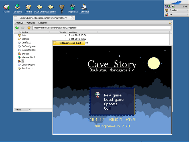

Btw, it will compile succesfully in Haiku Rc1Beta (almost ready image version), and if following the maker instructions for running it, you get the game working.(Nice looking btw).

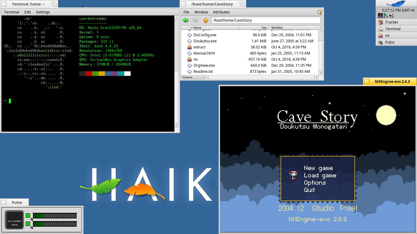

After getting some help from others, I’ve now been able to get NXEngine-evo up and running on x86_64:
The next things to do are to try the same on x86_gcc2 and x86 and see if it works before making a HaikuPorts recipe.
Update: Confirmed working on x86
Update 2: Doesn’t build on x86_gcc2 even when using the same steps for the other previously working architectures, so the program will be for x86 and x86_64 only.
Does it trigger an assertion with the issue #6400 after quiting the engine (or a debugger popup)?
It did if run in console in my version, which may have something to do with the iso version, or may happen on other archs too.
