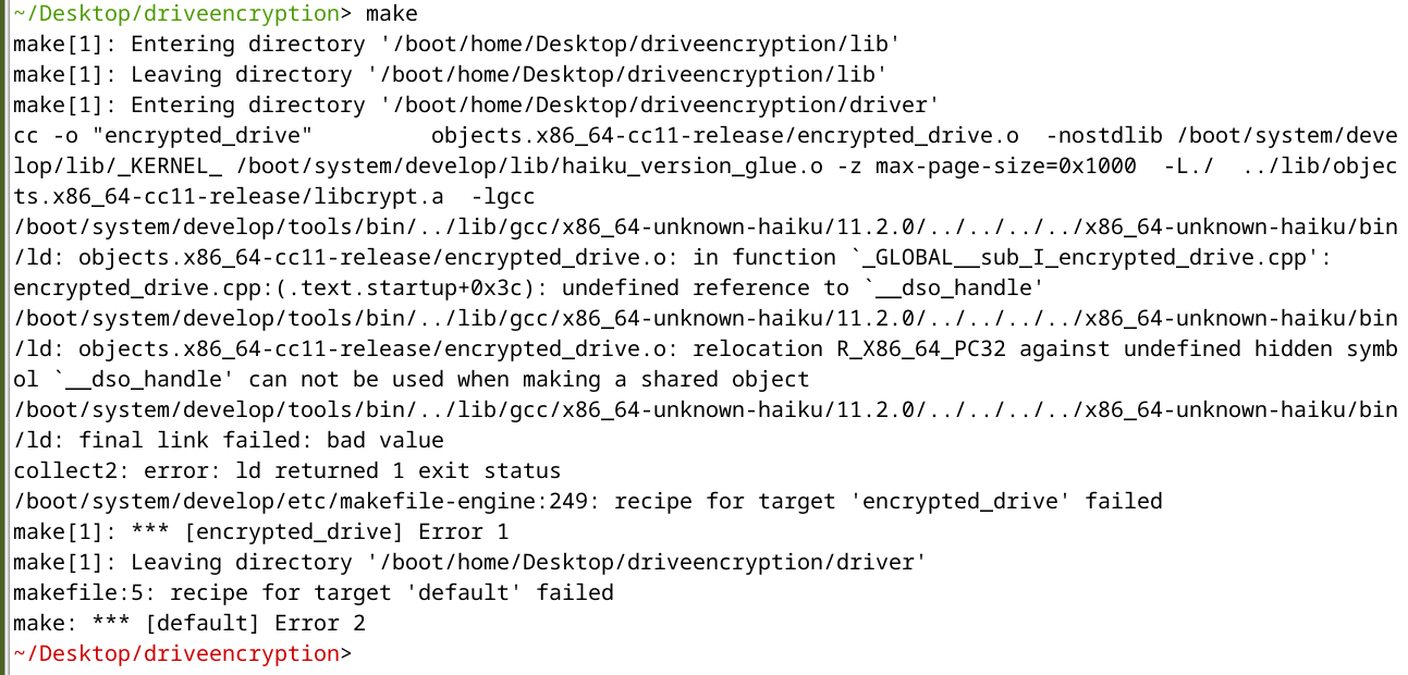

The __dso_handle error is caused by -nostdlib, a flag which seems to be implicitly set when building drivers. I don’t know what to try from here. Any ideas?
