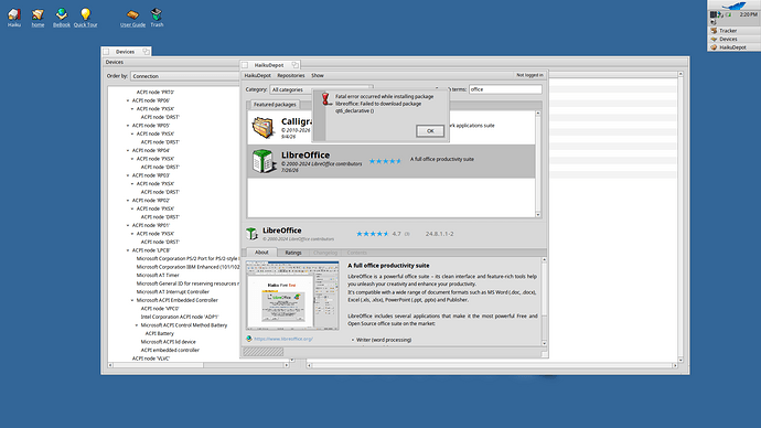

Tried to install LibreOffice in beta 6
Don’t understand the error message. Server down or maybe the app is too big to install when running live USB?
Too big for live USB.
There’s a ticket to catch this here. I’ll try to get this implemented after the SSO migration.

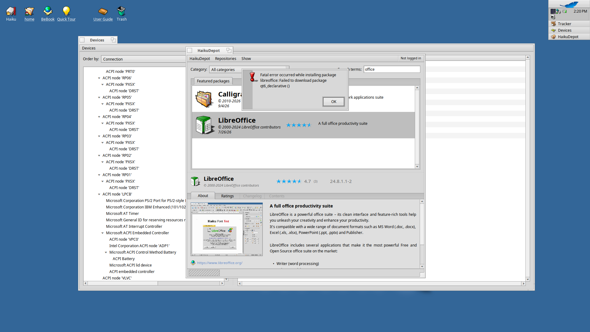

screenshot811
Yep.
But HaikuPort and under the package kit should do better job at returning a more sensible error details.
EDIT: there is someone working on it right now.
Yes. that’s it.
Hi there; letting you know this should be sorted in the nightly now;
  • will warn you up-front quickly if the disk is obviously insufficient to install the package based on the download size.
  • if you attempt to install and it can’t then it should give you better diagnostic error message.
