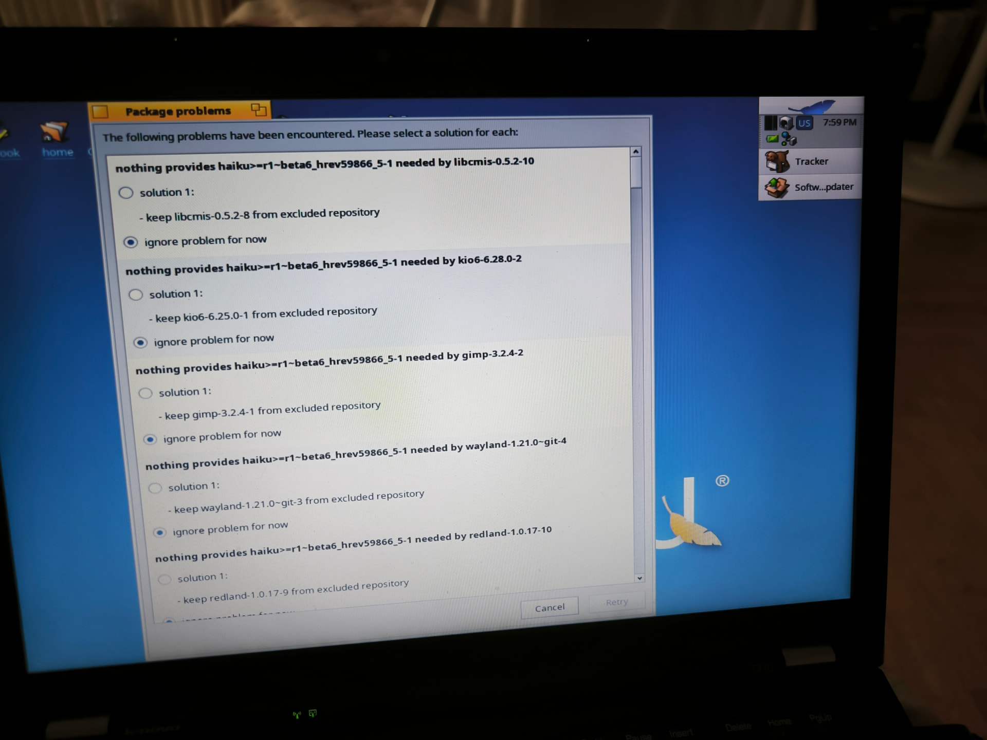

My Haiku system is installed on a lenovo.
Haiku is the only operating system on the disk.
There is no intenet connection problem.
My optical fiber provider is very fast.
It is only a Haiku problem.
When I try to update, either via the terminal or the haiku updater,
an innumerable list of application repository problems appears.
This problem is new,
I’ve been using Haiku for at least two years,
but updates used to be flawless and extremely quick.
Looking at your screen, it seems like you’re on beta 5, right?
The dev team’s gearing up to release beta 6 somewhere around this month and they are updating some stuff on the HaikuPorts repository. From what I’ve read from the tickets it seems they don’t have the insfrastructure to have two separate repositories, so you get broken updates until everything’s finished.
The way I see it you could either switch to the nightly builds or wait for the beta 6 release.
I do have the same problem, even after a fresh install
We don’t have the ressources at the moment to maintain a nightly and a beta haikuports branch simultaniously. That means when we release a new beta we need to upgrade severall things at once, say we have library A, in beta5 this was version 1.0
For beta6 with newer software we now want to move this to version 2.0, now haikuports has to rebuild all software based on Library A, and this causes the disruption you see.
Unfortunately there is no easy resolution apart from well waiting untill we have finished this process.. in the future maybe haikuports can get branches so we can avoid this.
In your case however, simply use the resolution method of “keep X from excluded repository” or use pkgman update instead of SoftwareUpdater, it is less aggressive about removing packages that can not be obtained at the moment.
