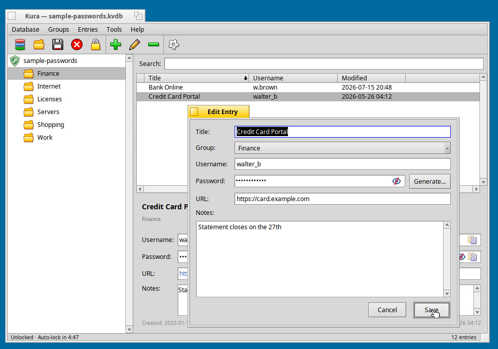

Howdy,
I’ve been quietly working on something I’d like to start sharing: Kura, a password manager built natively for Haiku.
THIS SOFTWARE WAS CREATED USING AI.
The name comes from 蔵 (kura), the traditional Japanese storehouse — the small, thick-walled building where a household keeps its valuables safe. That’s the idea in a nutshell: somewhere to lock your credentials away.
Kura is written from the ground up in C++ against the Be API. No ports, no foreign toolkits — just a native app that tries to feel at home on Haiku, with a proper three-pane layout, toolbar, and drag-and-drop.
What it does so far:
  • Keeps logins in a single encrypted database — AES-256-GCM, with the key derived from a master password via PBKDF2
  • Organizes entries into a tree of groups that can be dragged around to re-parent and reorder

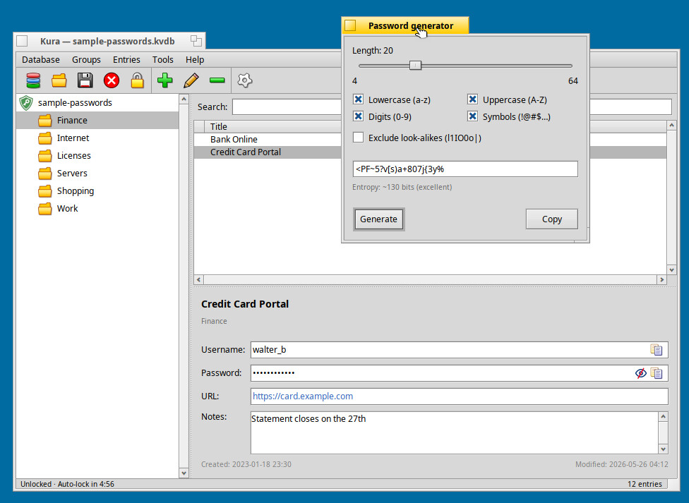

  • Generates strong passwords
  • Live search as you type

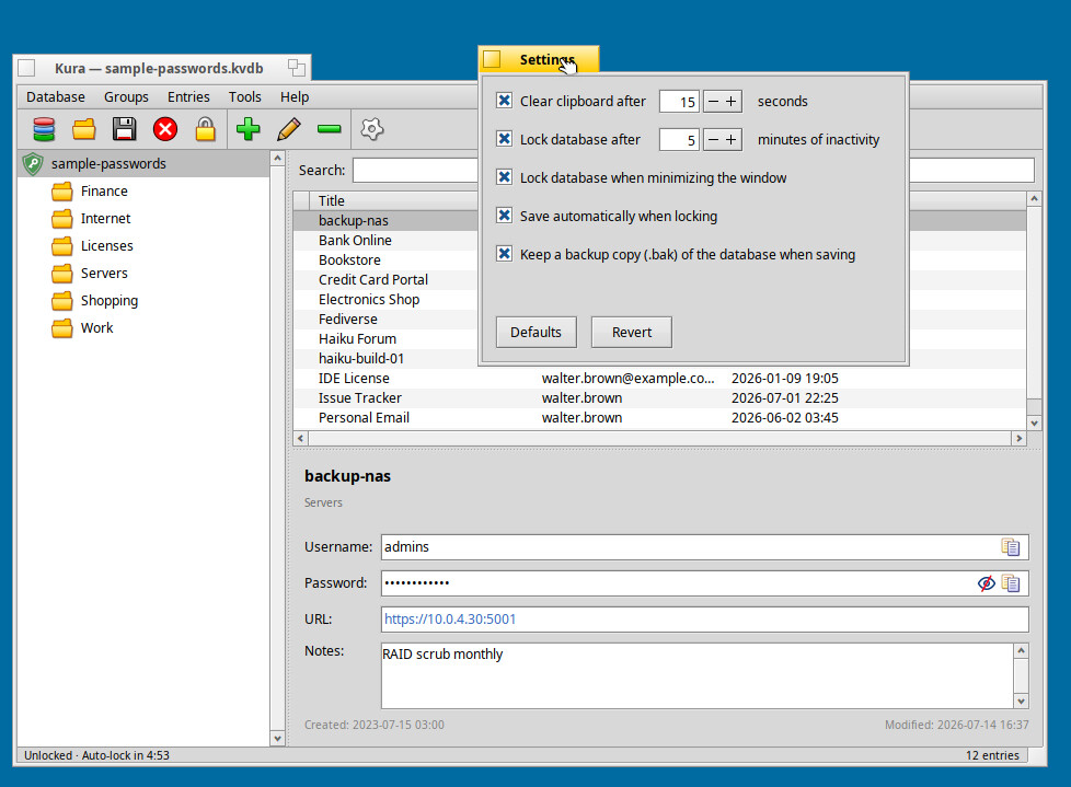

  • Auto-locks when idle or minimized, and clears copied passwords from the clipboard after a set delay
  • Imports from KeePass/KeePassXC CSV exports
Kura is still alpha (0.3), so no release just yet. But I wanted to introduce it here, gauge interest, and hear which features matter most to you. So, if you are adventurous and would like to try it out, you can get the sources from Github and compile it yourself. It is being developed in Haiku nightly 64-bit (not tested on 32-bit).
To my knowledge, there is no native password manager for Haiku, so I’m hoping Kura can fill this gap. Feedback and ideas very welcome.
Cheers!
