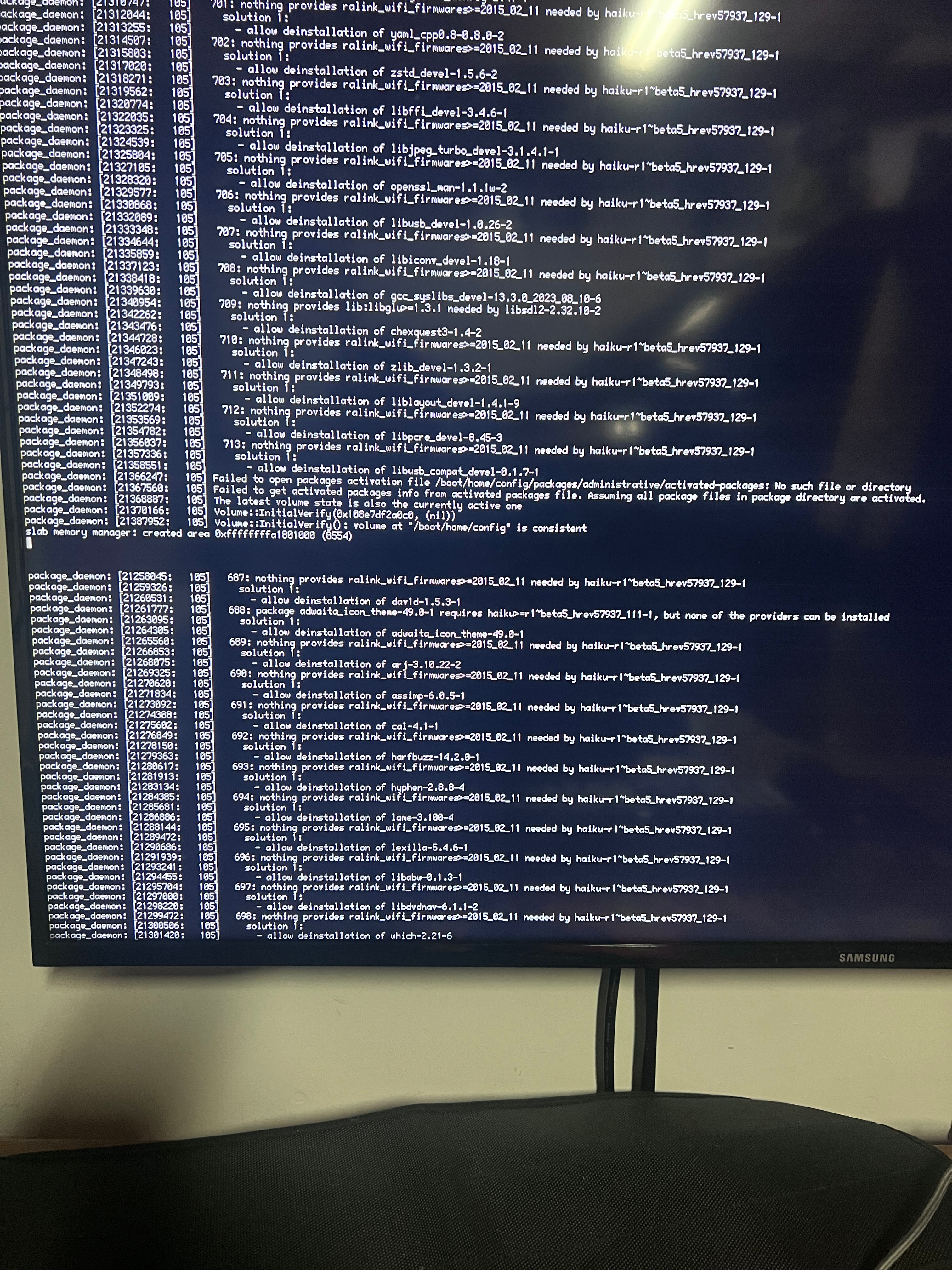

I seem to have a package issue. “nothing provides ralink_wifi_firmwares>2015_02_11 needed by haiku-r1~beta5_hrev57937_129-1” About 700 times and suggests the deinstallation of every package.
Failed to open packages activation file.

Try running Installer and just do a fresh install of the core system files, which keeps your home directory intact.
I cleaned up the packages.
rm /boot/system/packages/administrative/transactions*
Then pkgman full-sync
Deleted the file activated-packages
Rebooted and all working. It was weird when I went to uninstall LibreFox and it wanted to remove a ton of packages. Trying to install packages from HaikuDepot would show error messages about packages being installed already.
