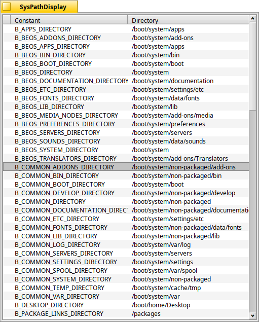

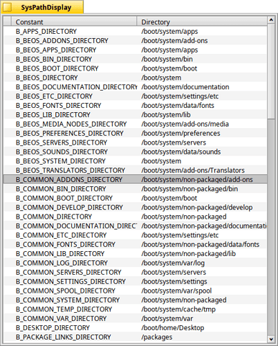

System directories viewer
Decided I needed a quick way to remind myself of these system constants that can be accessed with the finddir command.
So I wrote one in yab. It doesn’t just display a static list. If the devs change a system constant, it will be reflected in this app as well. Single-clicking an item copies the constant to the clipboard. Double-clicking it opens the directory in Tracker.
