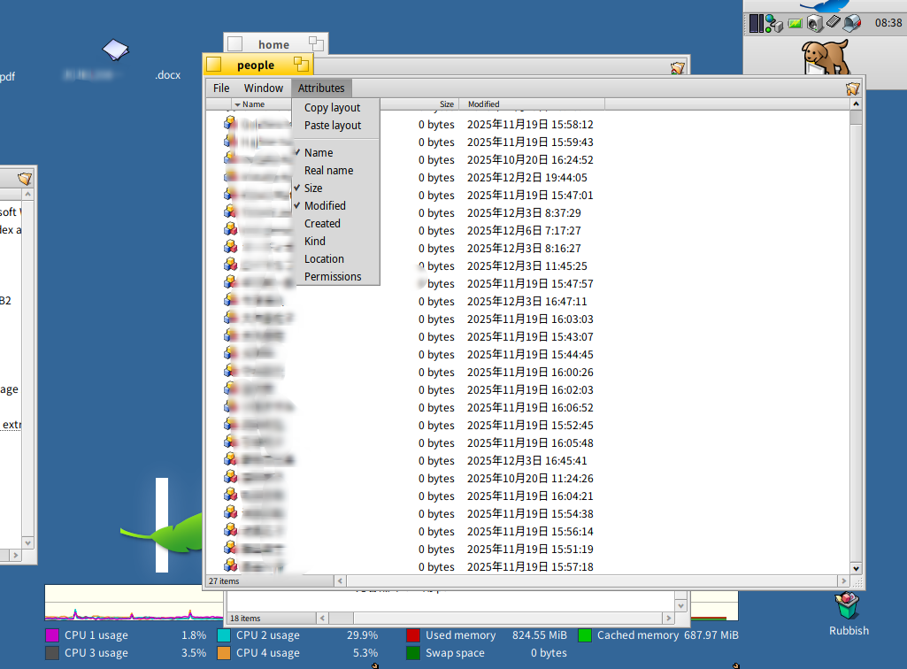

Hi, when I open up my people folder on Tracker, it used to show the people specific attributes like phone numbers and so on, but for some reason it doesn’t any more. Any way to get it back to normal? (I’m using the hrev57937 +129 version on a Thinkpad x230). Thank you.
Your "People"s files aren’t showing the correct icon either, instead they looking like “Generic Be application executable” for some reason? (you may confirm what type they have by either enabling the “Kind” column, or requesting “Get info” on those files.

Thanks for the suggestion. This operation did nothing as far as I can see. Same icon with the blue, red, and yellow cubes.
I tried the shift+right click > force identify on a couple of my Person files. It changed their icons to the two white sheets of paper icon (same as for “c++ header” and “c++ source”).
Interesting thing is that even though the icons are wrong, and the right click “open with” only gives me the choices “Disk Probe”, “FileTypes” and “ZipOMatic”, double clicking on the file brings up the default People app all the same.

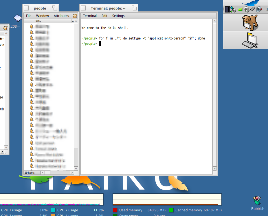

3.- Restored the proper type via settype (as mimeset is the CLI equivalent to identify, AFAICT, not accepting a given type):
for f in ./Peoples-Files/*; do settype -t “application/x-person” “$f”; done
This last one worked fine. @chaplintokyo, I’d suggest you trying that last line (adjust the ./Peoples-Files/* path accordingly to your setup, of course).
settype -t “application/x-person” some_path/* should also work (make sure you only have Person files under that some_path folder though!.
