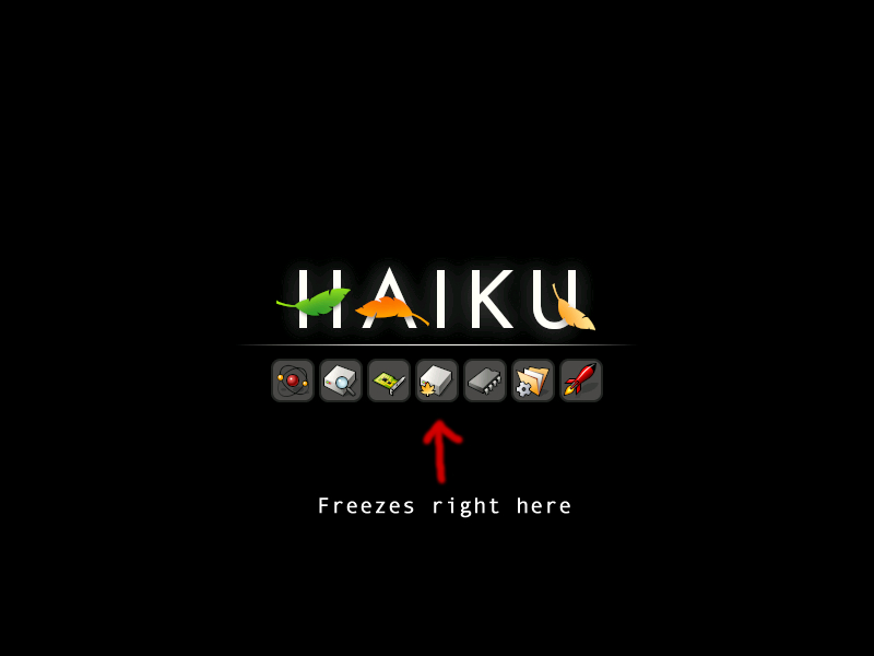

I’m having trouble with installing Alpha 4 on my Thinkpad X40. I am eager to use the WPA wireless so that I can actually test it out in daily use. I try booting from the CD, and it freezes when you see the Haiku logo. It only gets to the HD icon.
I burned an ISO, tested it on my desktop, works fine. But, I don’t have wireless in my Desktop. I tried to boot the CD on my Thinkpad, which has previously worked with Haiku Alpha r2 and r3. I’ve previously booted with USB CD-ROM and USB sticks. So it is not a problem with the media. How do I get the error codes to know what is not working.

Without you telling where it stops and showing a screenshot/photo of it it is not possible to guess.

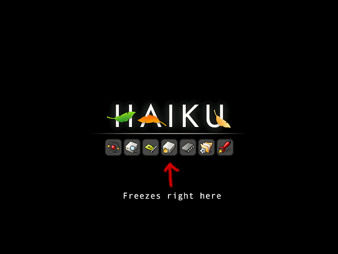

I first tried the fail safe video, thinking it might not correctly identify my video card. But that still froze the install (see picture below). Then I booted safe mode, disable IDE DMA seemed to do the trick. I’ll post again and give an update.
EDIT: Only wants to boot with disabled IDE DMA, but this makes it run slow. Any ideas or am stuck with this because I don’t have a working Hard Drive?
