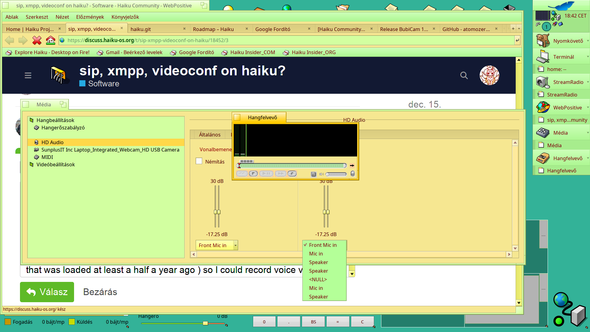

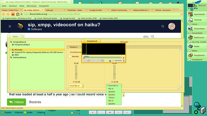

Interestingly since I switched
from Dell Precision M6700 to Precision M6800
I have working audio input devices of Intel HD Audio
(64bit nightly )
( and maybe R1B5 too but that was just loaded at least a half a year ago )
so I could record sound and voice via Soundrecorder using built-in front mics.
Template : sound_clip__192_khz__PCM_WAV_358MB_file(ufile.io)
sorry for vent noise, it’s moderate, but seems should grease it :slight_smile:

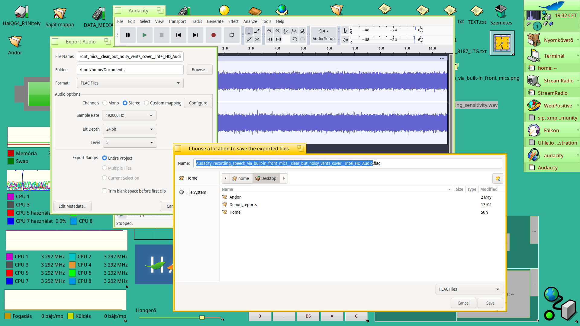

And of course I tried out Audacity too, but as that is alpha version on Haiku,
it is sometimes not so reliable as it was on Win7 for me.
I had not found exported file actually :smiley:
I had run noise reduction on it, and it had not enabled to export again - so finally I had quit.
